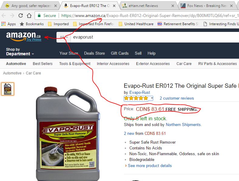

Does anyone know why when you post a link to an Amazon page, it always defaults the the Amazon Canada web site with the prices in Canadian Dollars, and everything is marked up to the horrific prices Canadians pay for everything? Does it have something to do with the fact that the American Amazon site uses cookies to know when I have logged into it and goes to my account?
For example this gallon of Evaporust is $17.99 here with free Prime shipping. What say some of you really really smart internet guys?
That does not happen with me.
Got no idea why it would happen with you, Sorry.

Well, I am from Missouri the "show me" state. Here is an Amazon web site that when I go to it is the American web site, in fact MY web site with my self logged in and showing the price in American dollars.
Amazon.com: Evapo-Rust ER12 The Original Super Safe Rust Remover - 1 Gallon: Automotive
Now if you would be so kind to post the exact same product (evaporust) and then go back and click on it and see what happens. When I click on my own posted site it takes me to Amazon Canada Not Amazon America. Lets see what yours does..
Works fine for me.
