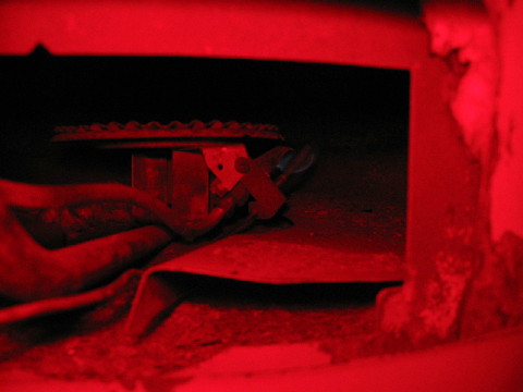

   / Any heating/ac guys out there!!!!
pilot...look close and u can c the whole flame /forums/images/graemlins/confused.gif

That second pic is the regulator. The vent is right in front...looks clean...Maybe time to do an adjustment. Whats the level of licquid in the tank. Are you just about empty? With this mornings cold, the pressure could be down.
