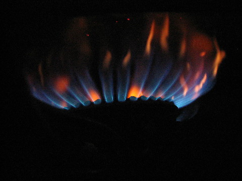

and here is a pic with the pilot lit and the burner goin the problem is when the burner goes out the pilot goes out too!!!
/forums/images/graemlins/confused.gif /forums/images/graemlins/confused.gifif u look close u can c the pilot on bottom right of the burner flame??? it really doesnt look very big but is a real healthy pilot flame!!

Pilot stays on on its own. Means thermocouple is okay, pilot gets fuel. Have you checked pilot tip for carbon?
When burner kicks on does pilot size decrease?
Are there any air adjustments? Flame picture shows a little too much orange.
Can you vary temperature settings and see if anything changes?
Have you gently tapped all control units?
Are there any kinks in fuel supply lines to the water heater.
Is the thermocouple seeing too much of the main burner flame?
Does this occur just as you are getting sudds up and relaxed in the shower??

thank u EGON!!!!and here we go>>>answers to everyone of yer ???'s
1..pilot size decrs: dont know but will ck!!
2..dont no bout air adj's
3.could try temp adj's but why
4.havnt tapped but will..
5.absolutely no kinks!!!
6..thermo couple is kinda set wher it always has ..never changed anything...dont no if i could bend it down some??
77only happens when the water is hot and burner kiks off!!!
/forums/images/graemlins/confused.gif /forums/images/graemlins/confused.gif /forums/images/graemlins/confused.gif

Makes me think the air velocity at the pilot is such that it's flame gets blown out when the main flame goes off.

please talk more on air velocity and never had a problem b4..this past winter and how to change air velocity and what might have changed??? as havent changed any thing???what makes air velocity change...exhaust pipes..at top of tank????inlet of amount of air coming atlighting area 4 the pilot???
i really can't c anything that has changed!!!aaaarrrrgggghhhh
!!!!!!!!!!!!!!!!!!!!this is killin me ..i think it has to do with the "pac " controls the gas/thermo coupler!!

There should be a little slide thingy that can vary the air to the pilot. Maybe one for the air to the main burner. The picture you posted showed to much yellow indicating not enough air for proper combustion or perhaps some plugged nozzles on the main burner.
Hey; I'm just quessin. Mayhaps move the thermo coupler around a bit or take it out of the clip and hold it in the pilot flame by hand to find the right position.
