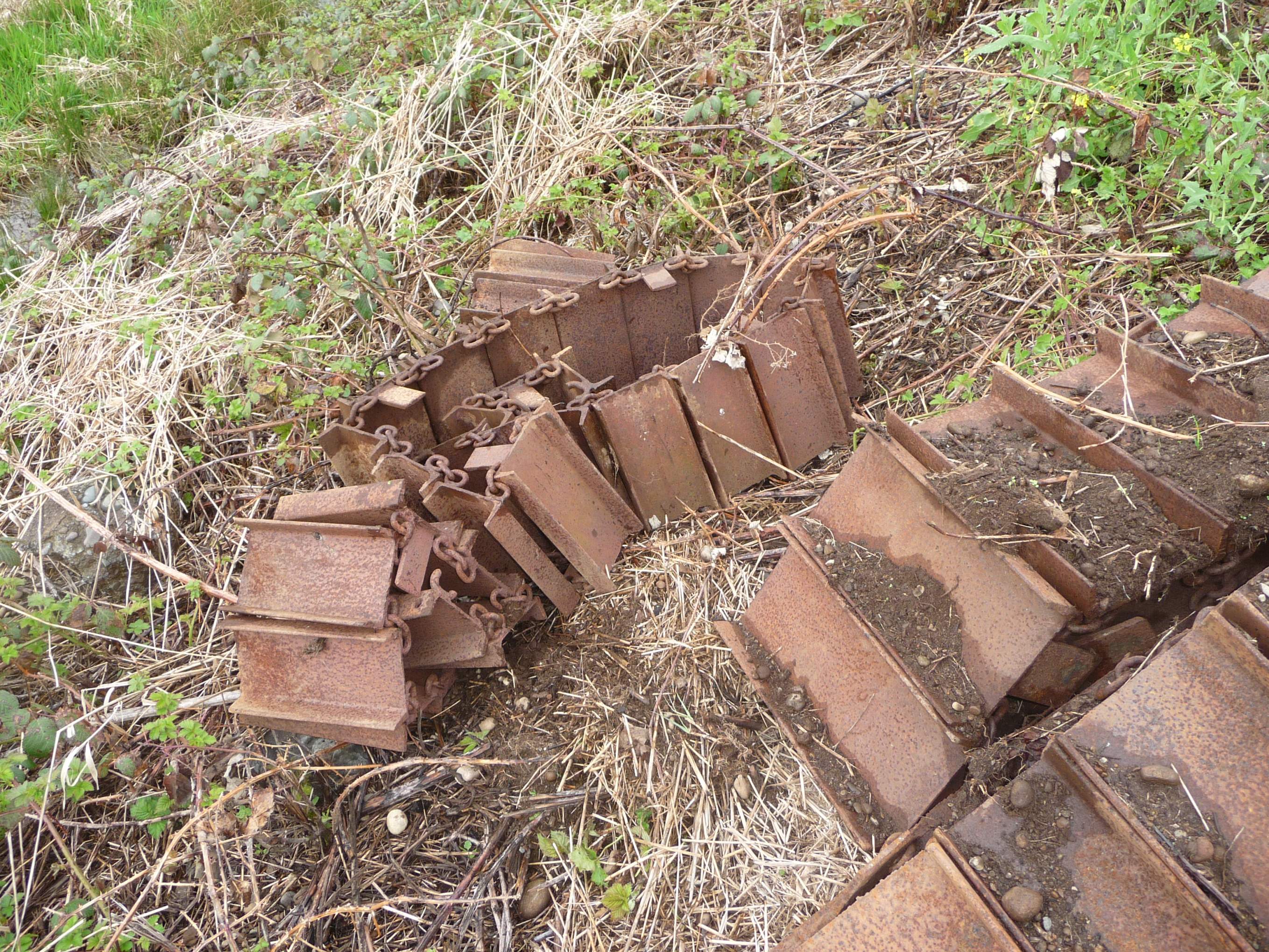

I built a set of tracks for my JD. They are not full length like a dozer but go around each tire. I used channel iron for pads. I welded chain cut into 3 links each to weld to each pad creating a hinge. I put 3X3/8 in flat bar on the sides to keep them on the tire. Used 8in in back and 6in in front. Gave a coupld of inches of ground clearance and it drives just like it did as normal except that it has higher floatation and will go where I point it.
I posted this a while back, wish I had a pic of them on the rig. Here is a pic for an idea. Next post
