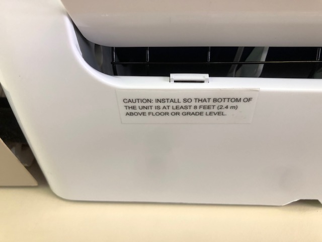

This decal as shown is on the Lennox mini split indoor unit. There is nothing in the sales literature or installation manual relative to this. It is hard to mount the unit with its bottom at least eight feet above the floor on an eight foot wall.
I suspect that it simply gives Lennox and "out" when users complain about the wide temperature swings.
It's not lennox looking for an out, you will find this with most cheap mini split systems in their instuction manual (per mounting height). Hard to believe, but if a job has a permit pulled, some inspectors will actually read the instruction manual.
Most rooms in NC are 8' high from floor to ceiling. That indoor unit wouldn't sell to well in NC.
If the "warning lable" is on the unit, it's in the isntructional manual. The bigger question is when the indoor unit was installed and the warning lable is on the unit and the guy is looking at while installing it, why didn't anyone from the installing dealer ask questions?
By the way, the manufacturer can have something in writing if the inspections department is actually asking about it. Happens all the time with hard nosed inspectors.
Once you go under 5'-6' with a wall mount unit mini split, you get temperature stratification issues that can get you complaints from the end user that they need to be made aware of before hand.
Tell your dealer to ditch the Lennox off brand private lable mini split. He should thank you for it.
