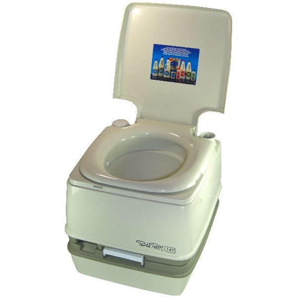

Or a porta potti: Click This Link for pictures.

I don't think a toilet is feasible. And no ports jon and definitely no compact portable toilet. I still want a sink. I was thinking would it be possible to drill about 2" hole in the concrete. Then take a 3/4 piece if black pipe and put a cap on both ends . Then drive it through the hole past the bottom of the footer. Now uncap both ends and run a piece of 1/2 PVC through it and glue a 90 degree fitting on the bottom.
