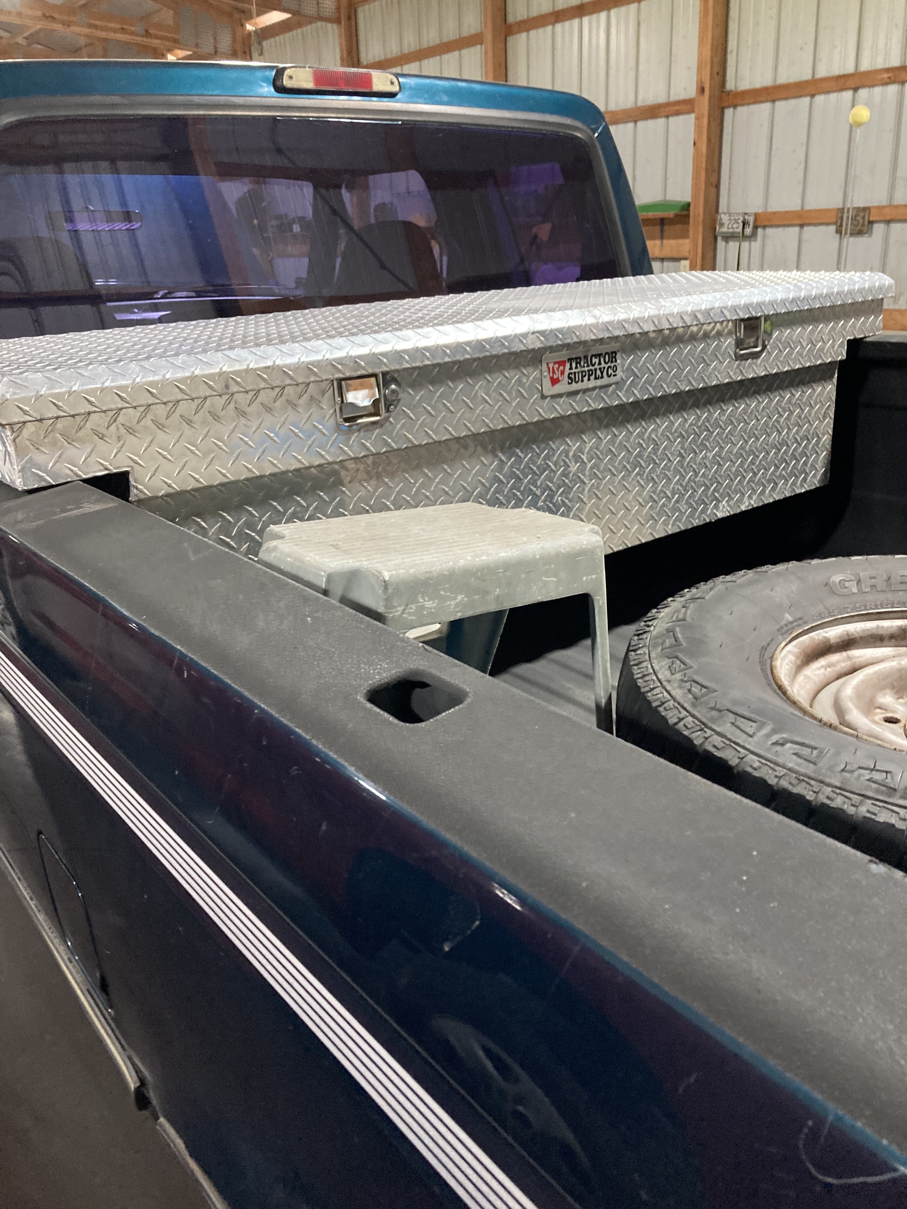

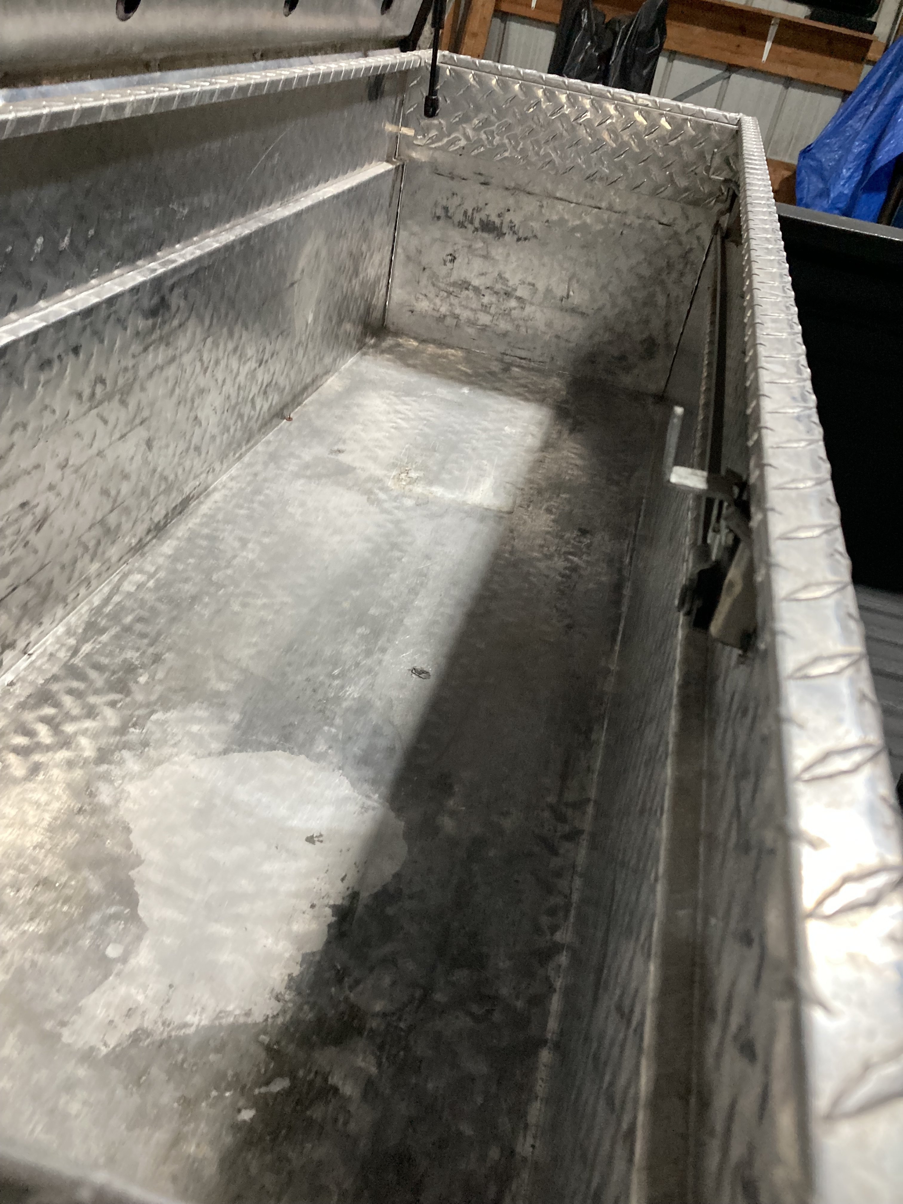

I bought a used truck bed toolbox because I could use it to secure chains, binders, tools and such when I go to auctions. I've never owned one before. It's great but is just a big box with no sliding shelf or anything to make it more useful. As it
There's a lip I am thinking of building a sliding shelf so I can store small tools and yet slide it out of the way but that's all I can figure out so far. Any ideas helpful.
View attachment 2032572 View attachment 2032571

You have to insert the sliding tray in the middle of the box. That way, there's enough flex in it to insert the tray. I had a box like that and used the mounting bolt to hold a bent strap hinge to hold tray from sliding. On the bottom of the sliding tray, you may want to add some plastic "silders" to help it slide.

If I understand correctly, a fully completed box won't fit in due to clearance issues.
Cut the plywood to the width. Drop it in place. Make a narrower open bottom "box" to a width that will fit. Secure it to the plywood with Kreg screws or angle brackets. I would put a few dividers in the sliding box to keep things organized.
Doug in SW IA
That ws my original plan. But the minimum lip width that things slide on is greater than the maximum width of the opening of the box. I can try to put the bottom in by itself but then can't lay it flat because the edges of the board being turn flat exceed the maximum with of the box.
I know I have to make the box narrower to fit in and could then use angle iron to make the box slide.
