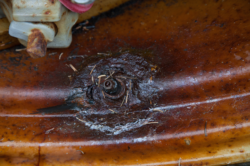

Update on my MF-85...got all the fluids changed over before the snow arrived. Tractor has been outside for probably over 10yrs and not used for last 2 for sure. Amazed that she starts on the first crank almost every time after I put a good battery in and tightened a few plugs! Engine seems to run pretty good.
Anyway my most pressing issue is a rusted air valve on one of the rear tires. I'd like to replace both rears but not sure where to start.
Here's a shot of the valve...is there anyway to fix this kind of damage? I'm assuming it's due to the calcium chloride likely in the tire...

Can anyone help with advice on how to fix my rusted rim valve?
