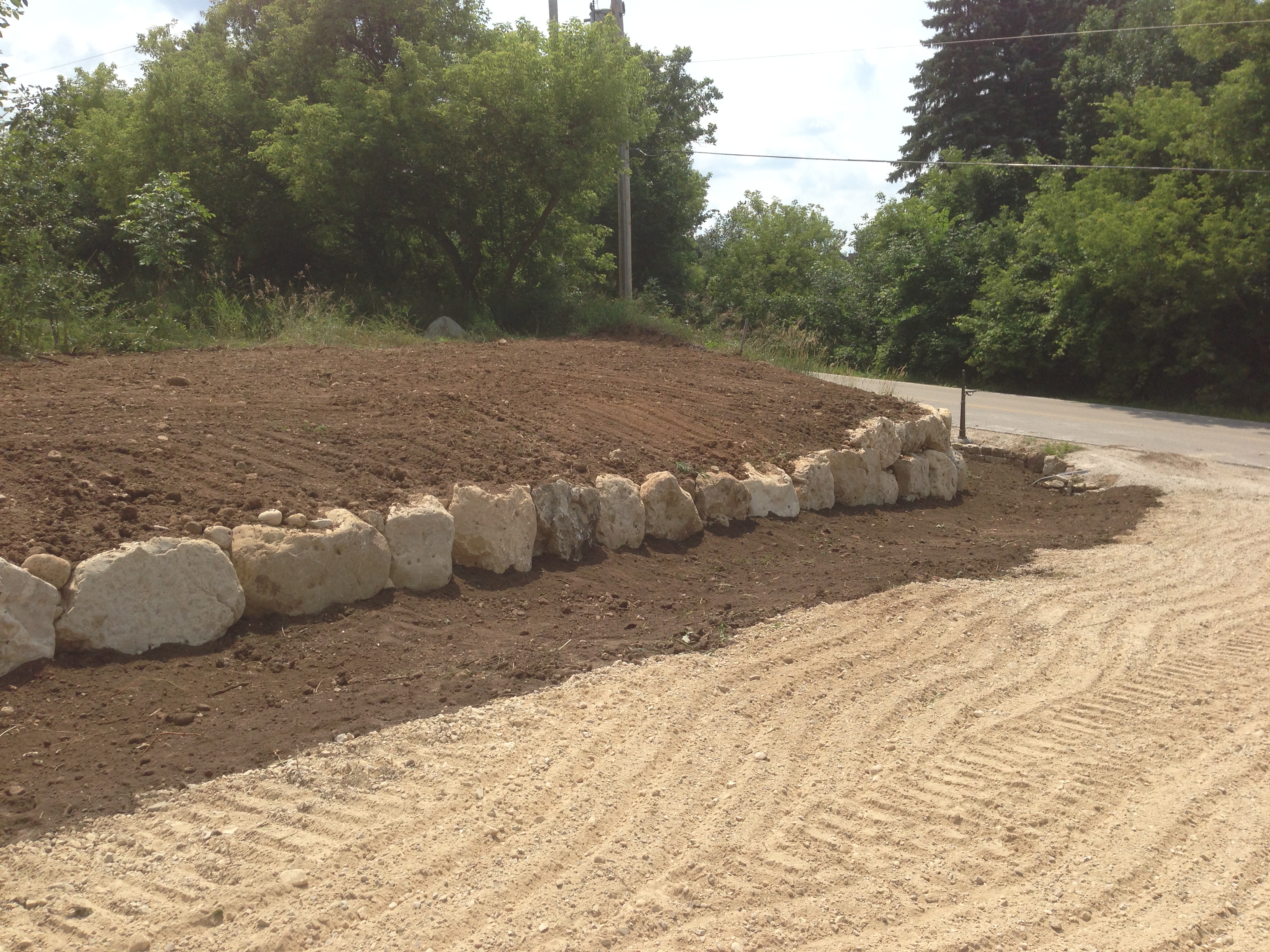

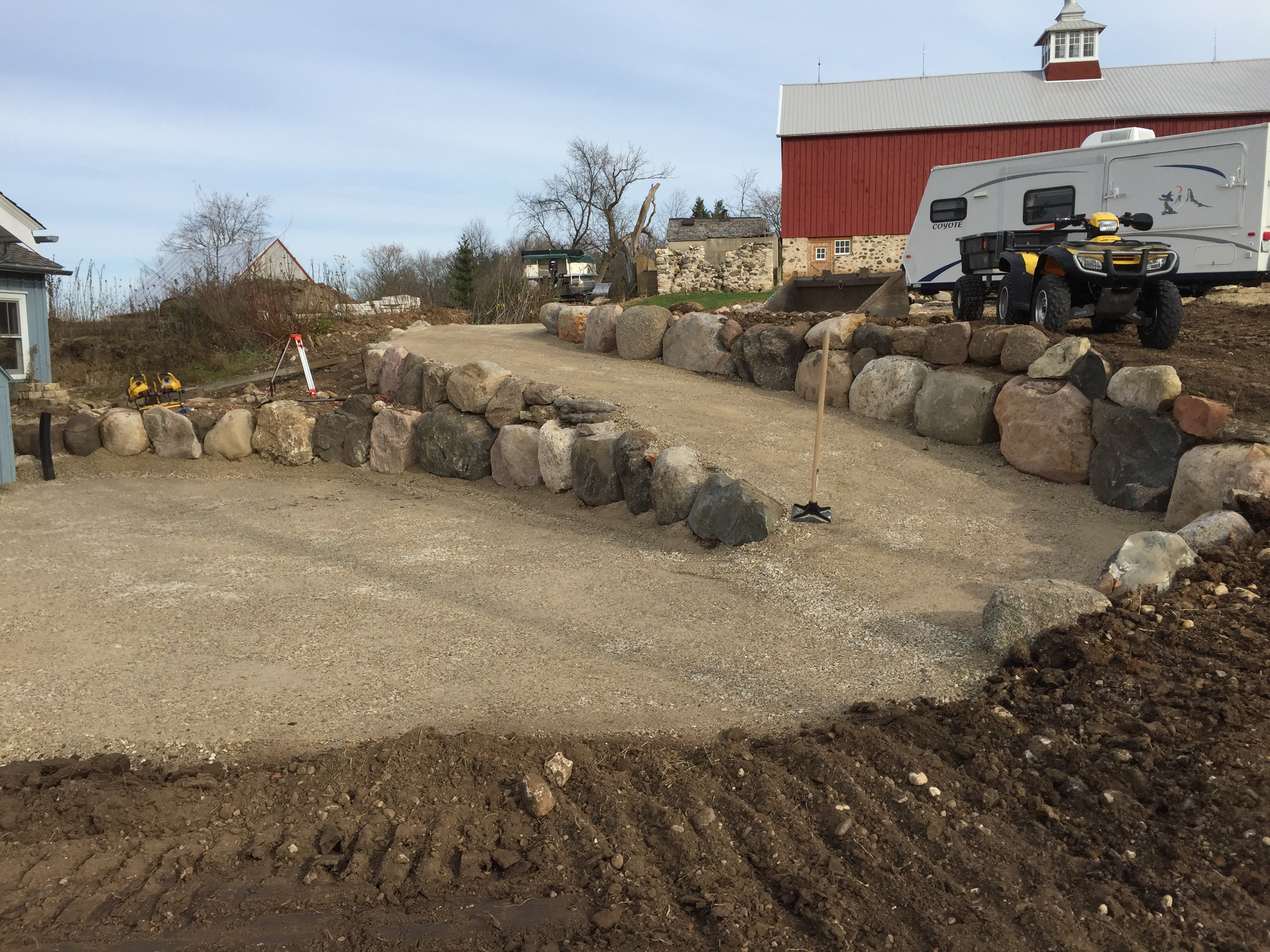

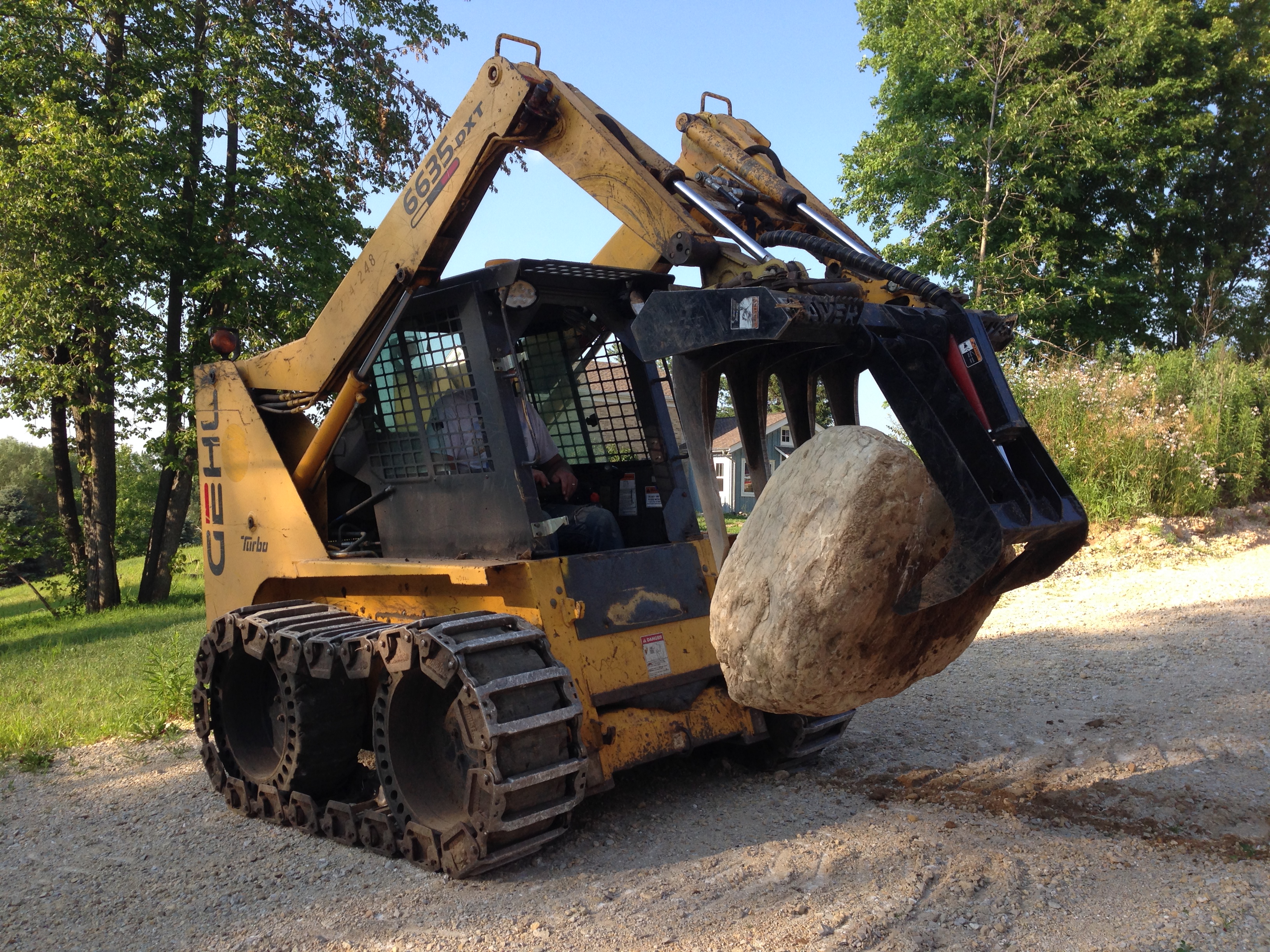

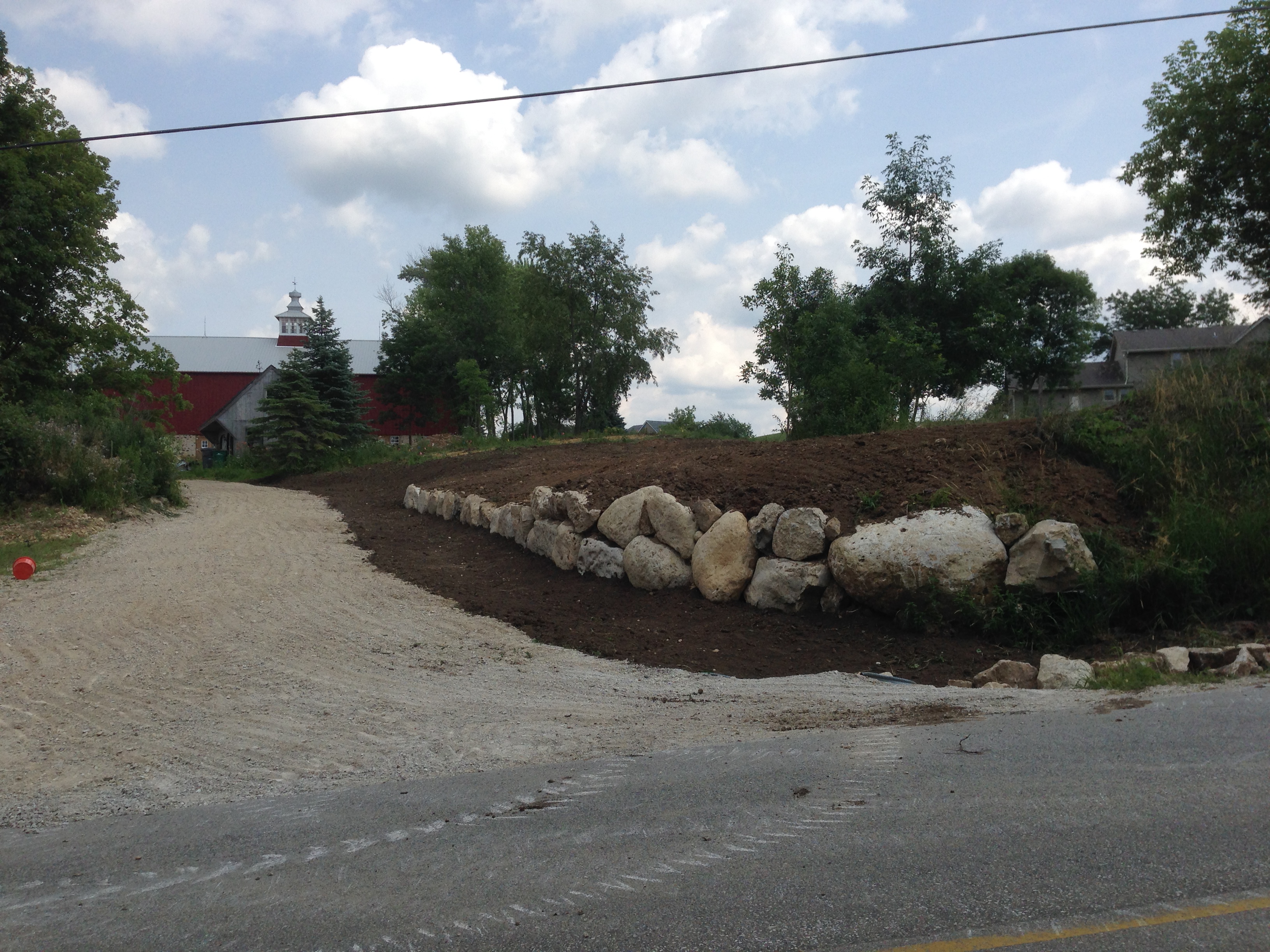

I'm happy your fabricated grapple is working for you. I would have guess that it was too light. I've been stacking some boulders for rock walls at my place using a Faver grapple. It's seen a ton of abuse and is holding up surprisingly well. One of the big advantages is that it's narrow enough to not hit the adjoining rock and it's strong enough to allow it to rotate vertically without the rock slipping out. The ability to rotate and precisely place the rock is a requirement to building a good looking rock wall.

Cord, that last pic is a footpath? Looks awesome - but how do you plow snow off it? And what's the travel surface made of?
Your rounded boulders are nothing like ours in NE and probably take more finesse in the placement. Nice work! Jim
   / Any odds on these Rock Tongs working? #35
Yes, it's the path to the front door. My lot is rather steep and the travel trailer is parked on a round-a-bout that we built. Unfortunately, to provide a level parking area we needed a retaining wall between the parking area and the front door. Wife was thinking steps, but those are really tough to clear in the winter. By using a ramp we can simply blow or shovel the snow off. Besides, a ramp is way safer than steps in winter. I used 3/4" TB (road gravel) for the surface. It was affordable and fits the farm theme. As for finesses in setting the rocks, I've seen some beautifully fitted dry stack walls on the east coast so there is something to be said for old world masonry skills. None of these rocks were fitted. I'd just pick one out of the pile that looked about right and then used the machine to rotate it so the faces aligned and the edges fit reasonably well together.
