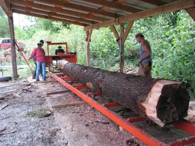

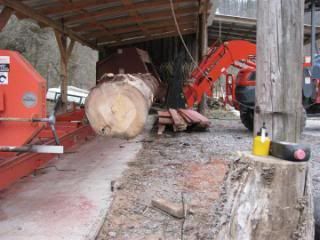

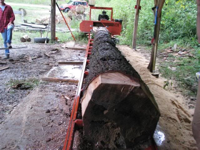

Step, I have a Woodmized LT15 Bandmill which I used to build my house, 1/3 of a hay barn(so far), a mill shed and a few other projects. It has paid for itself many times over. I started out with a CSM(chainsaw mill) and quickly realized that a band is really much more practical on large projects. First you need to decide if you want a all manual mill or one with hydraulics. My LT15 can do everything a full hyd mill can do, but it requires labor and time. Someday I will trade up to the LT35 full hyd mill.....but new that's about $20K....I only have $6K tied up in the LT15. As mentioned above go here to read learn & ask questions about band mills:
http://www.forestryforum.com/board/index.php?board=7.0
Here are some pics of my LT15 millng my 5x10 rafters out of 26' Hemlock that was 25" in dameter:
loadind a smaller pine log for the barn build:
millng:
