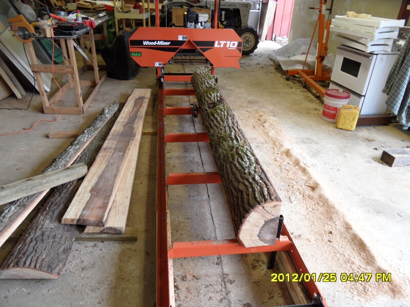

I started out with a CSM and processed a few trees, but the graduation to a BSM was well worth it. There is a wide range of "home type band saw mills". From DIY w/ scrap to a 50 plus HP for over $50K.
When I was buying I viewed the "home type classes" as:
DIY - and I'd never get it done
Harbor Freight - $1,600 w/ coupons but they may not be selling anymore
Entry level manual about 10HP - now about $4,000 - like the Woodmizer LT10
1st step up - about 15HP like the Woodmizer LT15 about $7K
"trailered" mills - $10K and up out of my price range so I didn't investigate heavily.
I went with the LT10 because it does what I need. Almost all my trees are < 24" and I could easily justify the $3K prices. With lumber prices around $300/MBf I figure my break even comes with about 10,000 board feet or 20 good trees. Based on that I'm halfway there. One of my greatest initial needs was for rough cut "2 by's" for heavy duty shelving for my pallet racking. Based on that parameter I've paid for the saw mill.
It's a moderate amount of work for a good result. To me it sure beats cutting the trees up for firewood.

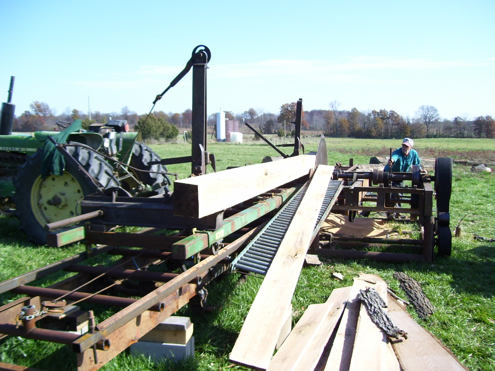

My dad bought a really old Garr (sp?) circle mill last year. It needed lots of work. He probably has about $3-4K in it but lots of hours of fabrication (it initially had a wooden track). The pic shows it with a 48" blade powered by an 85hp JD 2840. He now has a 52" blade on it. The track is 40+ feet long so he can saw a 20' log.
There was a steep learning curve- everything has to be sharp and adjusted perfectly to keep the boards coming out straight and the blade from heating unevenly and warping/wearing the wooden blade guides. We saw mostly white and red oak + a few post oaks and hickories.
Lots of ways you can get hurt. Not something you ever want to do when tired or distracted.

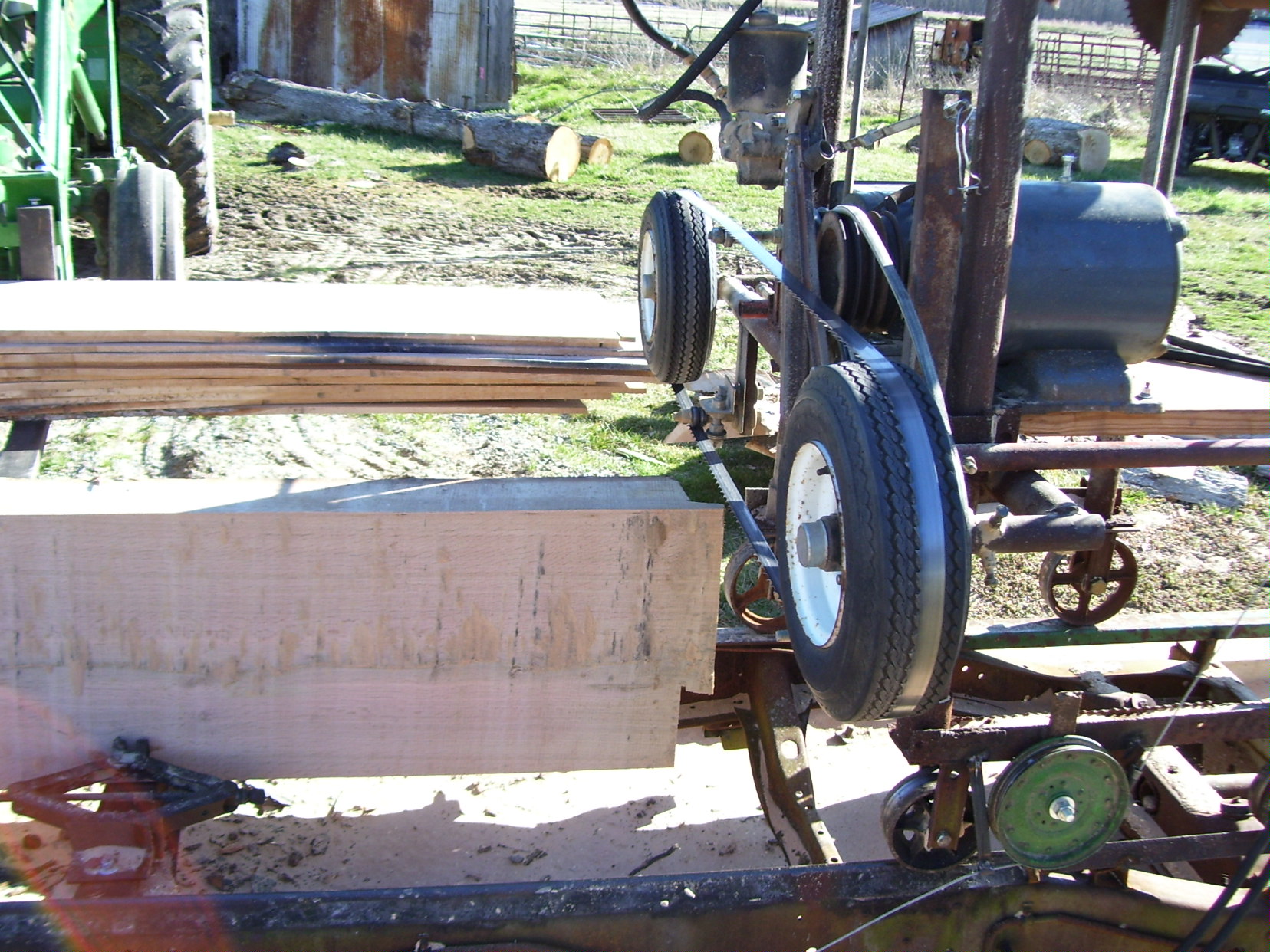

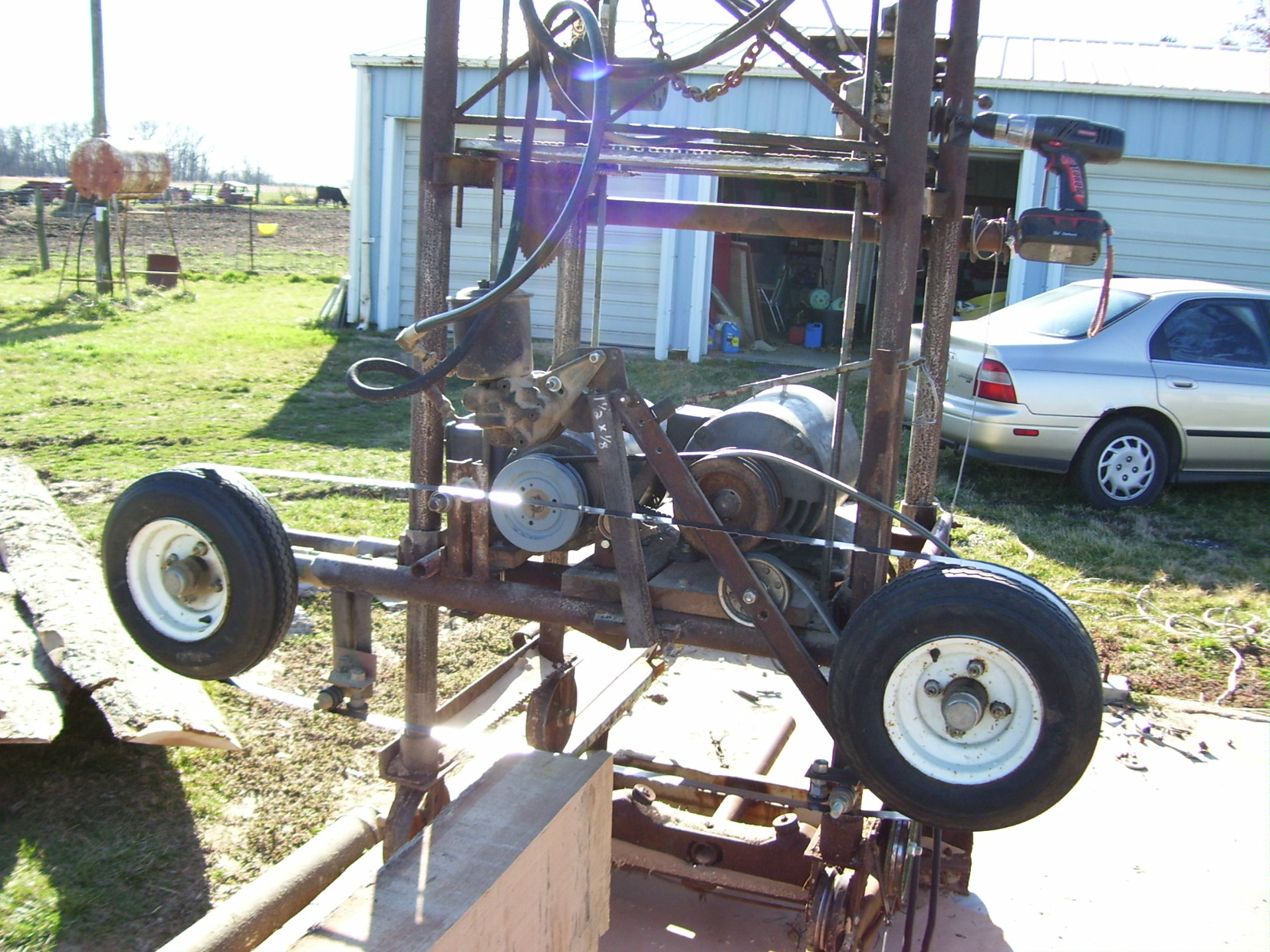

I built a band sawmill about 6-8 years ago. It works OK, but the blades had to be really sharp and good and tight to avoid waviness. The circle mill can outcut the bandmill by 4x, but the bandmill will cut a 28" x 16 foot long log (circlemill is limited to about 24") and is only 10 hp electric... Here's a link to my bandmill build thread: http://www.tractorbynet.com/forums/build-yourself/74963-home-built-bandsaw-mill.html
My bandmill with 17" wide white oak boards stacked up in the background.
I added a second 5 hp electric motor to cut faster. Hydraulic pump/motor controlled feed rate. Electric drill raises/lowers cutting head.
