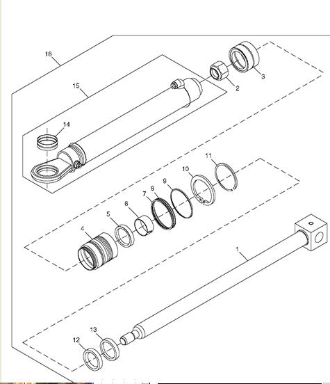

Hello, I have a JD 250 skid steer, and I have a boom "cylinder" seal leak, on the right side, I have a kit for it and tried to find out how to romove the shaft from the houseing, it has the split ring and I removed that, I tried to push in the piece that the c ring was on, and it will only go in maybe 1/4 inch, sounds like it is hitting something. I am a little dumbfound, any one have any idea ?? I asked the local dealer well they looked at me funny like I'm some kind of idiot, and said bring her in and we'll fix er up, I bought this unit from them paid over $25k new, I though they would have a little respect, but please any help would be great, thanks everyone.....

Does it look like this schematic/drawing? Found it in jdparts
Looks like two split rings.

It looks similar to that one, mine has a wleded end cap, and the other end of the ram has the same block with the hole in the middle, but there is only one split ring, I don't see any other one's, on the coller that goe's around the ram shaft. if there is one I don't see it. thanks for the help,

Go to jdparts (free but need to sign in) and search for 250 (a list will come up and there are several different 250 skid steers to look at). You may land on the one you have and get some help that you need from viewing the parts list and schematics.

Say where or what did you find this under in jd parts, I just get 1 asmbly pic and not even close to yours, but I only see 1 snap ring, I will keep looking, but if you have a part number that you used or ? that I couls use it would be great, thanks,

what do you mean by split ring?
snap ring? Circlip?

some times it takes a lot of effort to get the the rod seal out of the cylinder

post some pictures of the rod seal end and we will have a better idea how to help you.

Thanks for the help, I don't have any pic's at this time, I'm at work now. but all I see is the main out side cylinder / and the center shaft / there is like a coller that goe's around the main shaft and the out side caseing, there is a ring with 2 holes on it, it looks like it only keeps it is on from going in to the out side caseing, I removed the ring, then tried to slide the coller into the out side caseing, it only goe's in maybe 1/4 inch. some one said to slide it in 1 inch and the put in the orange plastic piece from the rebuild kit, then slide out the whole shaft. ????? I dont see anything the put the plastic piece into,
hope you under stand what I mean.... this is new to me... thanks for the help....

dose the end of the cylinder look like this
link to thread
http://www.tractorbynet.com/forums/hydraulics/168137-hydraulic-cylinder-repair.html
snap ring type
or like this one
link to article
Hydraulic Cylinder Repair : How to Disassemble, Rebuild or Repair Hydraulic Cylinders
The second is a spanner set up you can see how it unscrews inthe article and how to build the wrench.
Some time you have to assist the seal out by pulling the rod straight out.
Some times you can un hook the hydraulic lines drain the cylinder and use the piston and rod as a slide hammer to perswade it out again be careful.
I've used come along's, air (be careful its easy to launch the rod and piston), or even a portapower to pump it out. Don't use equipment hydraulics it outs out too much flow you will lanch it for sure.
tom

I found it in jdparts, under Model 250
Takes you to a list where 240 and 250 skid steers is found.
Going there, and under alphabetical "B" for boom, find a break at serial numbers 925239.
Going to the higher s/n, can find this pic.
