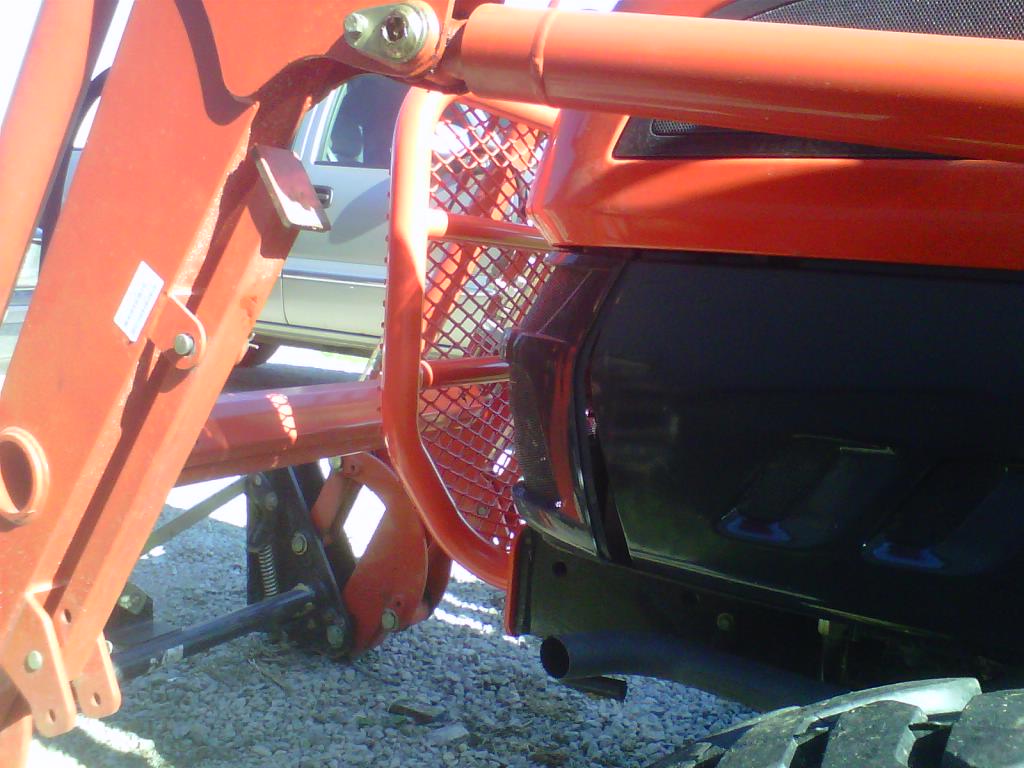

Yup...Been there, done that...

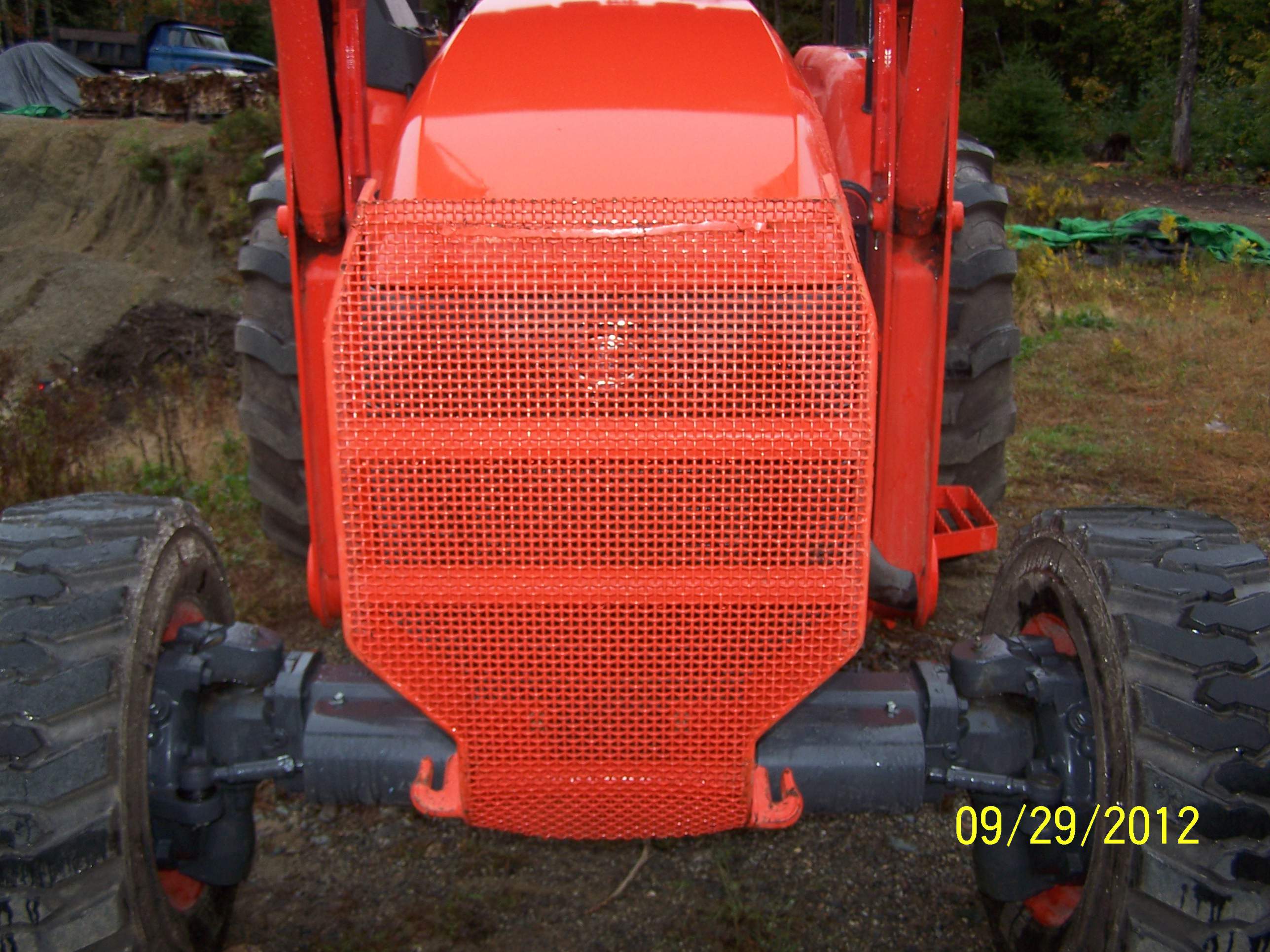

I've used #9 gauge expanded metal. It is very strong compared to what you will find at TSC, HD, Lowes, etc.

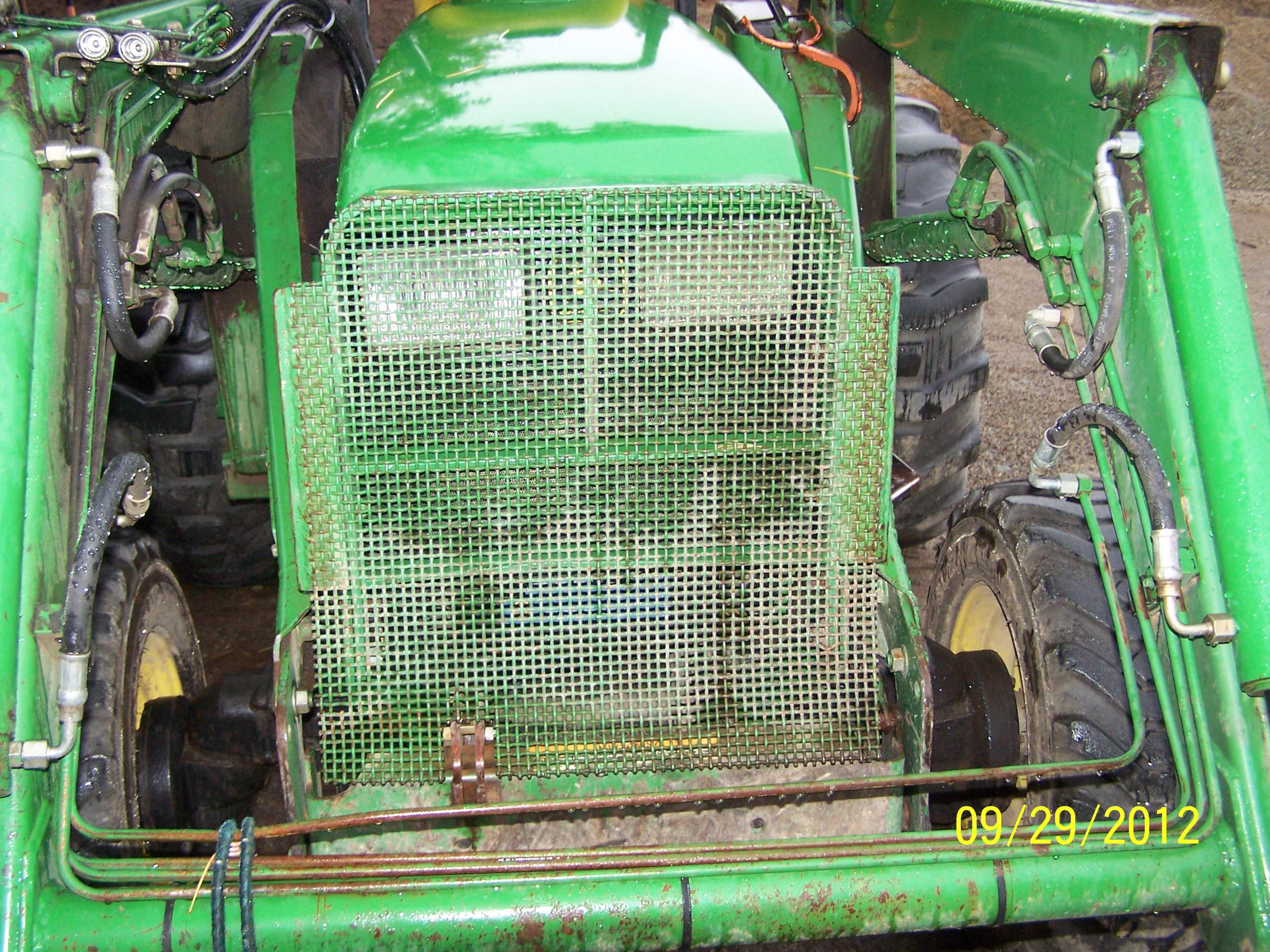

That expanded metal doesn't hold up as well as woven wire, trust me I know. I had my welder put on 3/8 inch. screen with 1/4 wire. I do screening of gravel and loam so I had the screen. You could go to an outfit that does this and ask them if they have any screen pieces laying around. The wire in these screens are hardened steel so it is strong and lasts.

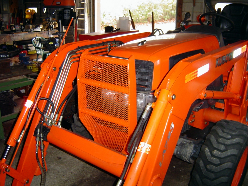

Here a couple pics of the addition to my brush guard. It has already saved my judging by the large dent in it over the middle brace. My brush guard also hinges so I still need to add some to the lower fixed part. When I was done welding I decided there was to much orange up there so I gave it a few shots of flat black followed with shaker can clear.
