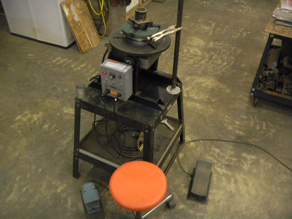

I realize this is for your own system but I see a potential problem. You're asking questions about purging mild steel and thinking the caps are cast steel. Are you using seamless pipe suitable for welding a pressure sytem? This is a pressurized boiler system so I have to ask, are you a certified pressure welder? I believe anything over 7 psi requires a pressure ticket(s). 12 psi cold is certainly going to be higher when heated. If something went wrong you could be in a lot of trouble. Not trying to discourage you, just asking. If you roll the welds, get some wheels to roll the pipe. Trying to roll it on a piece of angle iron isn't going to roll smooth enough.
   / any pipe fitter/welders #18

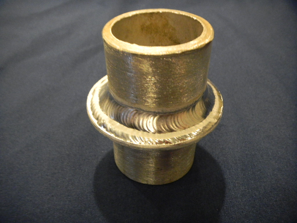

Or get one of these. This thing makes my welds look good! :cool2:
