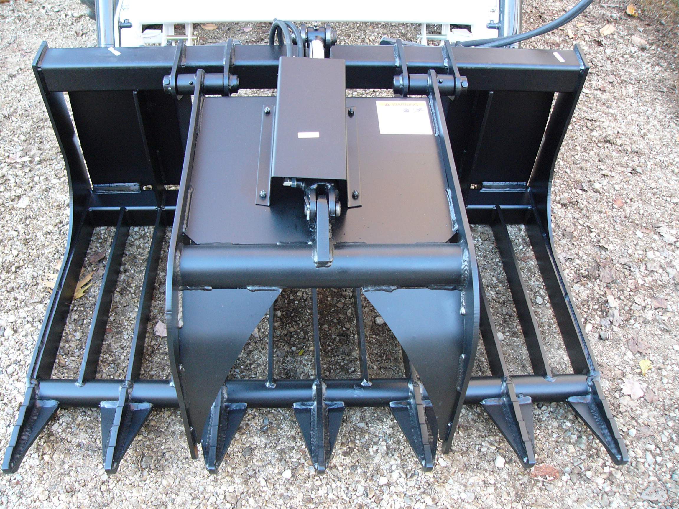

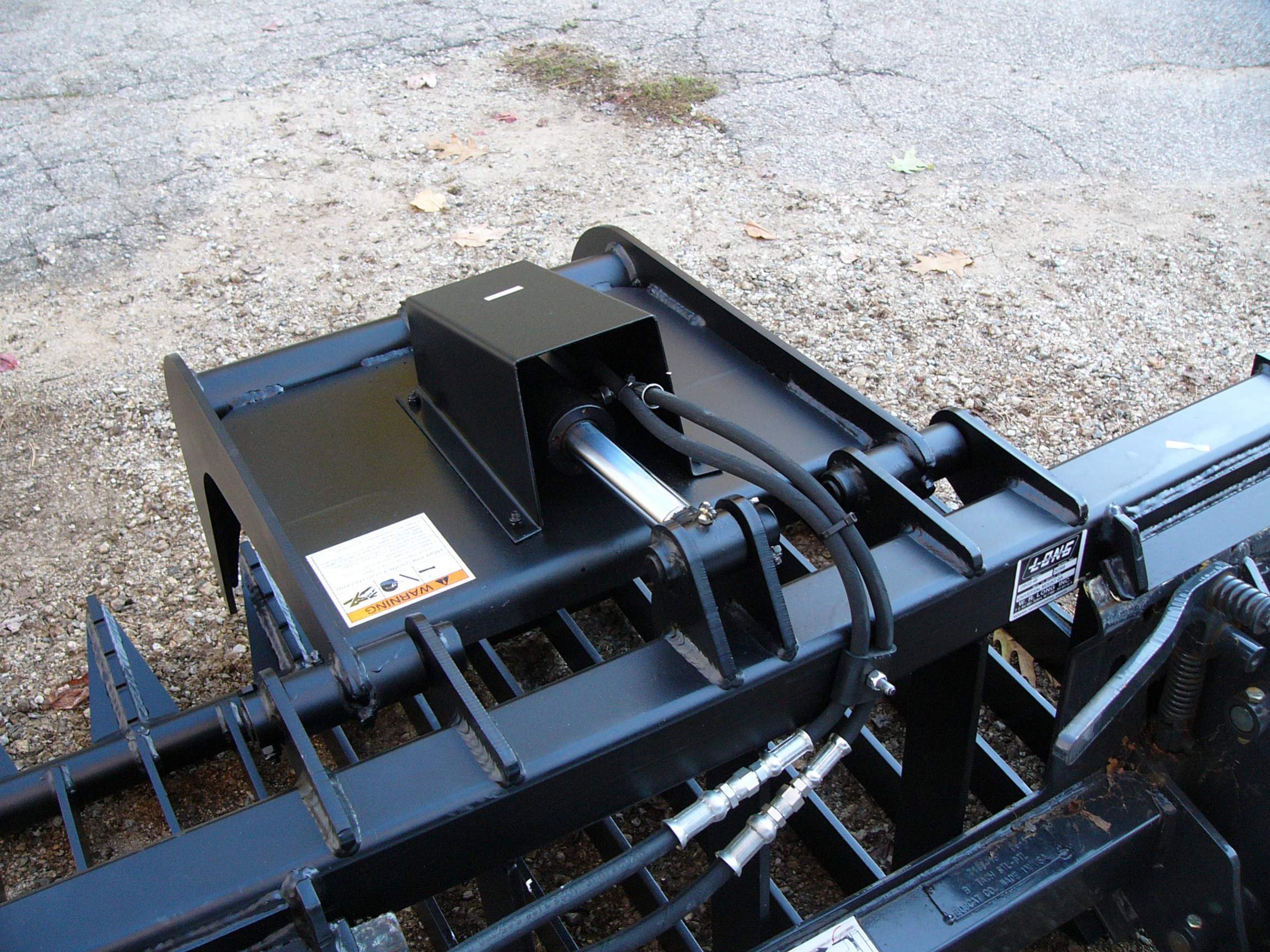

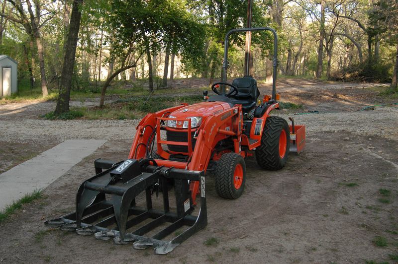

Here are some pics of the OBG2 installed on a tractor. Very nice grapple!!

Thanks, Ted, for the pictures. By the way, I'm very happy with the ETA-72BB box blade that I purchased
from you back in June. I see that it's now listed as an ETA-72XDBB on your web site.
Myrle in Candia, NH

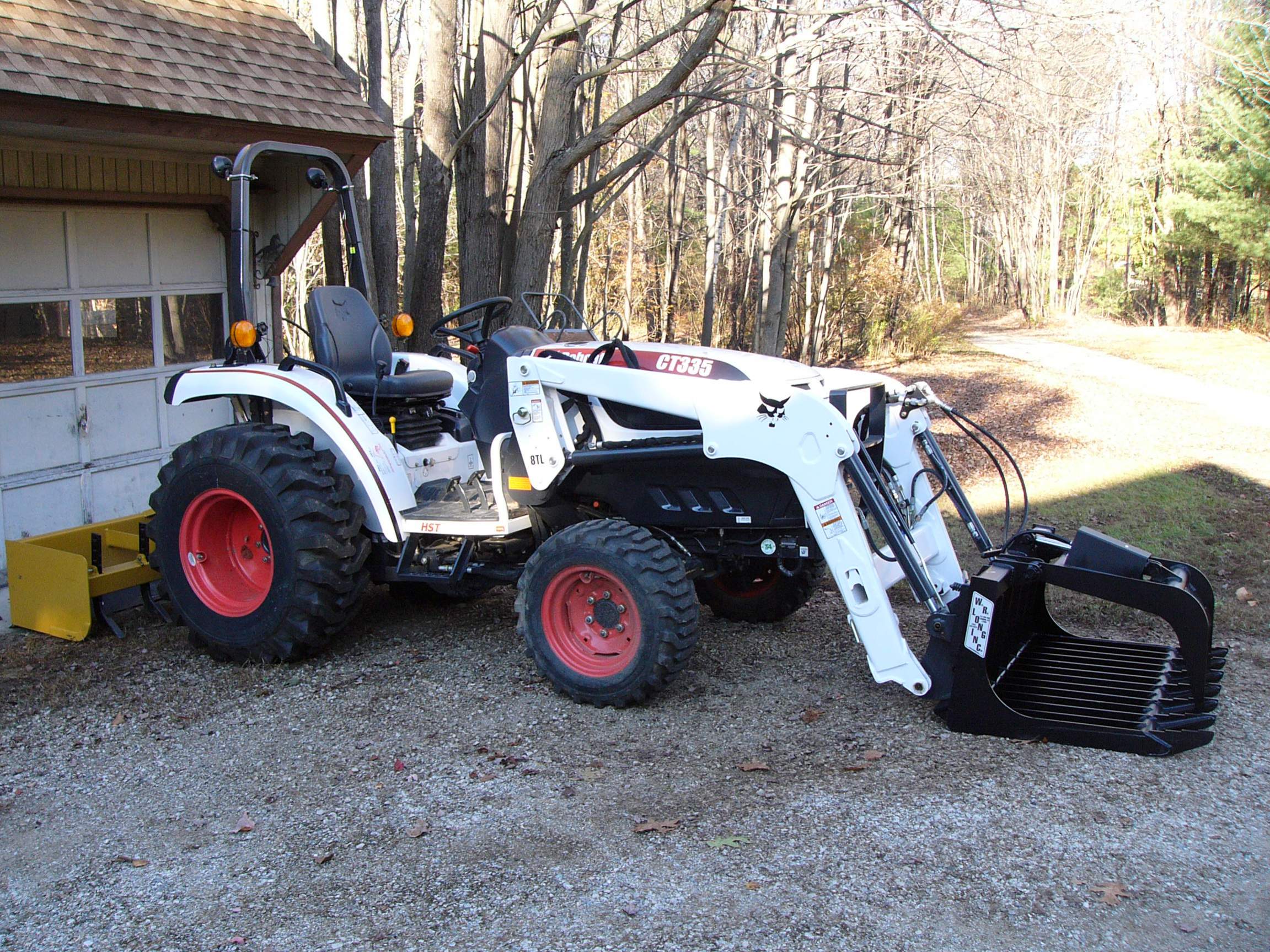

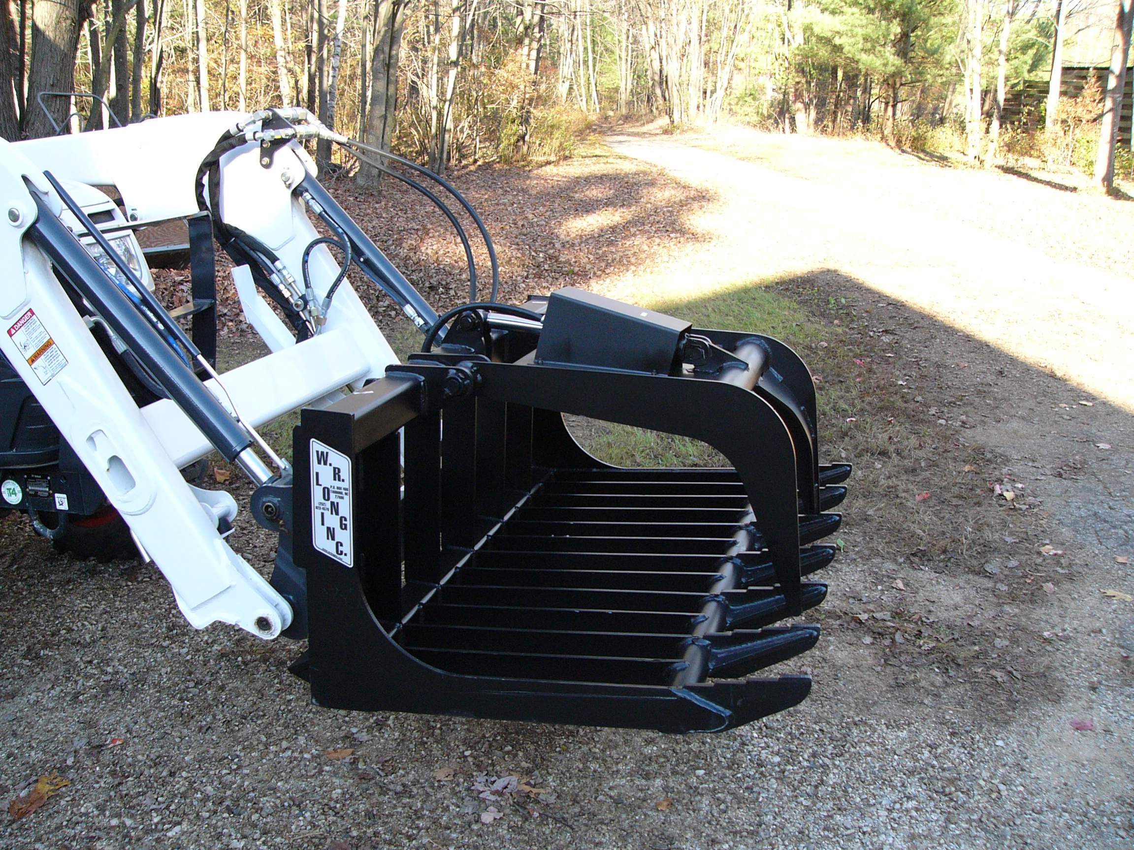

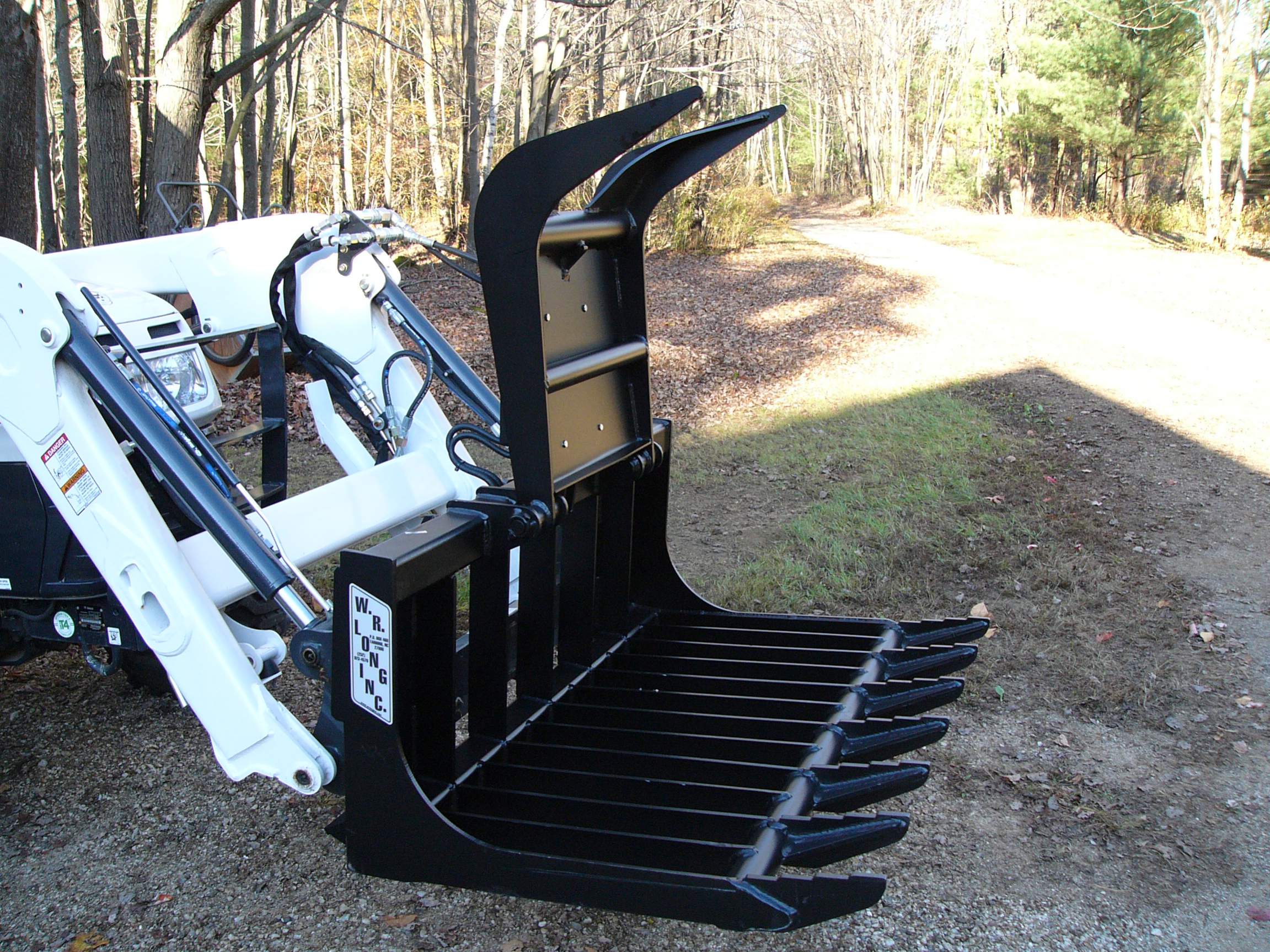

Thanks to all for your comments regarding the WR Long OBG2-48 grapple. I ordered one and it arrived today.
I'm impressed with the workmanship on the grapple and it installed with no problems. The quick attach fits
perfectly on the Bobcat CT335 tractor FEL. Now it's time to get it dirty. I'll follow up with some working
photos when I have a chance.
