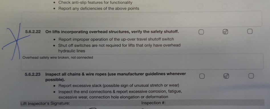

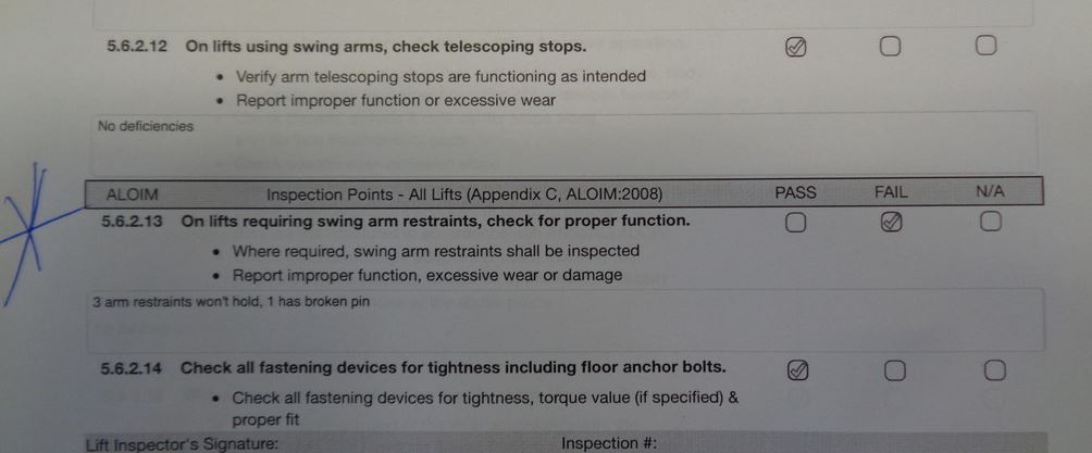

12,000#Gemini Model #GPO-12 Car Lift. This lift failed inspection and was removed from service. Please see pictures below for copies of the last 2 inspections. The reason the lift failed inspection are noted by the asterisk.
Failure was swing arm

and safety shutoff
attachment.php
Knowing crap about car lifts, although I'd like a four poster I'm thinking of trying for this two poster.
How bad is "failure of swing arm restraints"? How difficult to replace pins?

If it's referring to the locking mechanism that prevents the arms from swinging once the lift is raised, they are pretty easy to replace if I remember correctly.
It has been awhile since I installed that model lift though.

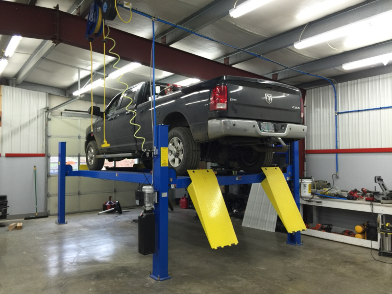

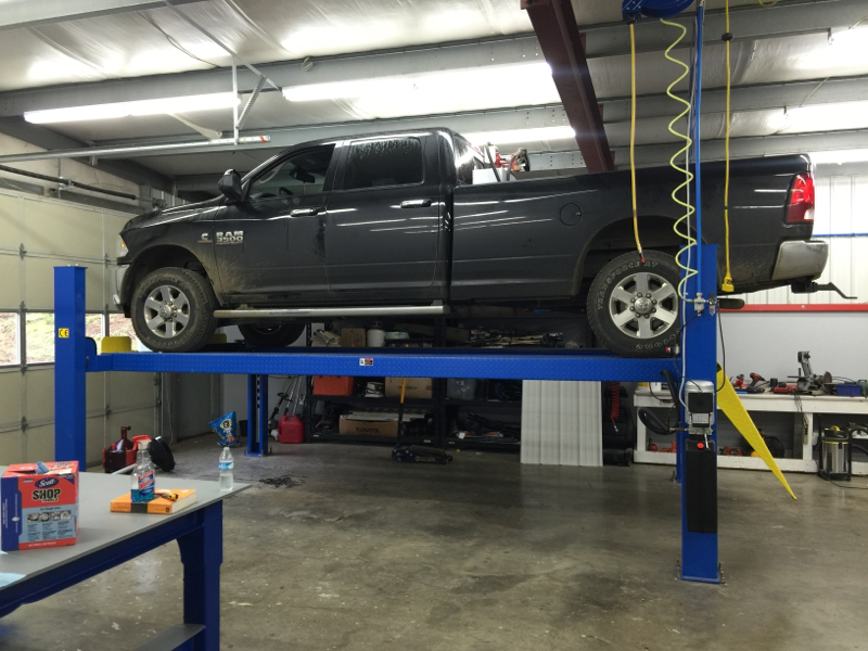

I put a lift in my shop a few months ago and went with an Atlas 14K 4 post. So far it's been flawless. The directions that came with it were terrible however.
The quality is decent, probably comparable to any other Chinese lift. It'll lift my Ram 3500 6.7 and my Kubota M7040 with ease.
