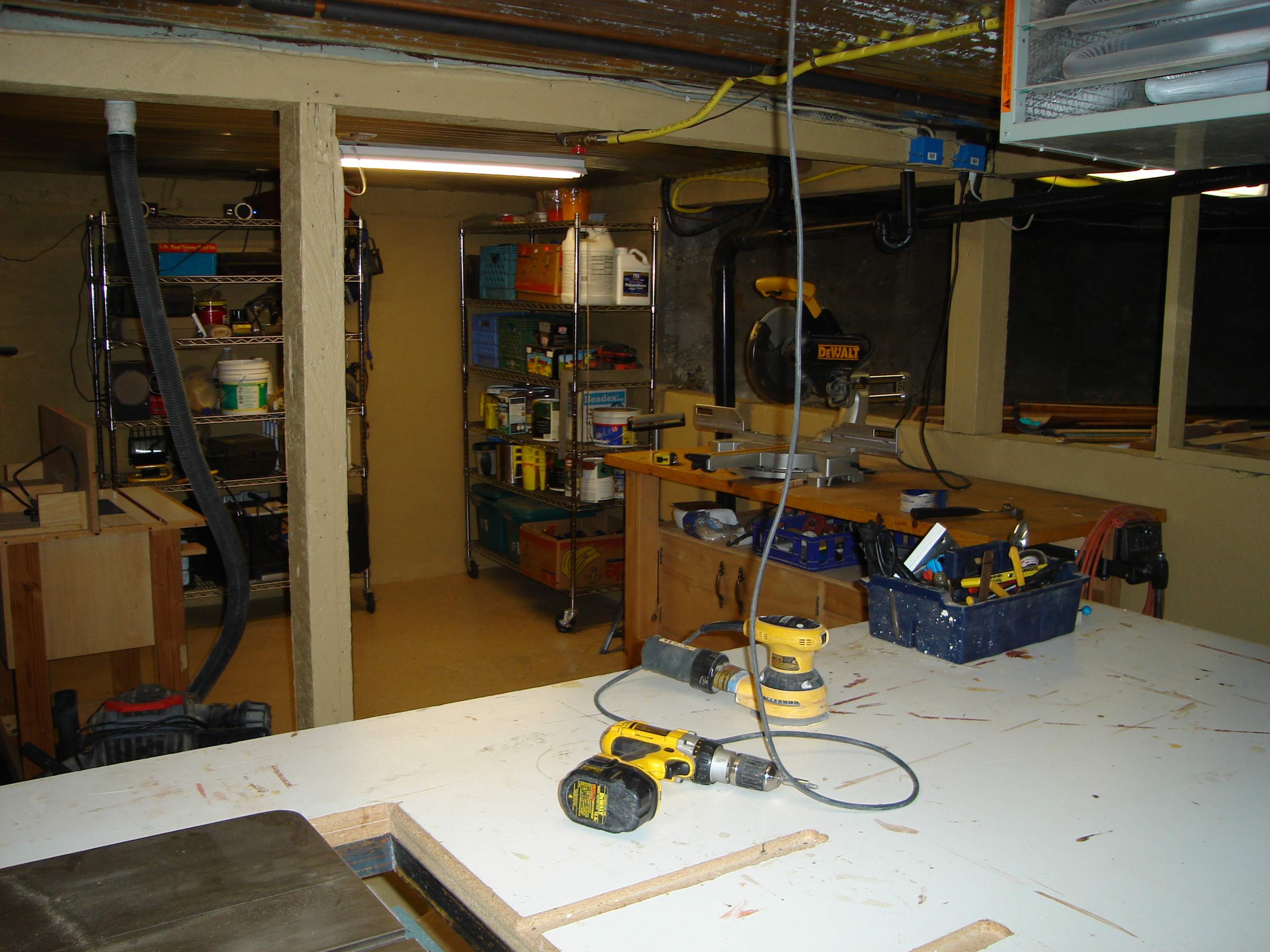

Just inside the drum hose connector there is a 2 inch fitting that deflects the air sideways. The bags I get at Home Depot have a card with 2 inch opening and a soft rubber seal. I carefully press the card over the deflector until it is tight to the inside of the drum. It is not as positive a connection as the units that have a slot for the card, but I haven't had it come off. If it does, the secondary pleated cartridge catches what slips by. Every 2 or 3 bags, I pull the cartridge and blow it out with compressed air. The key to good suction is keeping that cartridge clean, the bag has very little impact on air flow.
Once I ran out of bags and the vac was useless as the high efficiency cartridge plugged up almost immediately. Mind you I was using the central vac system on my belt sander to finish pine floors and random orbit sander on drywall topping. It was very convenient to then throw on the floor wand and vacuum the walls and floor between coats of polyurethane. With the vac on while I sanded, I was able to finish an attached sun porch right off my bedroom without filling the bedroom with dust.
You can see the vac on the left behind the table saw connected to the pvc coming out of the ceiling. I also have a dust collector for the shop equipment.
