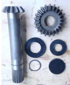

We are now stocking replacement gearsets for the JD MX5, MX6 and MX10 with Iberia Spain made gearboxes. Ken Sweet
So this will fix the Spain gear boxes that broke the shaft? Also can reuse the old pan?
   / Any source for John Deere MX6 cutter parts? #88
Yes it will, however, we are currently our of stock until the first week in July. We do have in stock the kit for the MX10 cutters. Ken Sweet
   / Any source for John Deere MX6 cutter parts? #89
