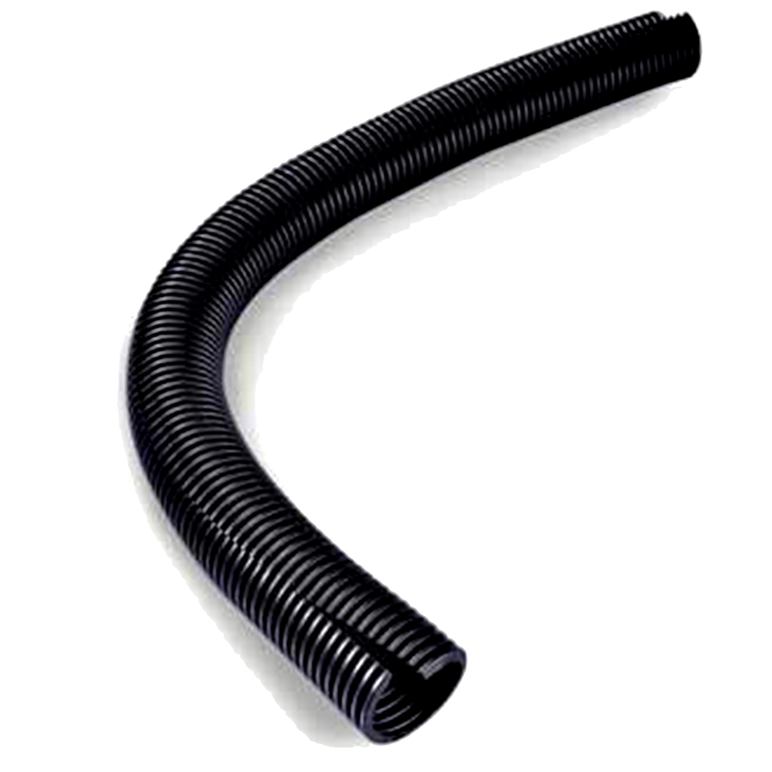

General like to use split loom cover on exposed wiring and not have to worry about insulation type (use whatever is in wire drawer).... And also give wires a little protection....
I'm sorry but that stuff is piss poor for wire protection.
