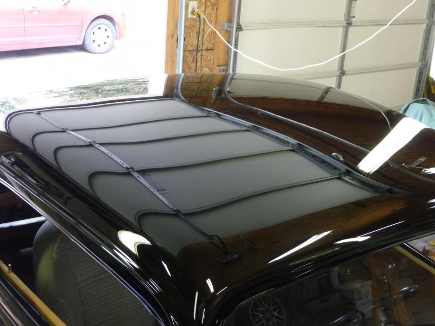

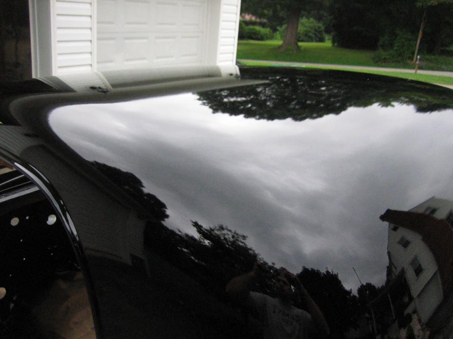

What I suggested is epoxy primer. Southern Polyurethanes makes it. Their plant is in Blairsville Georgia. I've used epoxys from several of the major paint companies, and I like the SPI epoxy a lot better. Here are a couple pictures of a paint job I did with SPI products.
