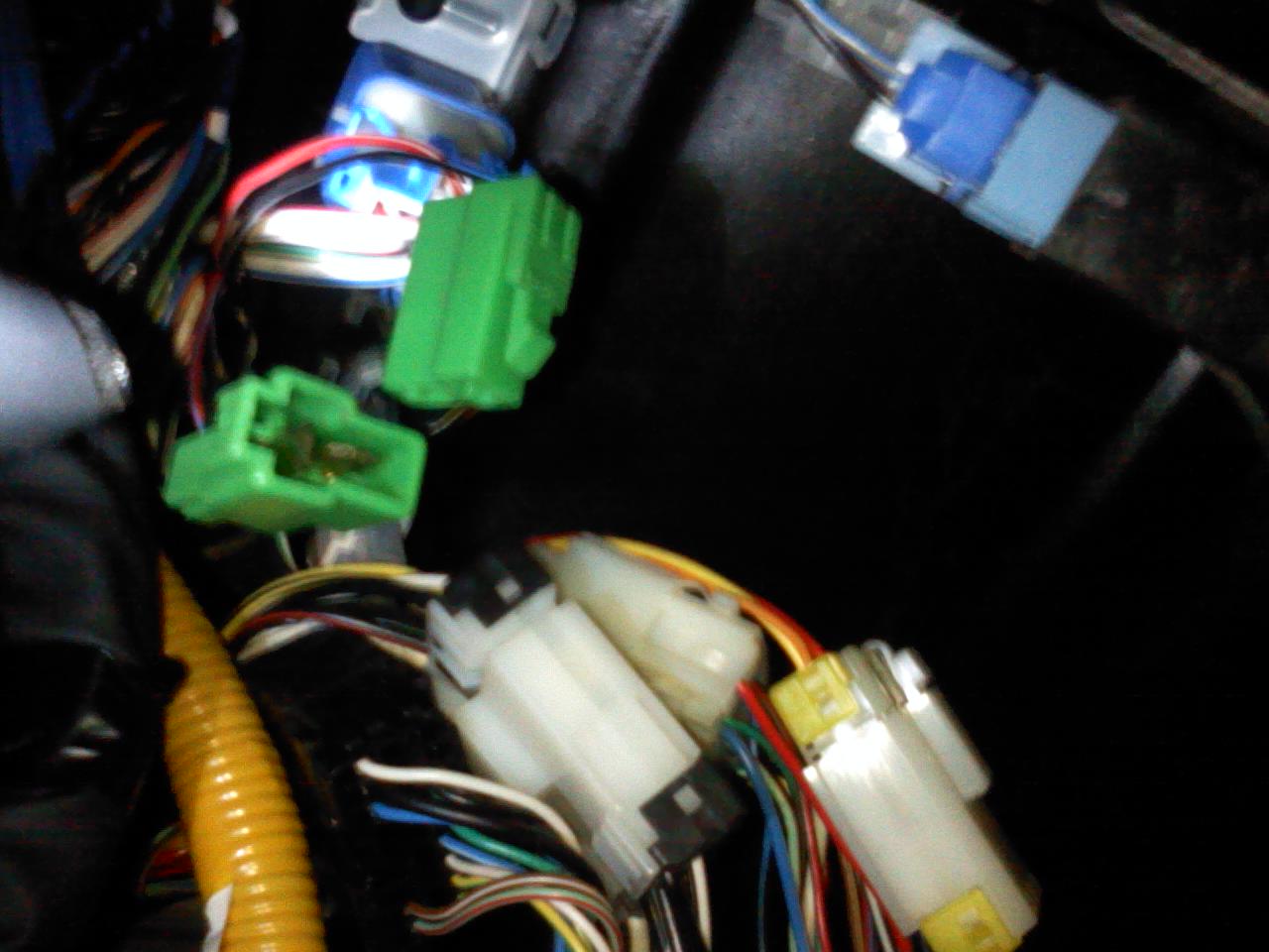

I have a question for Sackett2 because of your experience as a Subaru tech.
You may be able to tell me what the pair of wires under the dash that are disconnected are for. They are unique in that they have a green connector, none of the other wire connectors are green that I can see.
When I plug them together with car off but key in ignition dash lights start flashing, the electric cooling fan goes on and I hear clicking in the back, maybe fuel pump or something??
I did not try to start the car with them connected, If anyone else has a clue what it is I'd like to hear about it. the only other problem is the overhead clock does not work.
Thanks JB,

   / Any Subaru owners? #58
messaged you; leave them unplugged
