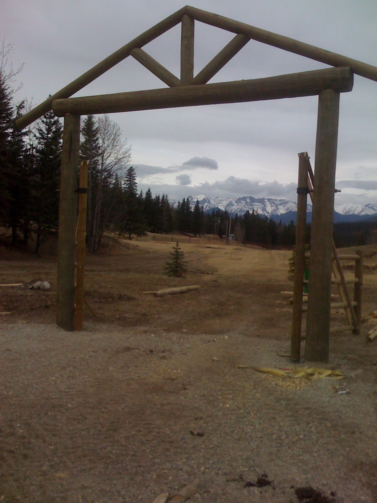

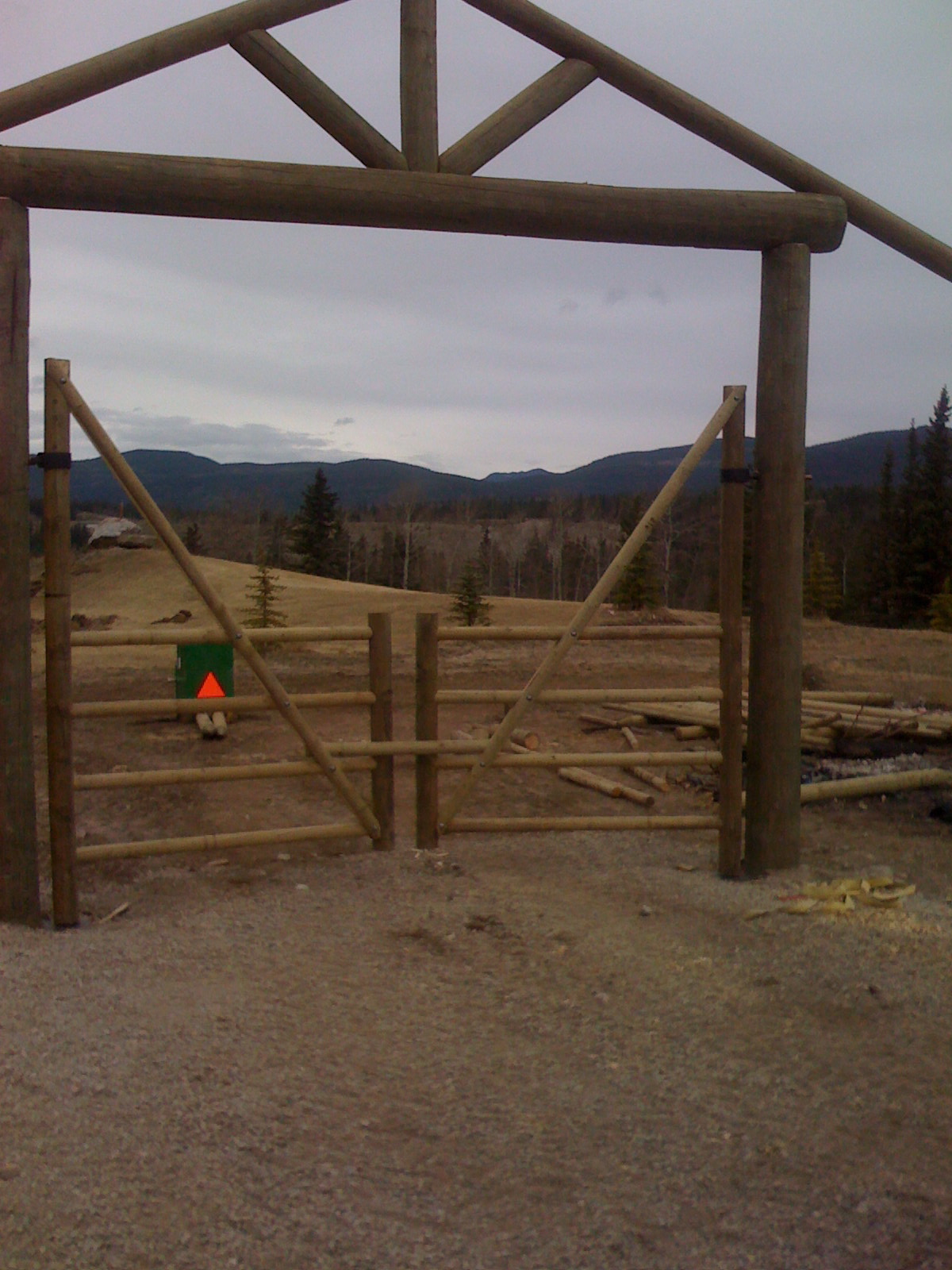

   / Any suggestions on my new Gate Plan. #15
Are these yours? The gates and the view look GREAT. :thumbsup:
Ya, those are mine at my place near Hinton, AB. I'm going to do something similar at the new place in Regina. I love the "ranch" look, and want to bring some AB back to SK with me!!
The hinge system that we fab'd up was very simple, but very robust, and I think/hope will work well with a gate opener.
Here's a better pic of the view.....
