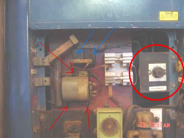

I know I have used Dialarcs in the past, but can't say I've ever worked on one.
Have you checked the points? You may have to clean them with some emery cloth, and re set the gap. Normally .010".
The points are to the left of the red circle.

Thanks Terry I think I found one failed component. Just to the right of the HF points is a ceramic looking tube that is broke in half. The break looks fresh. I looked in the downloaded owners manual and it's a resistor that is part of the HF panel. I searched for the part number online and didn't see it available but it's a 100w 10 ohm resistor. I did see another Miller resistor with the same specs and it looks similar for about 30$. I also found newer looking off brand ones for 3-4$. Not sure if either or both would work? Also not sure if this is the only problem or if something else caused it to blow. Any suggestions on replacing the resistor or anything else to check?
Sorry I missed your post.
Yes I did set the points at first to .008 which they recommend but it seemed to work better at .010 as you suggest. I also did scuff them slightly with an old sanding belt. It was doing great till it just quit lol. That last post describes a failed component I found, do you have any ideas on what to do? Thanks SA
As long as the resistance and the wattage ar the same it will work electrically. You may have to extend leads to fit, if its not the same physical size.
