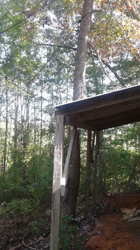

I'm PRETTY serious about getting an Echo PPT 280 PLUS the 4 foot extension, thus getting 17 foot of pruning reach.
I don't plan on using it for hours at a time, rather pull it out for trimming "leaners" so I can get them down safely.
This one for example required me cutting 4 branches w/ my 17' manual pole pruner while standing on an adjacent roof
leaning-tree.jpg.

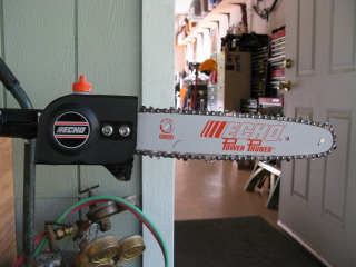

Only upgrade I did was to make up some 63PS or 63PS3 full chisel picco chain 44dl for it. Cuts 20% faster. Yep they all get heavy and I didnt use a harness.

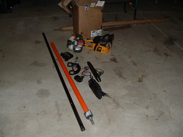

Also you dont hear of folks bending the echo extension ppt like the others. They are super sturdy. I had mine apart in a pic here I will share.
Dont know if the weights are still the same no b+c weight. This was 7 years ago.
PPT 265 12' 2" Dry Weight (lb)* 17.4
PPT 260 12' 10" Dry Weight (lb)* 16.7
PPT 280 13' Dry Weight (lb)* 19.2
