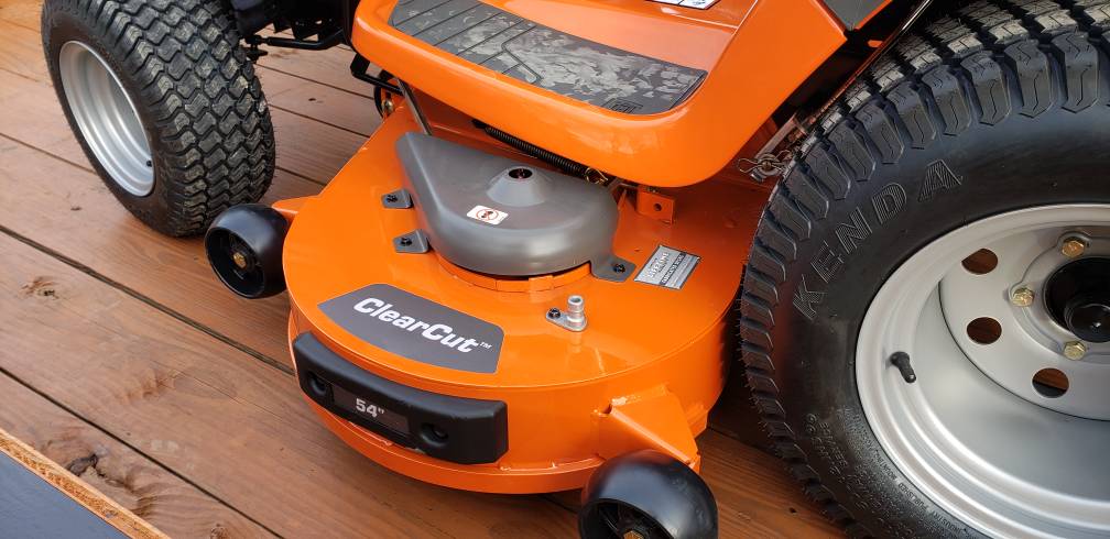

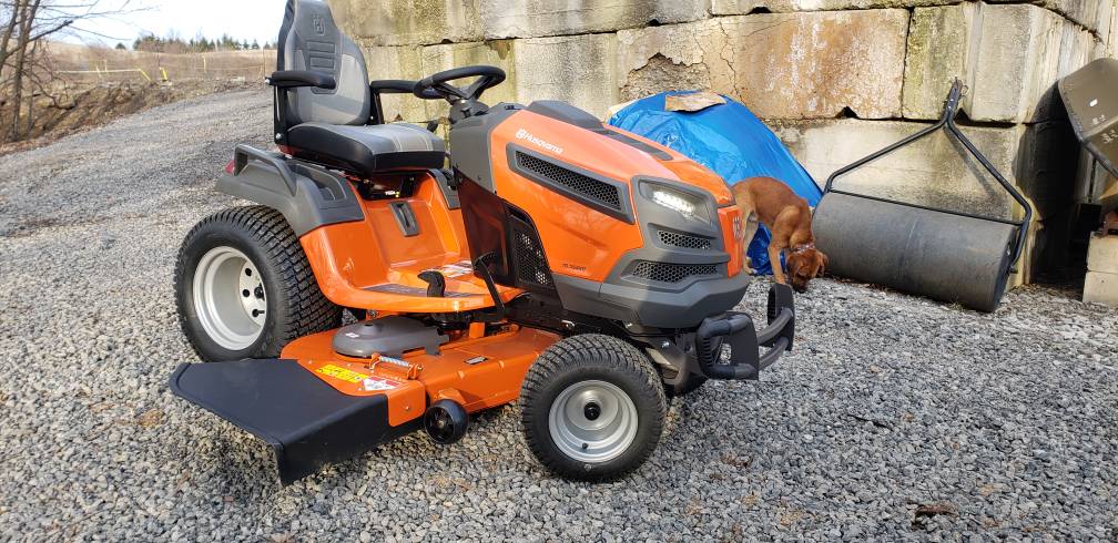

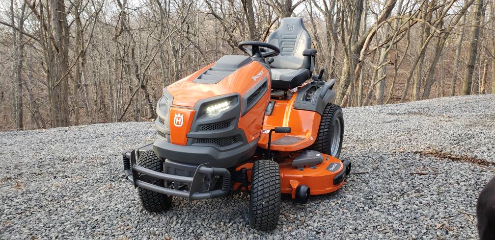

I would say to consider a Husqvarna TS354XD (2018, but still some out there left over, I bought one this past Monday) for $3700 with the Kawasaki 24HP V-twin and Tuff Torq K66 with E-Locker differential.
Next up, I would look at Simplicity Prestige or a John Deer X7XX series, but price will be doubled over the Husqvarna.
