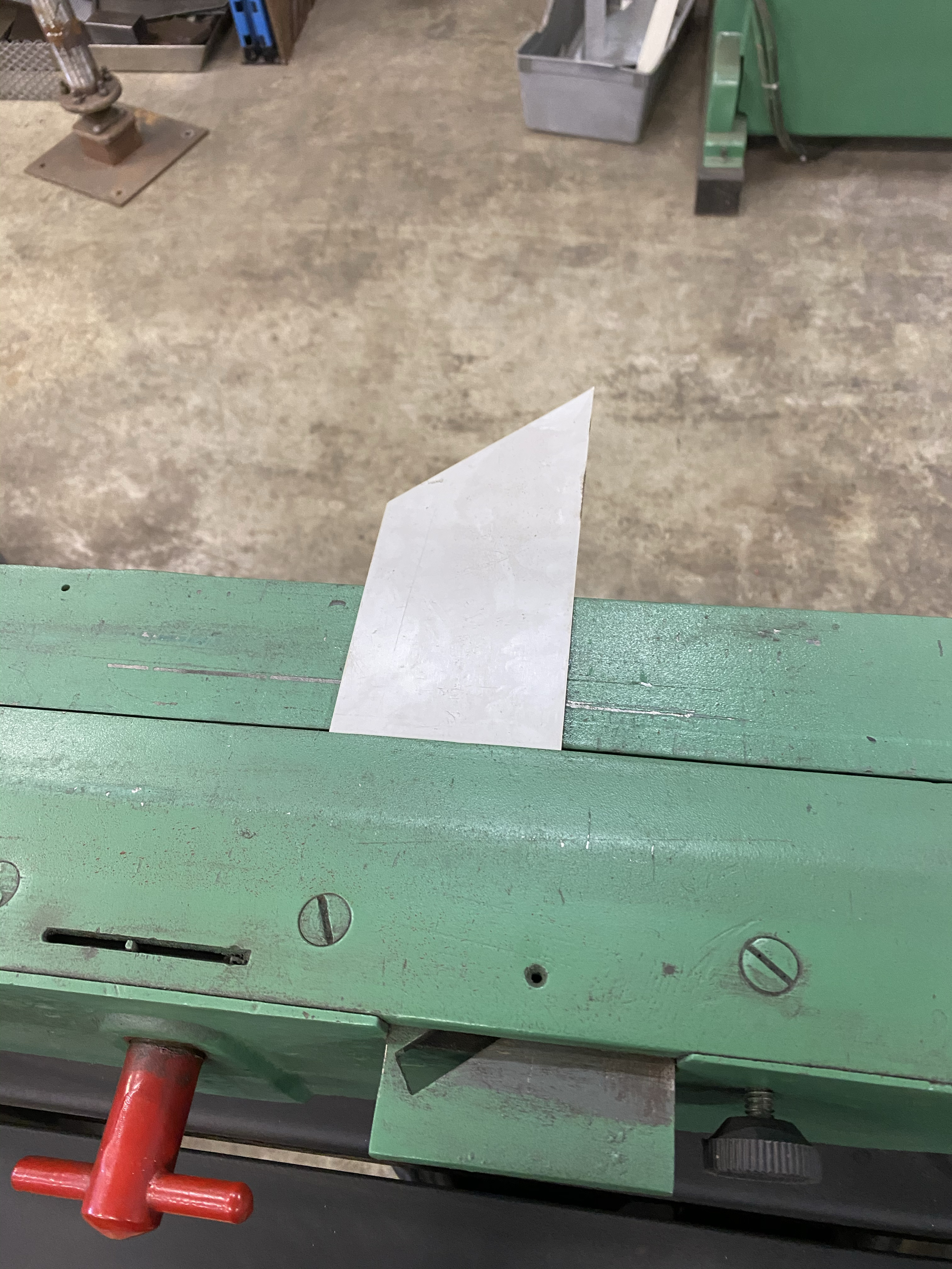

Thanks for the help but I bought a couple of scribes and a 36" break.
Funny thing about the break, the 3rd project I did on it, I wanted to make a hem on a 39" piece of tin.

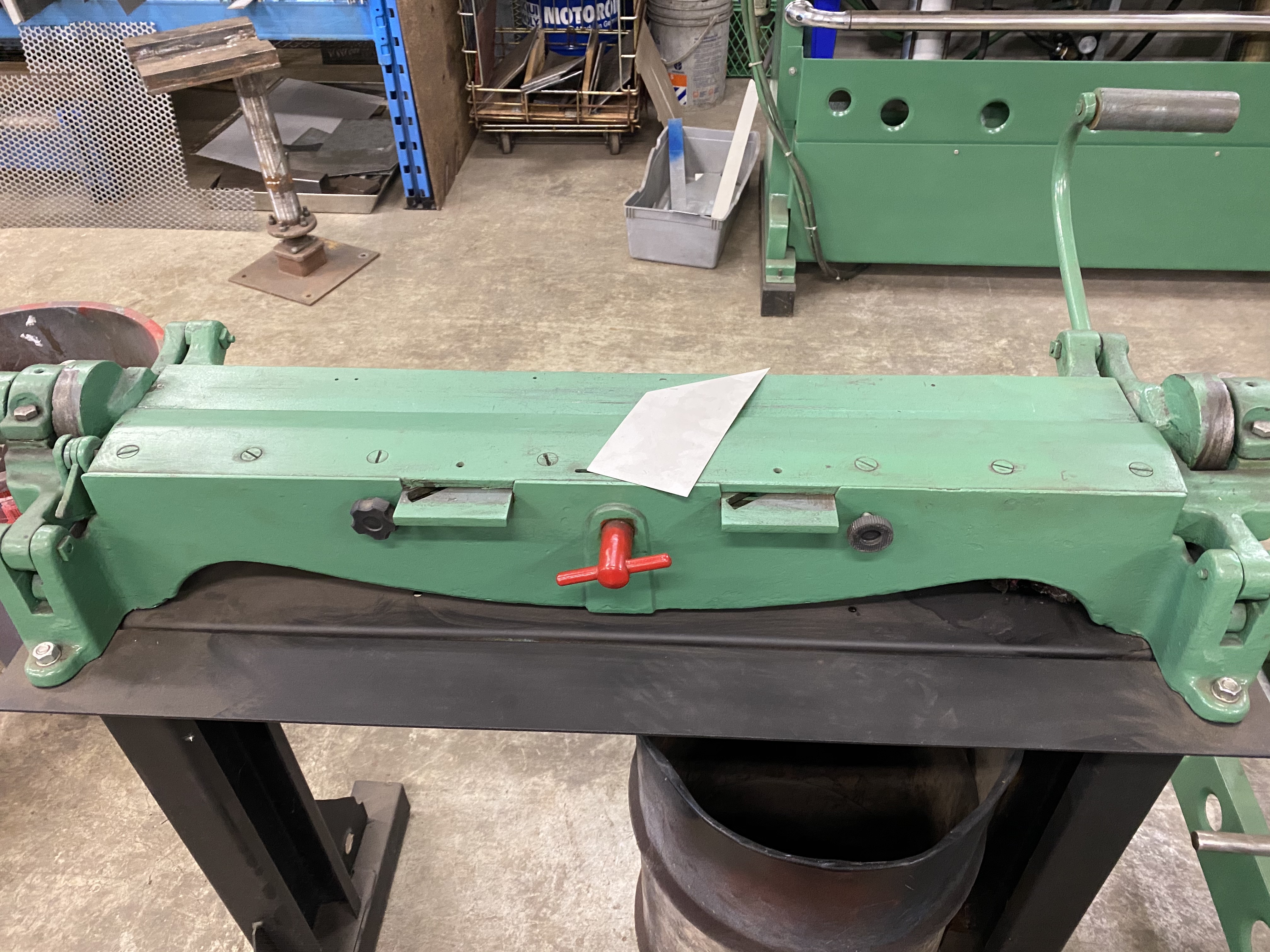

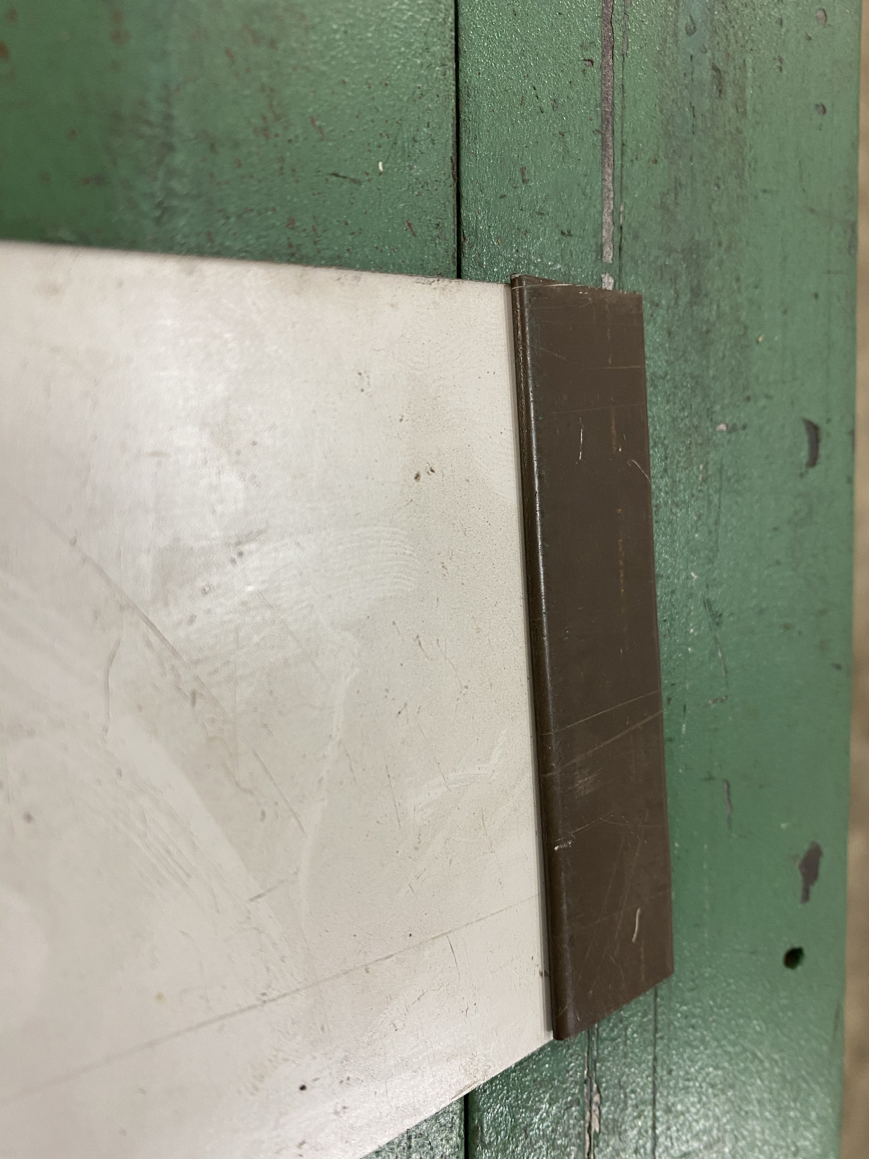

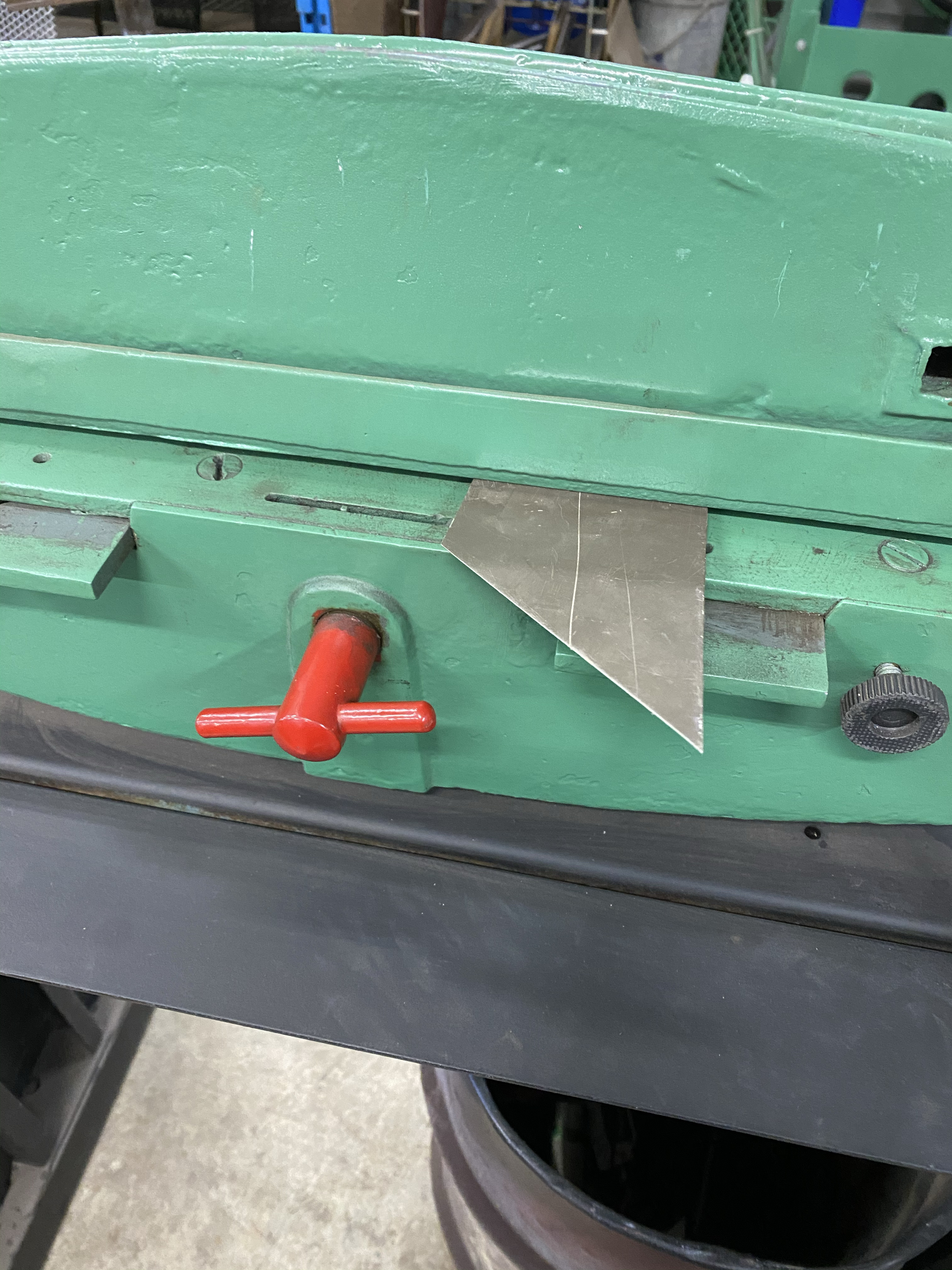

   / Any Tinners out there #38

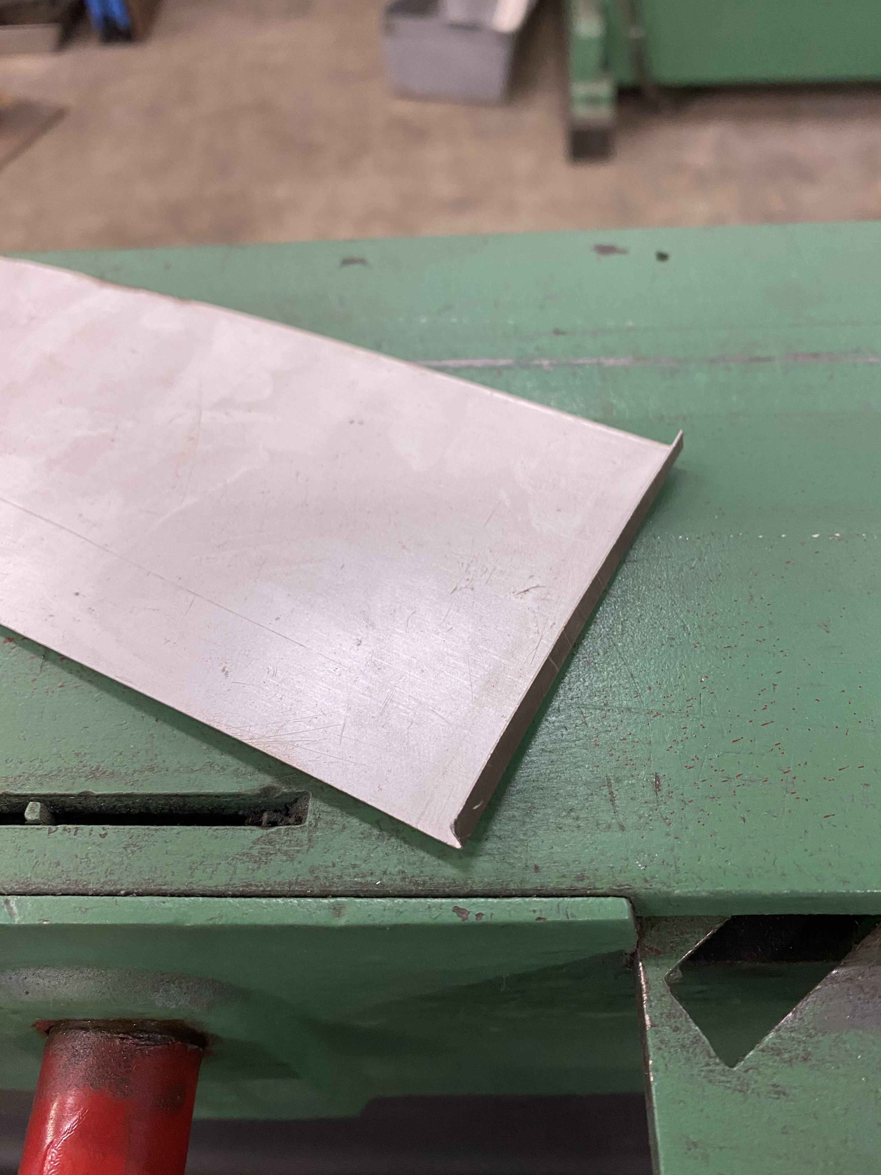

This is what I use for hems. A bar folder.
Single hem
Double hem
