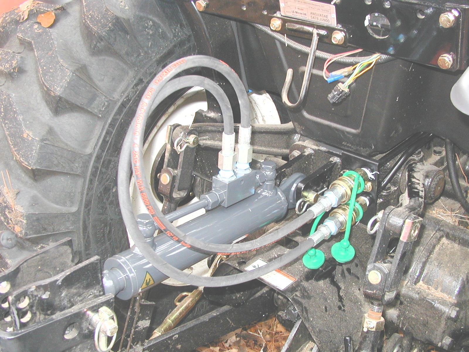

I've been looking at lots of pictures on TBN and believe the kit is for a single scv remote. Unfortunately, the kit and instructions are with the tractor over an hour away (we only get to see each other on some weekends.) There is a single small lever to be mounted under the seat, lots of black rigid metal pipes of various lengths, a block, threaded bolt looking things with holes, lots of compressible washers, mounting hardware, etc..., but no rubber hoses of any kind that I can remember. From the crappy pictures it looks like the majority of the installation happens just under the seat. (That's why I'm thinking that removing the right rear wheel is just a convenience thing I can ignore.) My plan is to eventually use it with a CCM hydraulic top link.

I'm inexperienced in hydraulics and I installed three rear remotes and a power beyond kit myself with minimal cussing. Deere's instructions were well written, and I obtained the instructions before buying the kits to determine whether I was up to the challenge.
As you've noted, hydraulic fluid is slick as snot; but I don't know about the taste. I removed the right rear wheel and both fenders, the seat and other trim panels and it was necessary for me to do that in order to install the kits.
The biggest thing that helped me was having a crapload of Crow's Foot and flare nut wrenches to do the job, along with taking my time, checking off each step on the instructions as I went, and keeping the surgical field clean to keep dirt out of the system.
