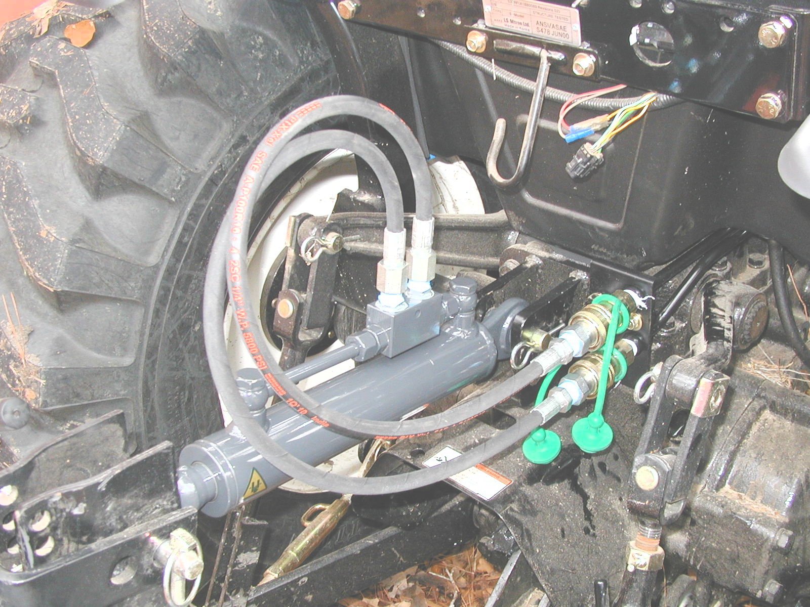

Funny, I thought the same thing after I finished the install. The single remote lines were already close to the 3 pt. lift arms (see attached pic.) I was originally planning to use the rear remote to operate the grapple and the 3 pt top link. Changed my mind after I realized I was going to have to insert QC adapters in the hose to be able to remove the FEL. Ordered one of these last week to divert the bucket curl function to the grapple with an electric switch.
https://www.surpluscenter.com/item.asp?item=9-7852&catname=hydraulic
And ordered this to control it:
Amazon.com: Pilot Automotive PM-2109S Motorsport Silver Manual Shift Knob with Purge/Starter Button: Automotive
Not sure how I'm plumb it up yet -- thought I could better figure that out after getting my hands on it. I'm open to suggestions though....
