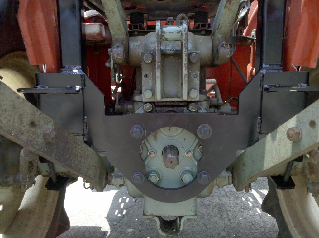

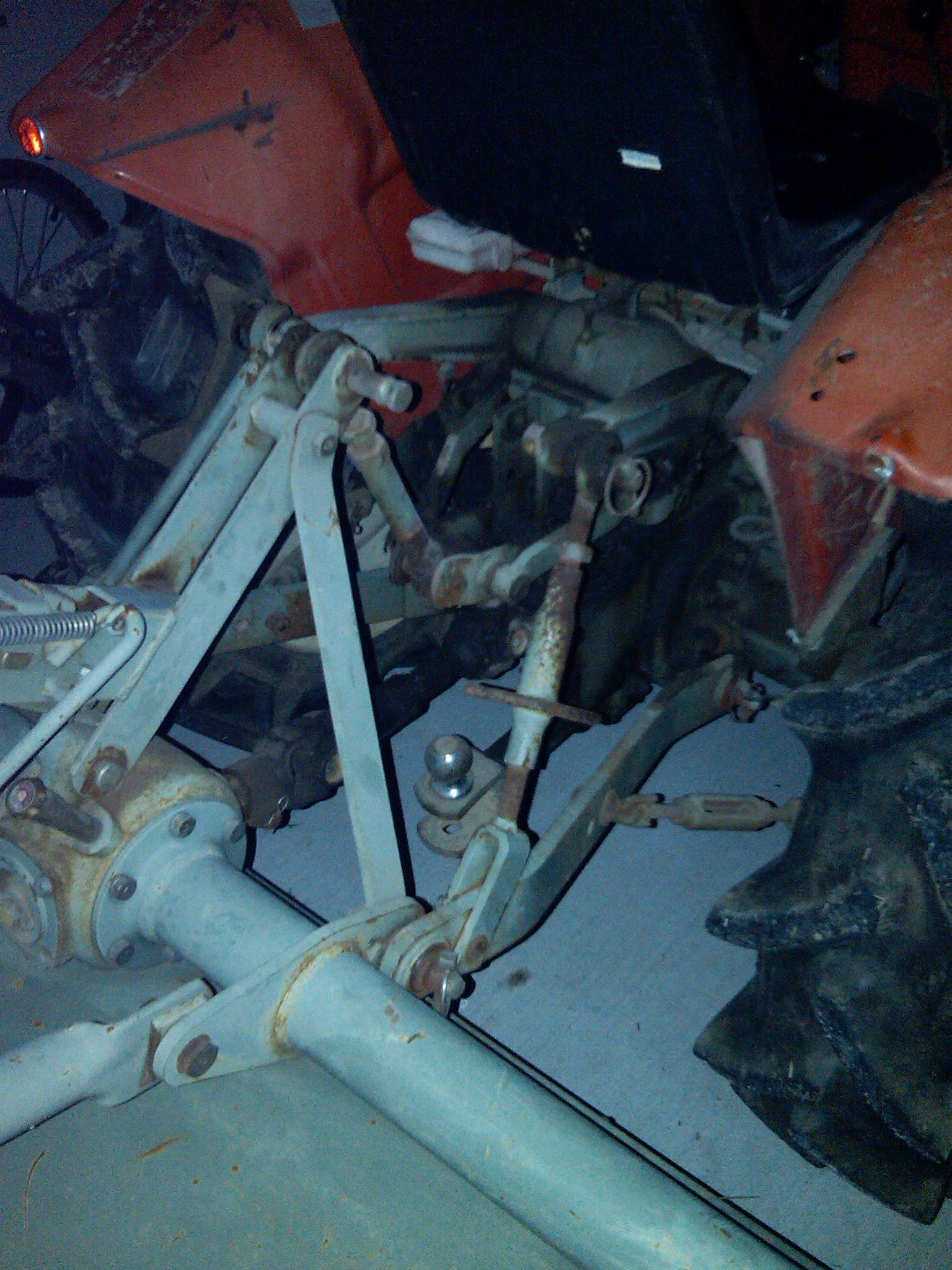

I've run into a problem. The Top Link Bracket (TLB) on my 1610 extends down further than on some of the other 1610's that I been able to find pictures of. It actually fits into the indention in the top of the PTO shield. Because of that, the top of the lower rollbar mount (LRM) will not clear the TLB and therefore the four holes will not line up so that I can bolt the LRM in place. I've attached some pictures to help explain what I mean. The first picture shows the PTO shield and the TLB actually resting on the shield. The second picture shows the TLB with the PTO shield removed. The third picture shows how my tractor is setup with the tiller attached. It uses the bottom set of holes on the TLB (there are three sets of holes) to attach the top link bar to the tiller. I'm not sure what to do at this point. Maybe I could take the TLB off, turn it upside down and reinstall. I know that means I would have to reconfigure how the tiller top link bar attaches. Anyone ever run into this situation? Any suggestions?

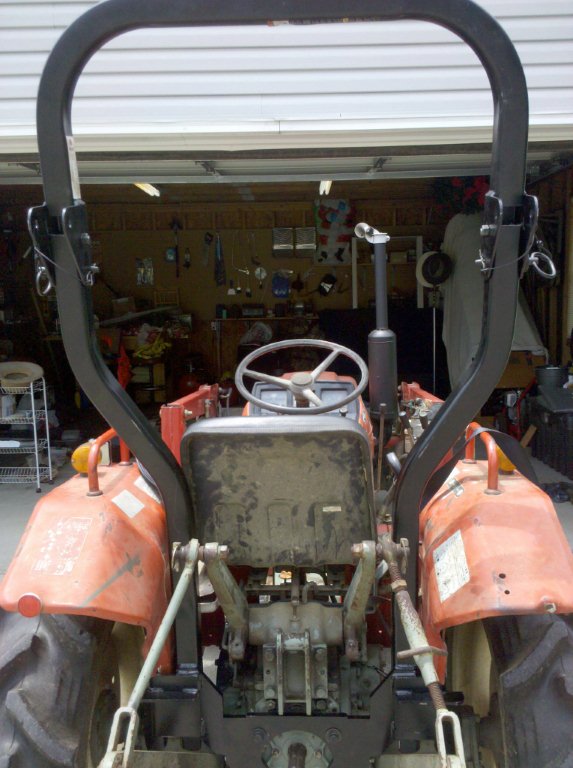

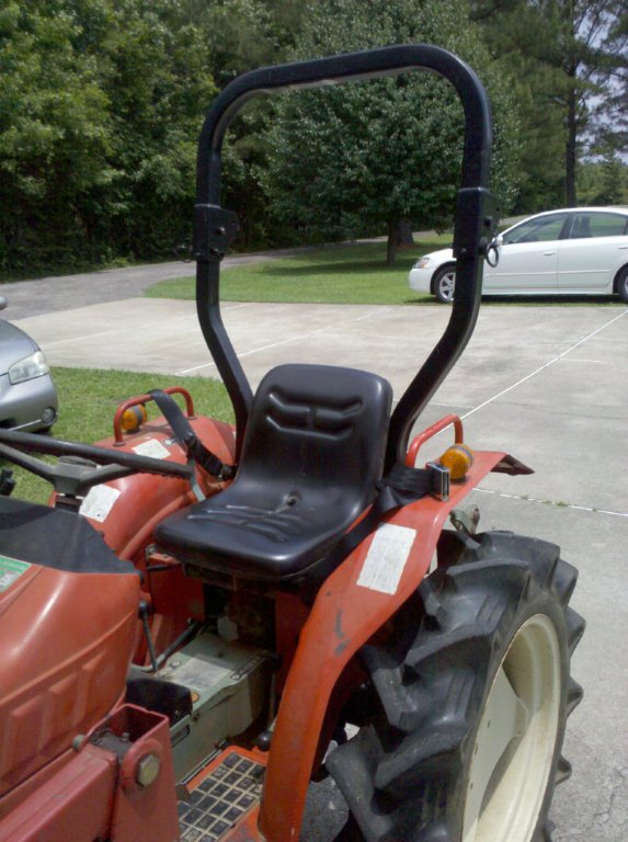

Success! I got the ROPS installed today. It only took about two and a half hours. Thanks to everyone that offered tips/suggestions. I would also like to thank a friend of mine, Jason Haney, for his help. He made the installation easy. I did have to turn the Top Link Bracket over to get clearance for the lower rollbar mount. We ran in to a small problem with a stuck pin in what I would call the middle lift arm. We had to remove the left upper lift arm so that we could hammer out the stuck pin. Once the pin was out we reinstalled the upper lift arm. We removed the remainder of the "Tiller Attachment Setup". This can be seen in the forth picture. It is what the top link is attached to. After that was removed we installed the ROPS. It was a very straight install. One thing to watch out for, not already mentioned in this thread, is to snug up the lower rollbar mount before you drill the holes in the fenders that you will use to bolt to the ROPS. If you don't, you will drill the holes in the wrong place. Fortunately, I realized that with the first hole I drilled. Thanks again to everyone. I appreciate the help!
