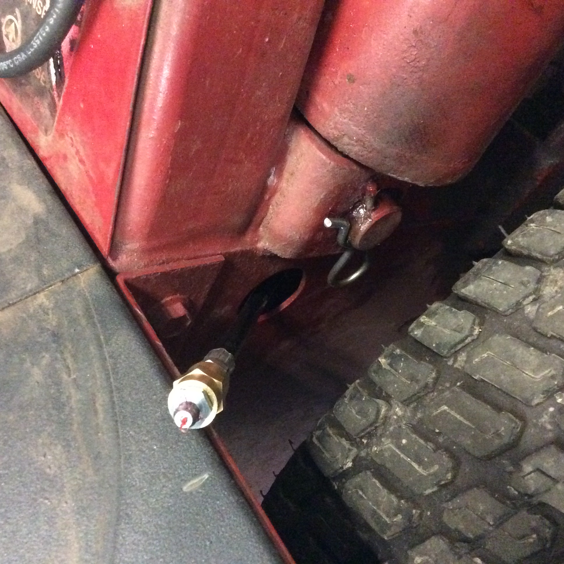

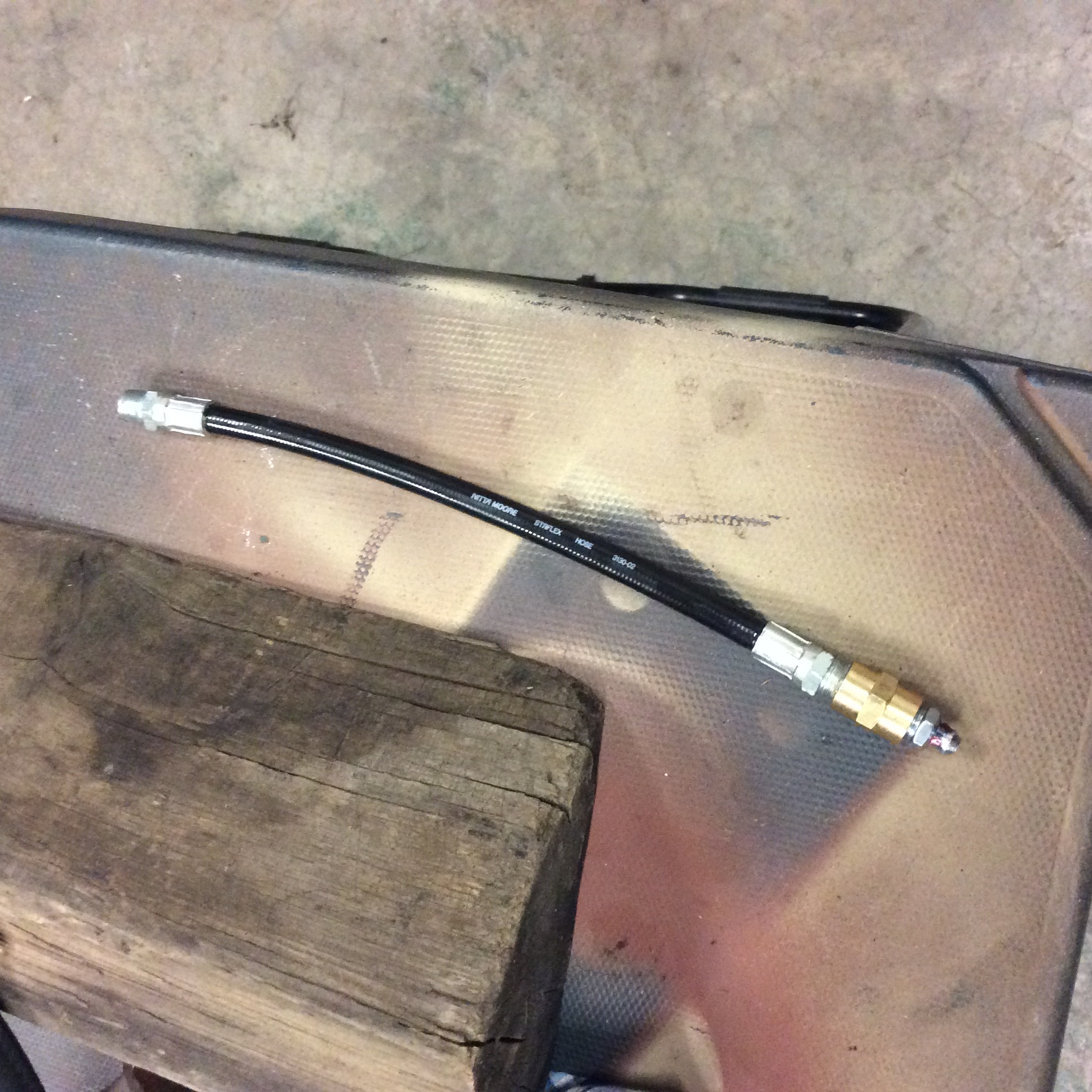

Added some zerk fitting extensions to my groundsmasters today. Used a grease gun hose, 1/8” npt union, and zerk to make them.
I put the extension on the forward pto zerk because they are so hard to get to.
The buffalo turbine had three zerks under the safety grill, so I put some extensions there too so I wouldn’t have to pull the grill to grease. The extensions cost about $6 each to make.

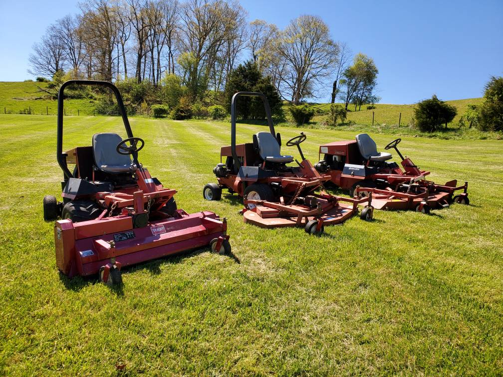

Hey fellas. I have three running and driving units for sale in southwest Virginia. Side discharge, rear discharge, two flail decks, and what's left of an old 72 parts unit.
328-2wd-rear discharge
328-4wd-side discharge
325-4wd-flail deck

What is the purpose of the flail deck? cutting rougher taller grass?

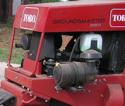

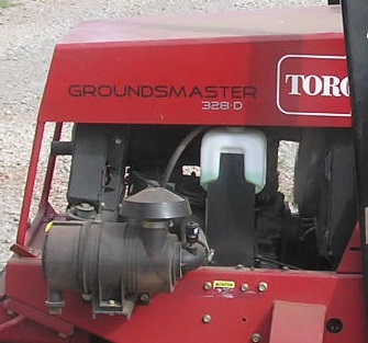

Don't have any pictures that show the shield over the fuel tank, I will check tomorrow to see if my 328D has it.
The air cleaner is from a 328D:

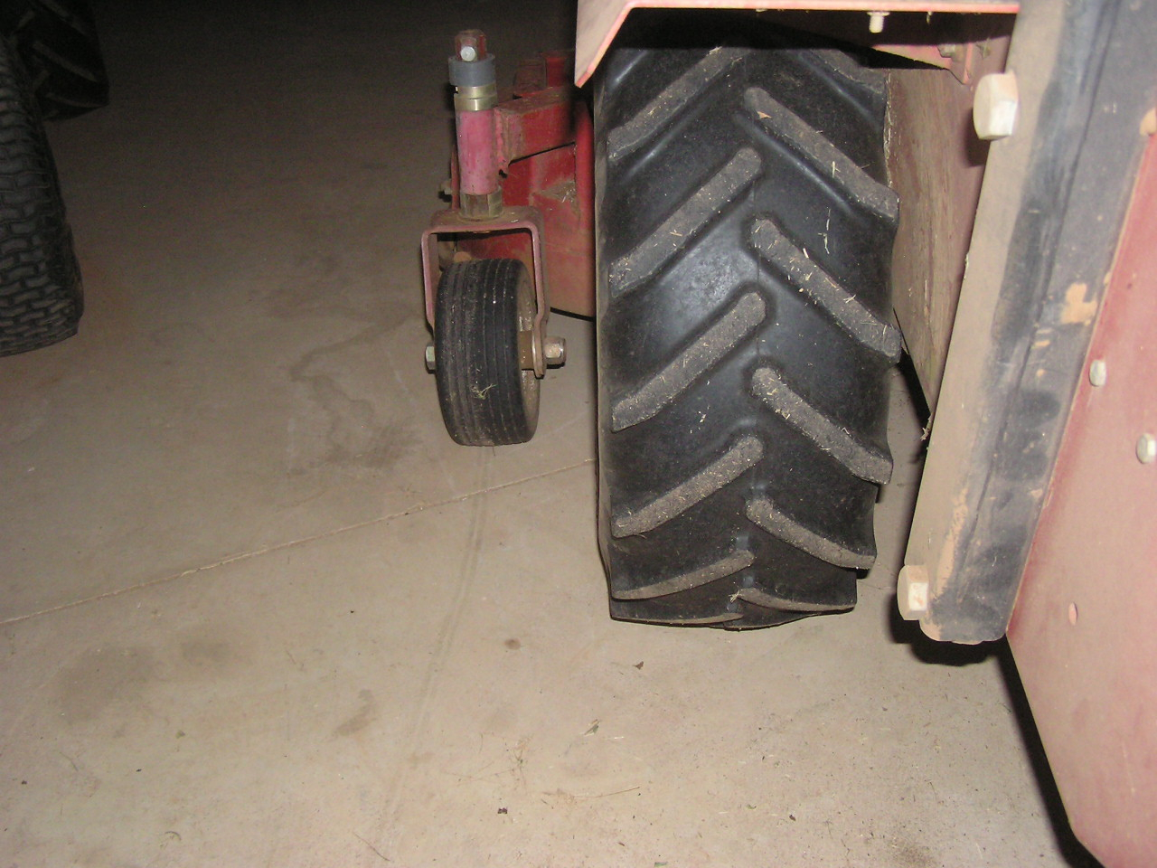

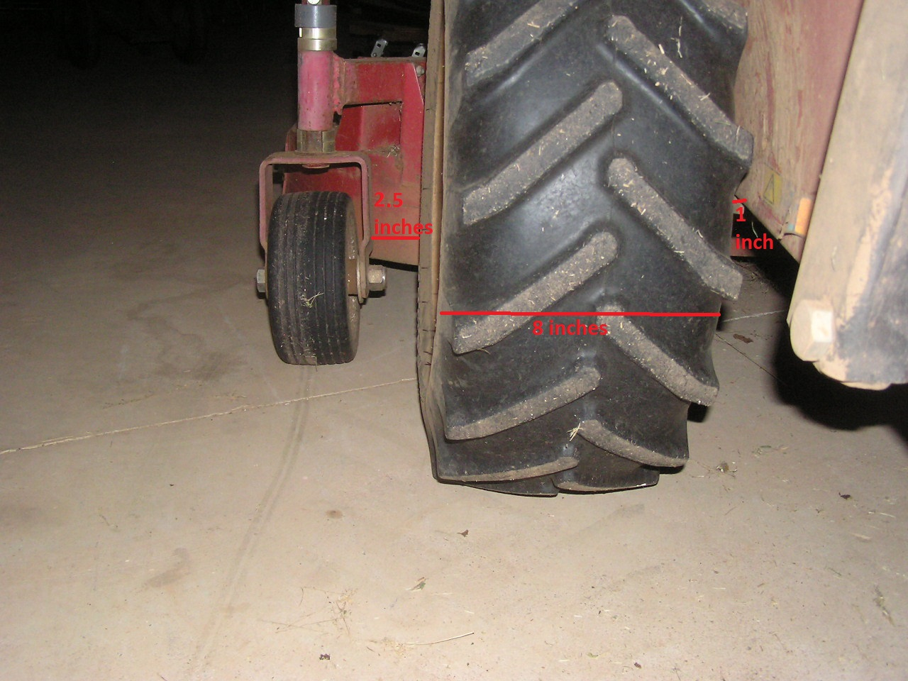

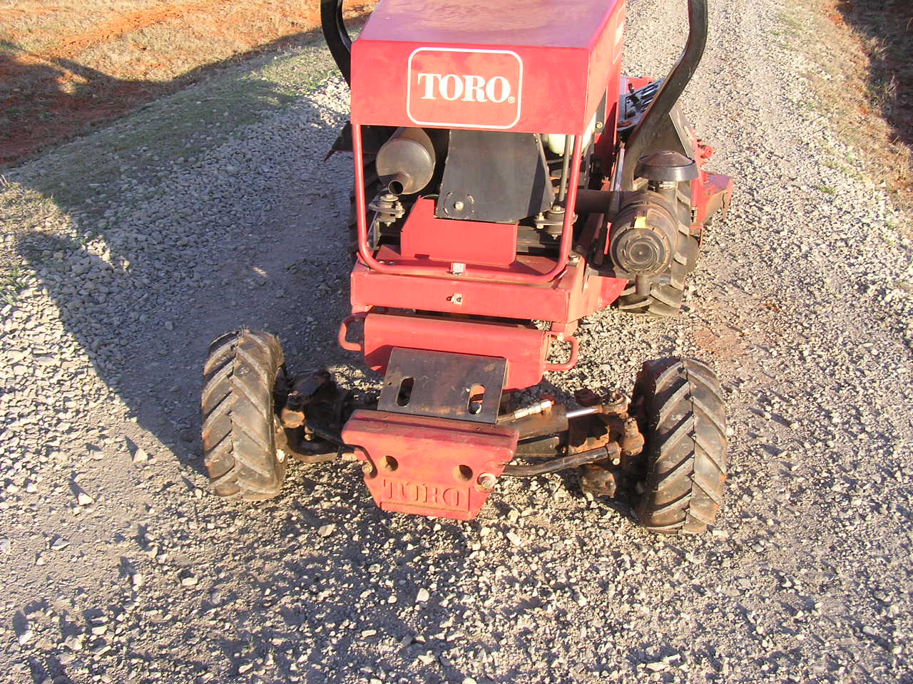

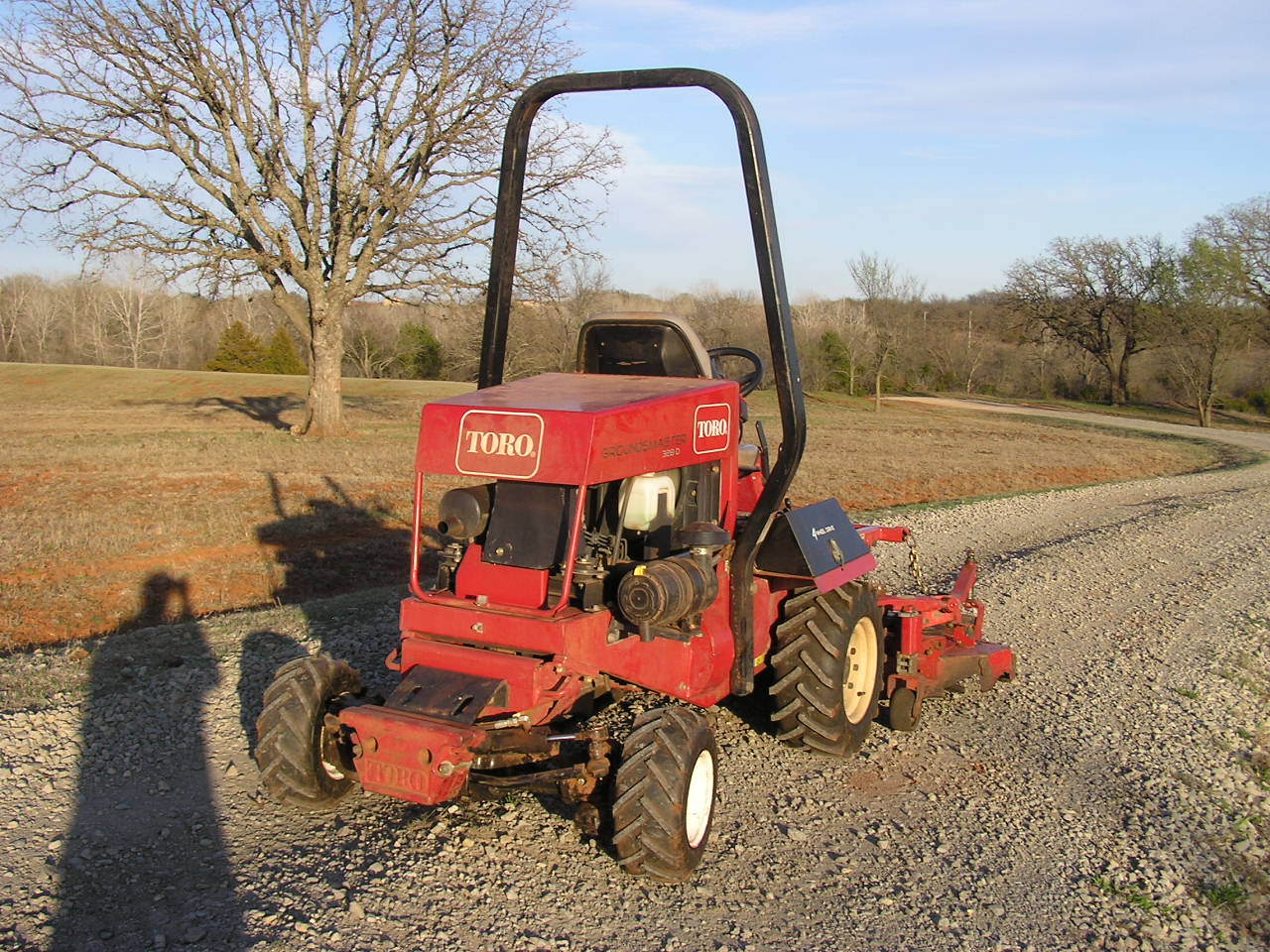

Seeing your aggressive tires on the back reminded me to ask, do you know if you can fit wider tires on the front with the mulching deck? Not that I need them, I just like the way they look lol
   / any toro groundsmaster fans on here? #947
Yes, a little wider than what I have with Ditch Witch wheels.
Depending on wheel offset, you might need a wheel spacer.

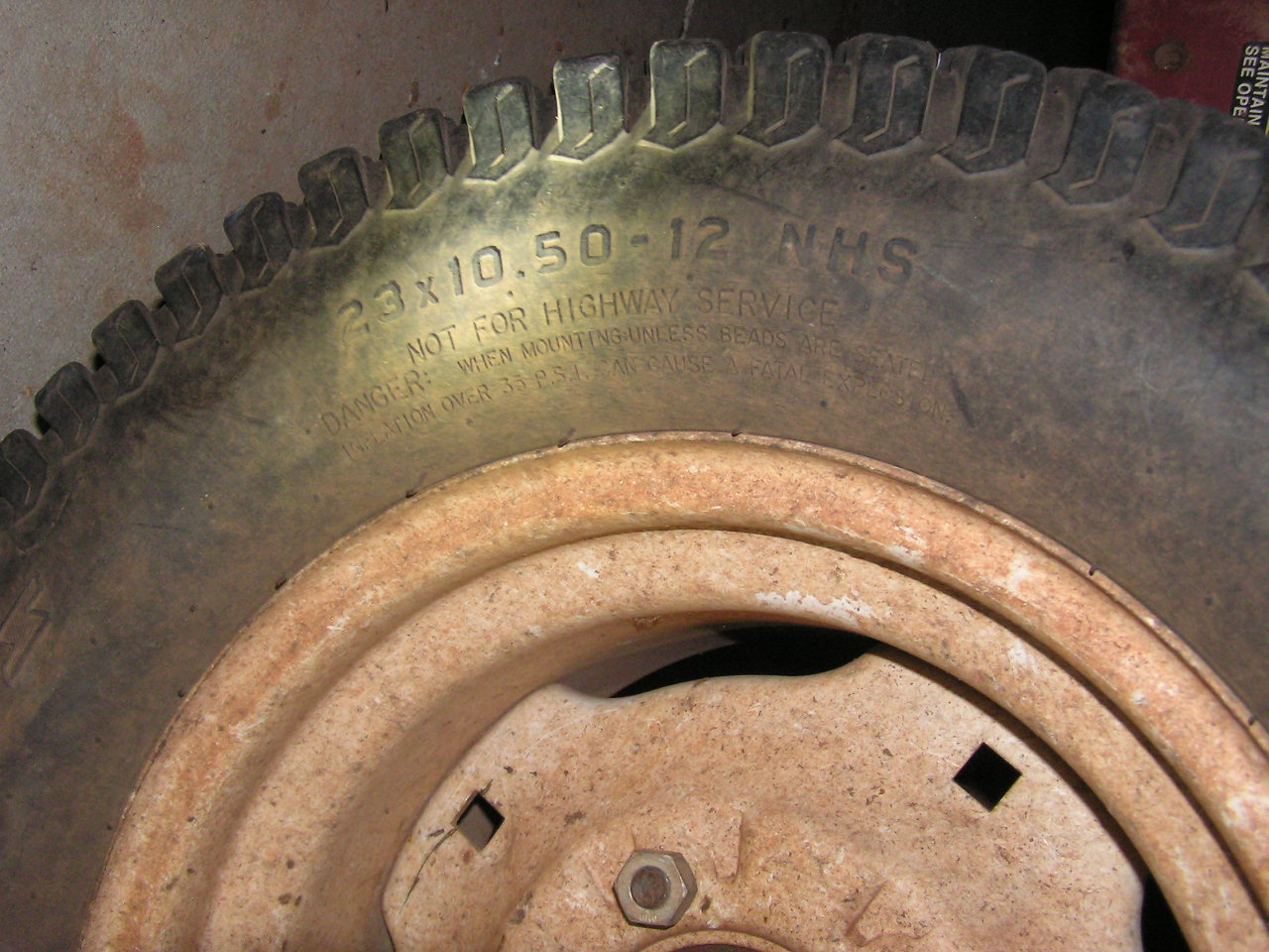

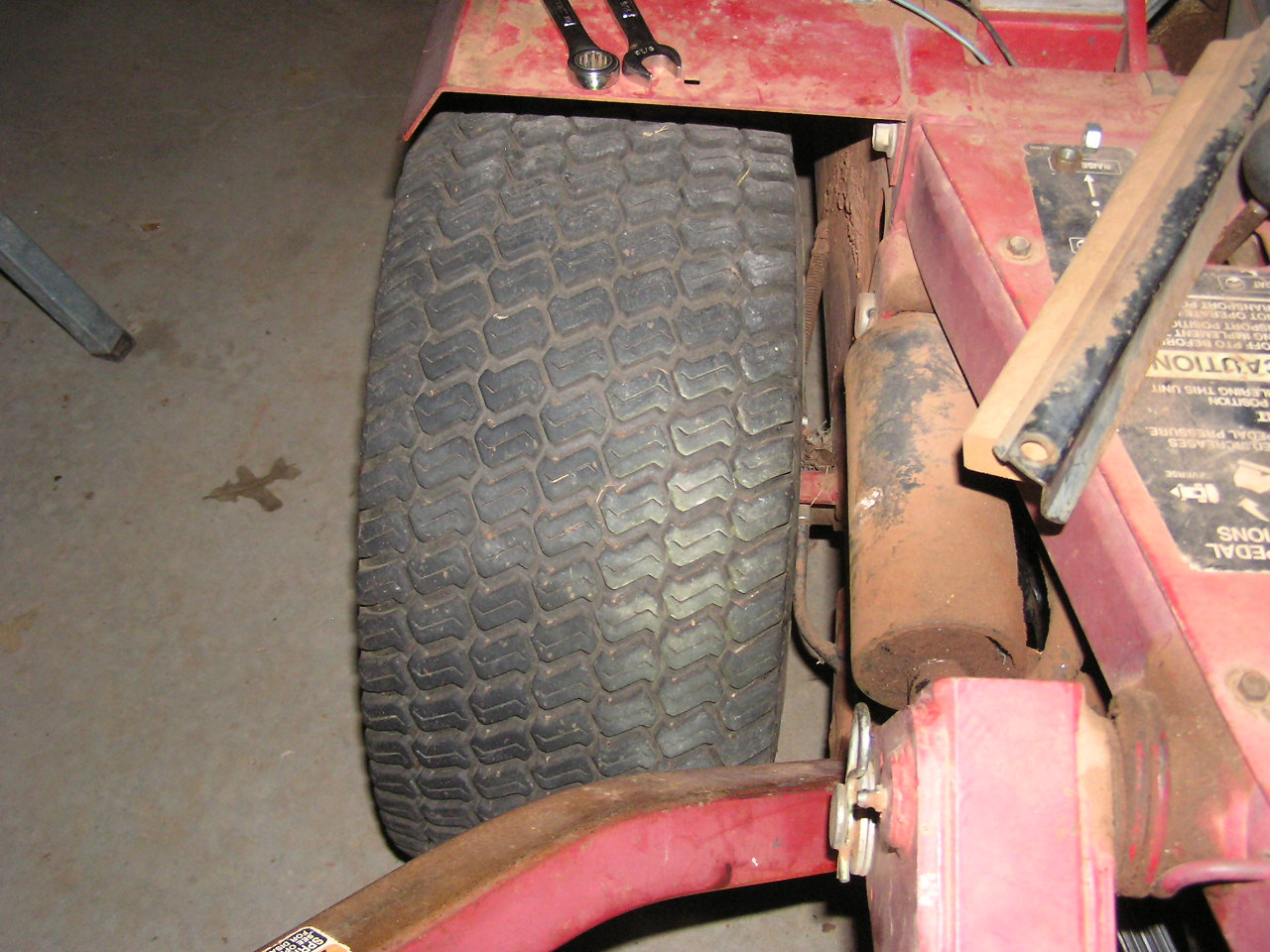

These are the tires that were on the 325D when the recycler deck was on it:
   / any toro groundsmaster fans on here? #950
I put a set of 24x12.00-12's on my one with the side discharge deck. I would love to put them on my mulcher, but there is no way they will clear the rollers. :(
