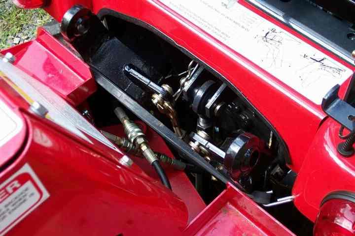

Most likely any subframe type of mount will require the lower 3-point arms to be removed or at least folded up like the GC2310. Although it is possible to design a mount that would allow the arms to stay on but that may cause the hoe to hang low or far out. I really think you be better off just getting a 3-point mounted hoe or a different tractor. You still haven't indicated the type of digging you'll be doing and the pretty much dictates what route you should take. I have a BX2200 and built a 3-point mounted hoe and it works fine for the amount/type of digging I do. I do plan on copying the subframe design the GC2310 uses because then I can leave the lower 3-point arms on.

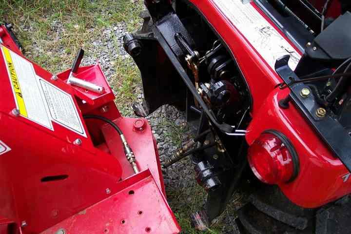

Another pic.
