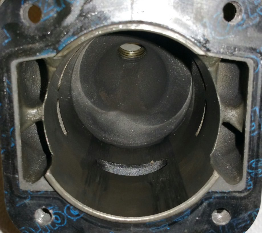

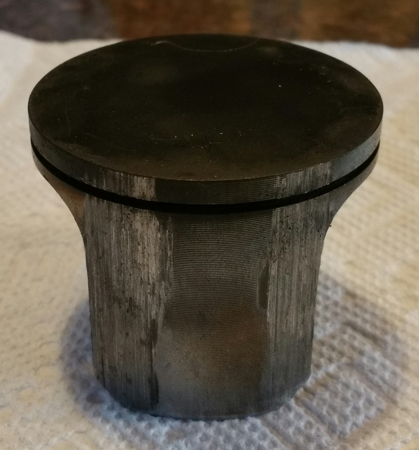

It's not my saw nor have I seen a picture yet but a friend asked me why his saw lost compression. He said he pulled the muffler off and can see grooves in the piston and ring that line up with the edge of the exhaust port. He said the saw had been sitting for a few months before he fired it up and thought maybe it could have been oil separation but he had ran it for 10 or 15 minutes before it just died. It would start back up, run for 20 seconds then die again. He did look at the plug and thought it looked like it was running fine, a medium tan color.
I thought about trying to block off the exhaust and air filter and try to pull a vacuum and see if it would hold it. He lives several states away so I don't know much about the saw (brand or size) but I think he said it was only a couple years old with very little time on it. My personal opinion would be as long as there was enough oil in the gas once you start the saw up the vibrations should be enough to quickly mix it back up but I've always made it a point to give the saw and gas can a good shake to make sure everything is mixed well.

I'll try to find out more information and even get a picture or two. I'm not sure how quickly he'll get to it as, unlike me, he doesn't burn much wood so he only uses it to keep a couple of trails clear from blow downs. Until he asked I had never really thought about it. I know my Husky 357xp is a saw that had an issue with some of them where the rubber boot that connects the carb to the cylinder would leak on early production models. I just like to learn so I thought I would ask. Would an air leak usually be between the carb and cylinder or do the seals on the crank shaft also go bad? A leak near the carb could be something that seen when removing the cylinder but the seals would be harder to check. If it ever happened to me, unless I knew for sure that it was a lack of oil, I would want to try and figure it out before dropping a hundred or two on a piston and cylinder only to risk it happening again.

Piston scoreing and top of piston is ok then it's low or no oil. Top of piston bad then it's lean out, it well also score the piston most of the time.

I would first suspect that possibly the saw was run with straight gas one time or another, and developed the grooves in the piston from that incident. The ring is probably stuck there. Easy to happen, if it sat long enough to forget, and no rigorous procedures about your gas cans, or lent out the saw?
If the wrong plug (too hot) was used in the saw (at one time) it could burn the piston top and maybe seize the ring. Lots of folks mess with spark plugs because its something that seems easy enough to do. Maybe some damage was done in the past, which failed to heal.
If there definitely ALWAYS has been oil in the gas, then suspect that a carb jet or passageway is partially plugged. Not enough to prevent starting, but was running lean. But plug shoulda showed that. Can you get the fella to look inside the plug hole, see of the piston top is all black -OR- has lighter aluminum color (burned)?

Agree the spark plug and the top of the piston should tell you everthing how the engine is running and what went wrong.

So he sent a couple pictures. The plug is dark tan on the ceramic and black on the metal.
