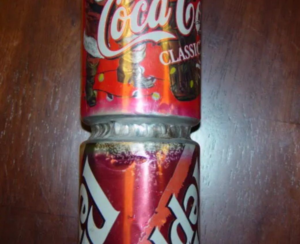

   / Any way to weld the thin metal on tractors and attachments? #20
Thin metal can be welded but most folks don’t spend the time to learn how.
Those are the people that say it can’t be done.
Kind of like a baby thinks you have disappeared when it covers it’s eyes, it doesn’t understand you are still there and it just kept itself from seeing you. It takes time to develop that understanding.
This wasn’t done with a small 120 volt machine rather a very large one turned way down.
