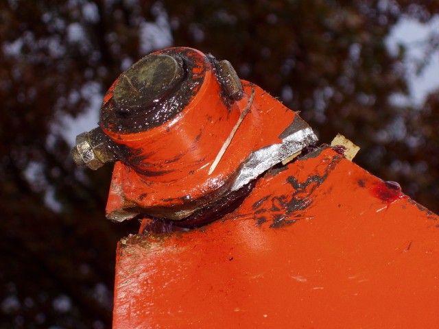

Looking for some help from you guy's that know a thing or two about welding. I attached a few pictures of my back hoe which I busted on a very stubborn Oak tree stump. This is the upper hinge joint on my BH which is completely busted through on one side and bent on the other. I would like to know what the forum thinks is the best coarse of action to tell the welder/fabricator I will contract to fix it. I am somewhat embarrassed /forums/images/graemlins/blush.gif that I pushed my beloved tractor beyond it's capabilities, so be gentle with me with your comments /forums/images/graemlins/crazy.gif

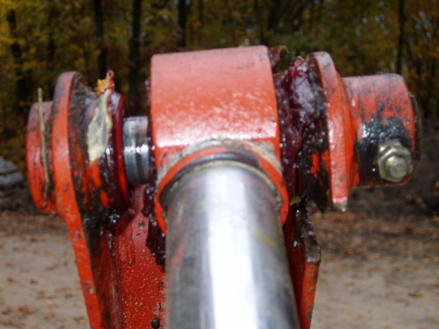

Another shot.

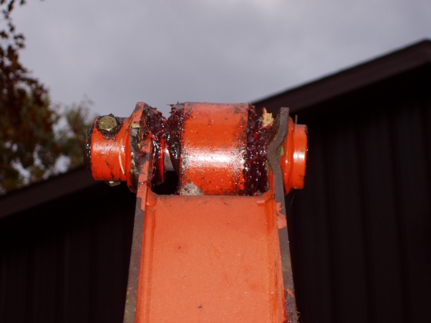

Sh-t happens. You now know where the weak link to your backhoe is. Fisrt thing to do is to straighten out the metal. The broken part will need to be ground down to a point on one or both sides depending on accessability to get the maximum penetration into the joint. I would then double up the steel in that area by placing a plate over both sides and welding it around the outside edges. You could also drill holes thru the new plate and spot weld it into place for added strength. I am not a welder by trade but have been doing it since 1971.

Would you <font color="pink"> please </font> post a picture showing location of the break.

Not sure what you mean by the position of the break. There is probably a term used by professionals (I am not one of those) that would be associated to this particular joint. Basically, this is the joint at highest point on the hoe in the closed position. In others words, right hand joy stick up and down. I do not have a picture that shows the hoe completely but I attached another side view of the break. Thanks for you help.

From a welding class that I took last year, a good welding joint is more strong than the other piece not welded. So, really, if you get a good welding joint you won't need a another plate over it.
Now, for the strength of the knuckle, a plate might give you a some more strength, but if that was the case then the manufacter should have put it in there already. I would still have the broken piece welded back then put the new plate over that and weld it.
Just looks like something bad happened.
