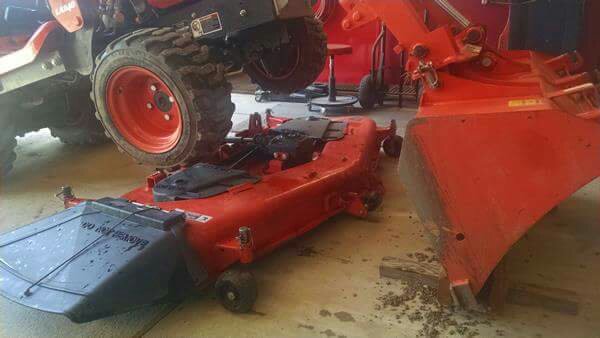

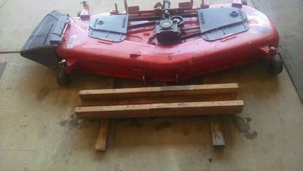

There is a Facebook Kubota group. One member posted a rig made from 2x4s that he uses to skid his BX25 forward on the bucket edge, over the mmm rather than slide it in on the dolly wheels from the side. I suggested it was looking for a blown seal or bent ram and was told it won't hurt anything. Evidently this has been done by others with no skid, they just scrape it across the floor or ground. So I was just wondering if anybody has damaged the curl cylinder and how did you do it? I would point back at this thread in reply to the message.
What stories do you have gentlemen?

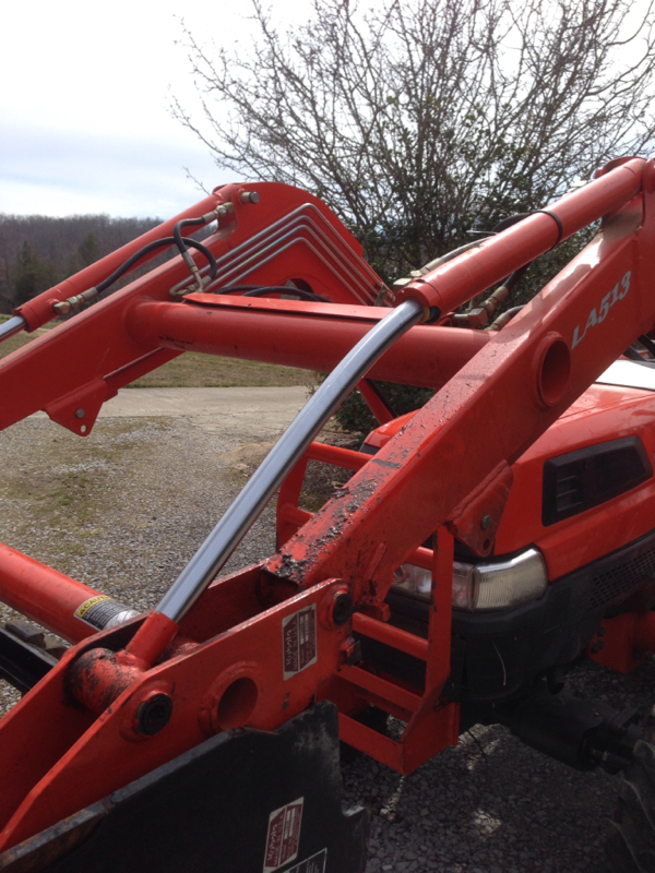

Everything is opinion, right ? But I do not think you can blow a curl cylinder or hurt the ram that way. I have a BX2200 with the LA211 loader, a B2150 with a 3rd party loader and an 81hp MF with a MF DL250 loader. I have used all 3 of the loaders many times to lift the front of the tractor for various reasons. Sometimes digging in hard soil both fwd and reverse with the full weight of the front half of the tractor on the bucket tip (which is NOT recommended.) I admit that once I put so much pressure on the large MF (preparing a building site) that I split a steel hydraulic line on the loader wide open and sprayed myself with hot hydraulic fluid. But it did nothing to the cylinder or the ram. My thought is that scooting the tractor along on 2x4s on the bucket with the front end up in the air is light work for that loader. In my experience the hydraulic cylinders (seals, rams, fittings) will stand more than the things around them. Some (most?) have excessive pressure relief valves, etc. too.
Picture of blown line attached below. It was nice and snug up against the loader frame before it blew...

My buddy blew one. He was back dragging with a set of pallet forks all the way down. image-2863514990.jpg

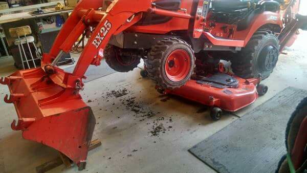

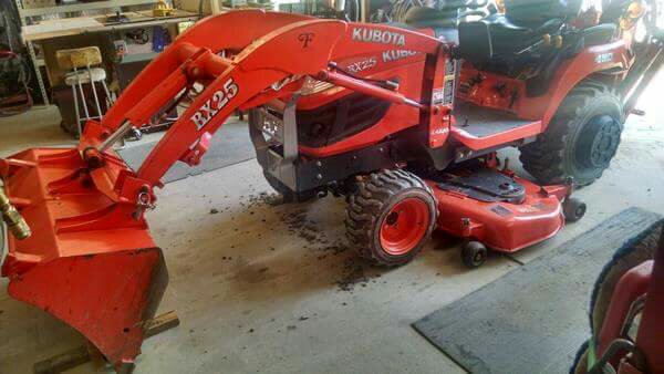

Here are 4 shots of the rig in use.
I could see how this would be a lot safer than the bare edge, but still strikes me as risky.
If the boards slide easily across the floor, probably not too much risk of harm. Conversely, if there's a lot of friction (think of doing this on a gravel driveway, for example), the resistance to moving forward could be a problem, and if the bucket were tilted more vertical or past vertical, that would make it worse.
An improvement would be to use a dolly with casters instead of the 2x4's. Adding a couple of stop blocks to the dolly would prevent the bucket from sliding off.

My buddy blew one. He was back dragging with a set of pallet forks all the way down. View attachment 467423
That is bad stuff. I had never seen that kind of damage but as you've shown (and other posts by ch1ch2 and bobmisi) it can happen. I don't think Raydakub is in any danger of that kind of damage lifting the front & skidding on 2x4s to get over his deck but as Grandad4 says I wonder if it is really worth it. I just don't have that much trouble scooting my deck in sideways.
