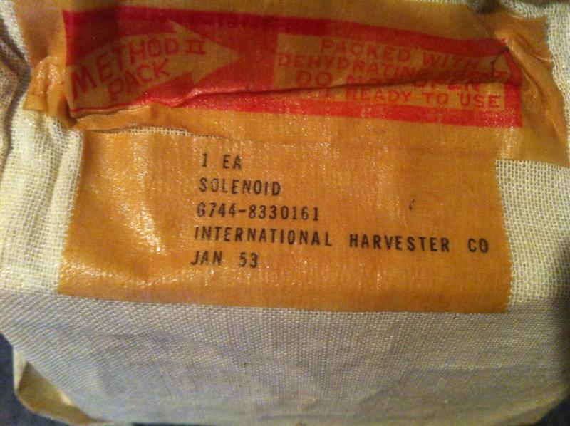

Interesting tractor part note, I recently replaced the air horn solenoid. The part I ordered from a surplus shop arrived sealed in foil, manufactured by International Harvester Co in 1953! (see pic) The solenoid works great!

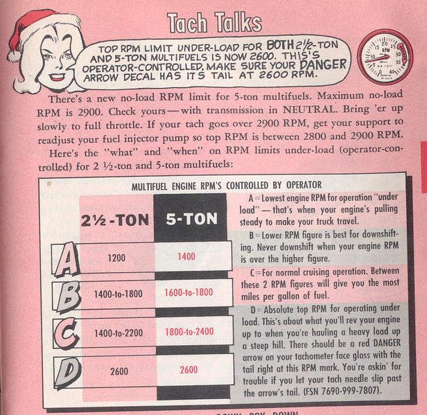

I did "learn" how to drive a standard transmission with it. I don't profess to be great at driving stick but I've never stalled it on a public road or broke anything (yet). I do make it a point not to ride the clutch and study the rpm and road speed shift points (see pic). Its pretty much impossible to stall it when starting out with the transfer case in low gear. The military says not start off in second gear, so I don't. The transmission weak points seem to be second and fifth gear, I think its because people start in second when they shouldn't, and maybe miss second by mistake and hit fifth. Note, on the Spicer overdrive transmission, fourth and fifth gears are switched like this:
R 2 5
1 3 4

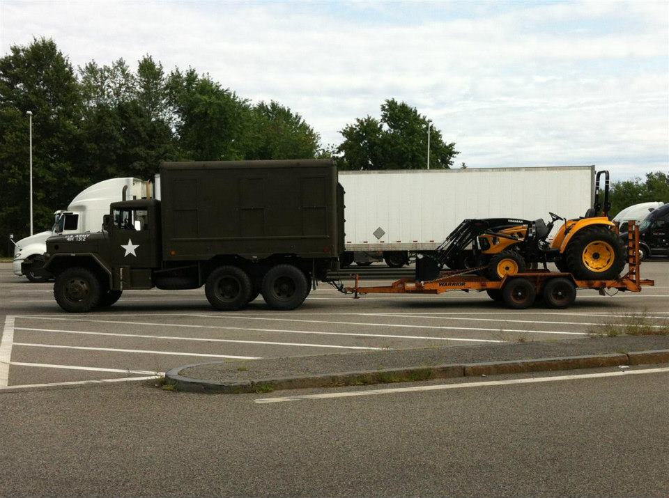

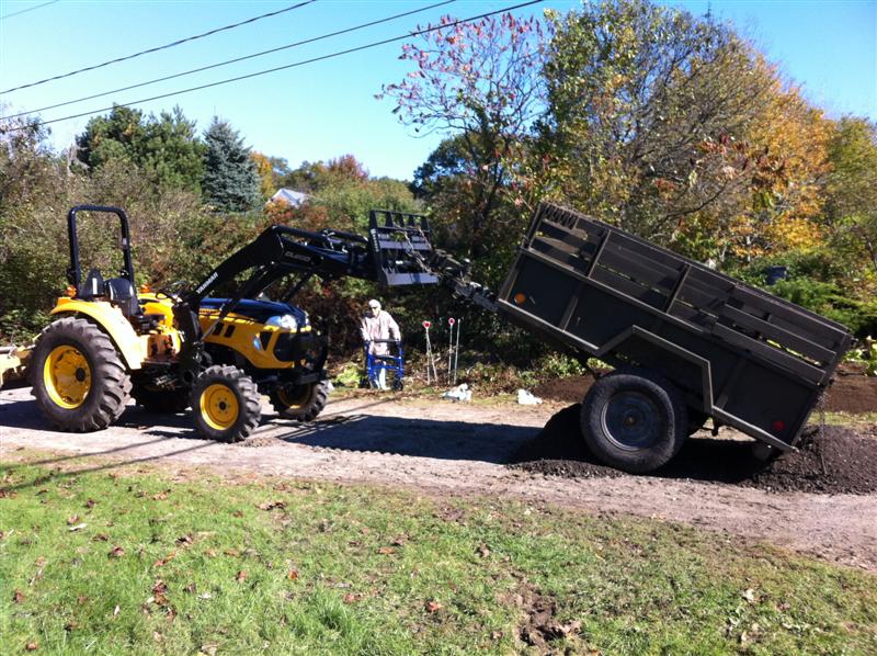

I'm just starting to enjoy driving it this year, I've maybe put 1200 miles on it this summer. I installed a Reese hitch and 12 volt brake controller and trailer wiring just so I could use the deuce pickup my new Yanmar (200 miles round trip). Its a bit slow on hills, but it'll do 55mph on the flats. It gets about 8miles per gallon on a fuel blend of waste oils, gasoline, and diesel. Do I like driving it? Yes, but I also like getting back behind the wheel of my daily driver 2004 Jeep TJ with its automatic transmission!
Note, I chose to buy the Yanmar new because if I spent any more time fixing up another rusty project, like the deuce, I'm pretty sure my wife would divorce me...
