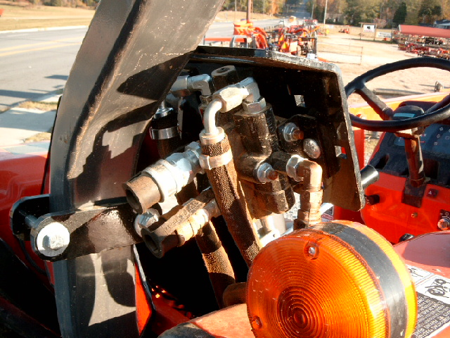

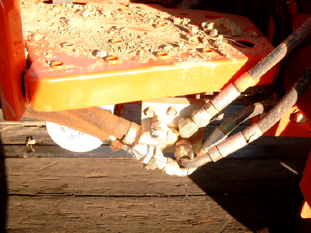

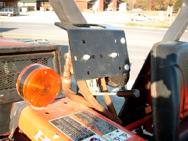

Pics of the Kubota BL7303 valve and L7314 hose kit mounted on a customer's L3400.

Todd:
Thanks for the pictures.
I noticed in the third picture that the existing PB hose from the loader was joined to a host (presumably provided in the kit).
I was planning on just replacing this hose but if I can get away with just unioning it then it would save me some dough.
I imagine that a new hose would be better but a union works.
   / Anybody have a L2800/L3400 with remotes AND a BH? #14
Mine had that bracket and about six feet of more hose than needed.
I didn't like it so i fixed it to my liking and accessing the hyd filter is easier also.
This kit is for one without a BH.
