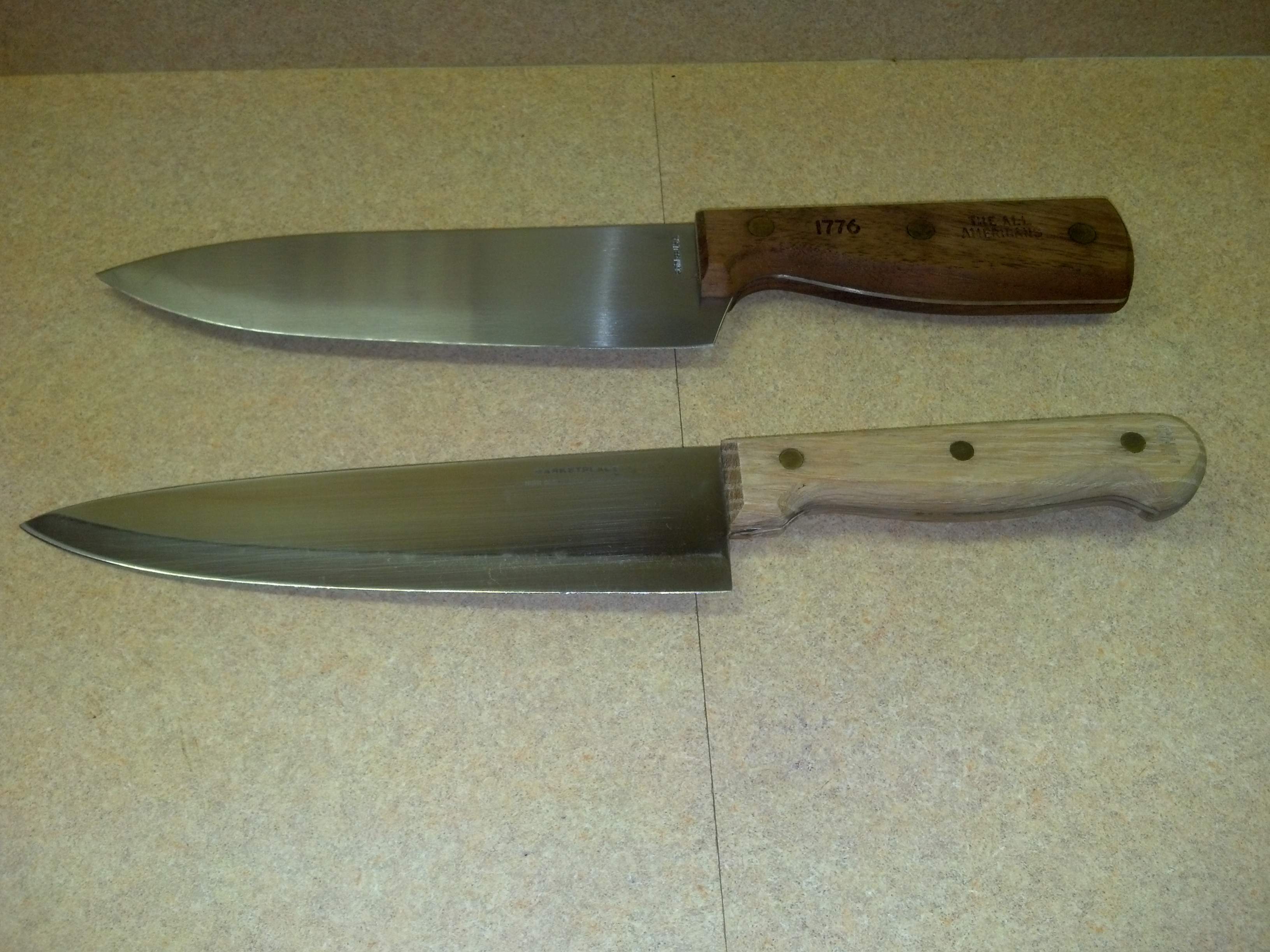

Anybody know the best way to renew wood knife handles?

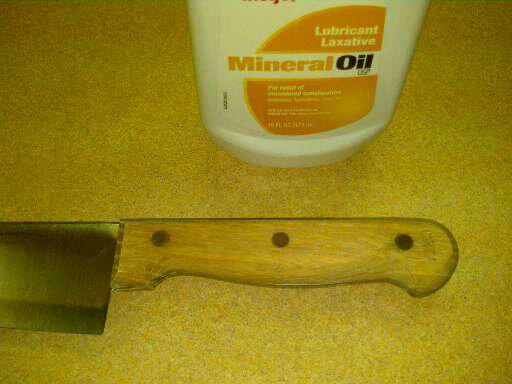

... vegetable oil....I would not use this it can go rancid and they you are touching this with your food or touching your food after using them. You can use hazelnut/walnut oil but mineral oil is going to be one of the safest and least expensive.
If you want more of a gloss you can buy a http://www.rockler.com/product.cfm?page=5344 salad bowl finish but its almost $20 a pint where I spent 2.50 on mineral oil.
I sell spoons, bowls and cups that I carve and I use mineral oil on them since there are studies out there showing its effectiveness, its food safe, and its something that when it wears off you can purchase at any store to restore to the original look.
From Mineral oil - Wikipedia, the free encyclopedia
Because of its properties that prevent water absorption, combined with its lack of flavor and odor, food grade mineral oil is a popular preservative for wooden cutting boards, salad bowls and utensils. Rubbing a small amount of mineral oil into a wooden kitchen item periodically will prevent absorption of food odors and ease cleaning, as well as maintain the integrity of the wood, which is otherwise subjected to repeated wetting and drying in the course of use. The oil fills small surface cracks that may otherwise harbor bacteria.[12]12.^ Barbara Ingham (October 2007). "Care and Cleaning of Butcher Blocks and Wooden Cutting Boards". Food Safety & Health. University of Wisconsin–Madison. http://www.foodsafety.wisc.edu/asse... Butcher Blocks and Wooden Cutting Boards.pdf. Retrieved 2009-07-12.

Finally remembered I was supposed to post an "after" picture...I ended up using mineral oil, I did price that special oil sold for salad bowls, etc. and it was something like $13 for 4 ounces...I soaked the handles in a jar of the oil overnight and it didn't change the color much but the wood looks a lot better. Thanks to everyone who gave me the tips.
