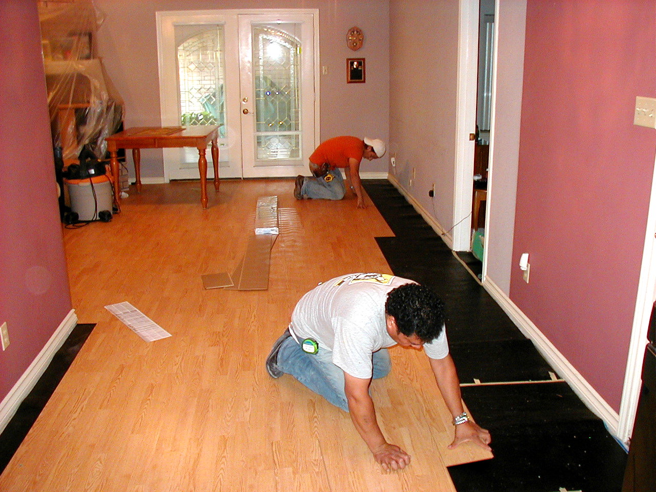

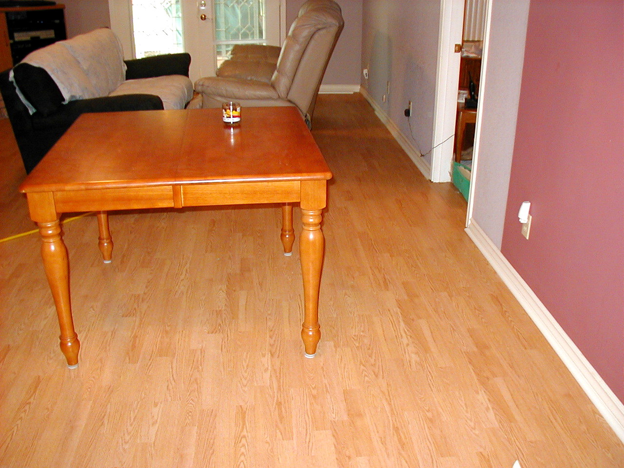

We had some carpet removed and Mohawk instaloc laminate put down in July, 2007. So far, so good.

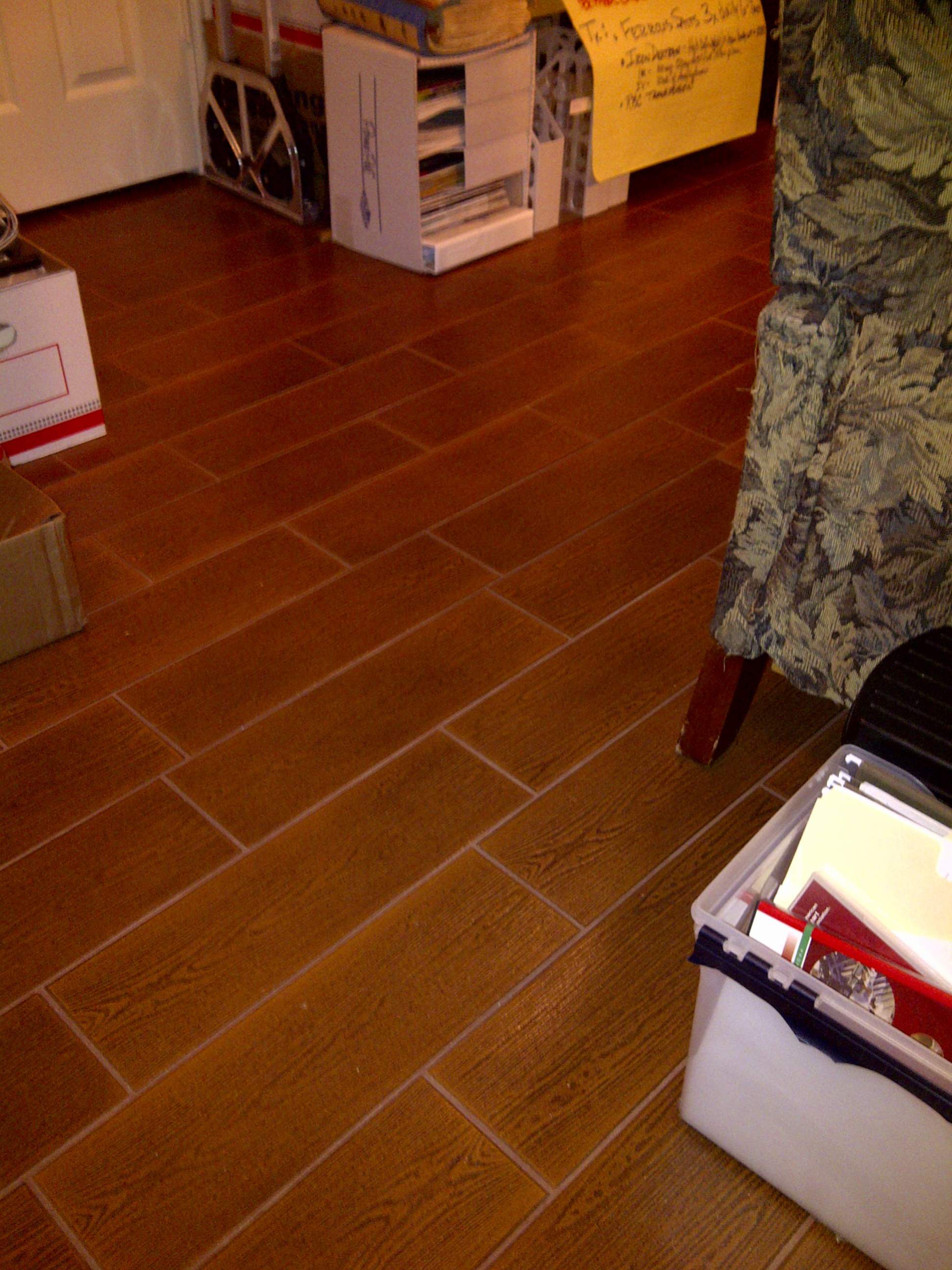

We went with the ceramic tile in our office and living room. Easy to keep clean and does not scratch when I roll around the chair.
