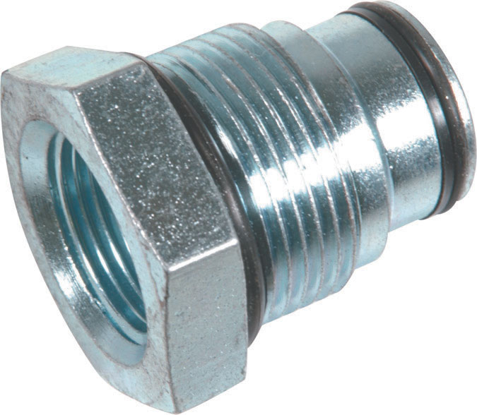

To check to see if the adapter in the C port is a PB adapter, remove it and see if it has two o-rings.

This is how a PB adapter should look.
