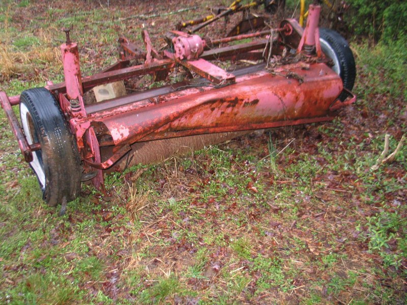

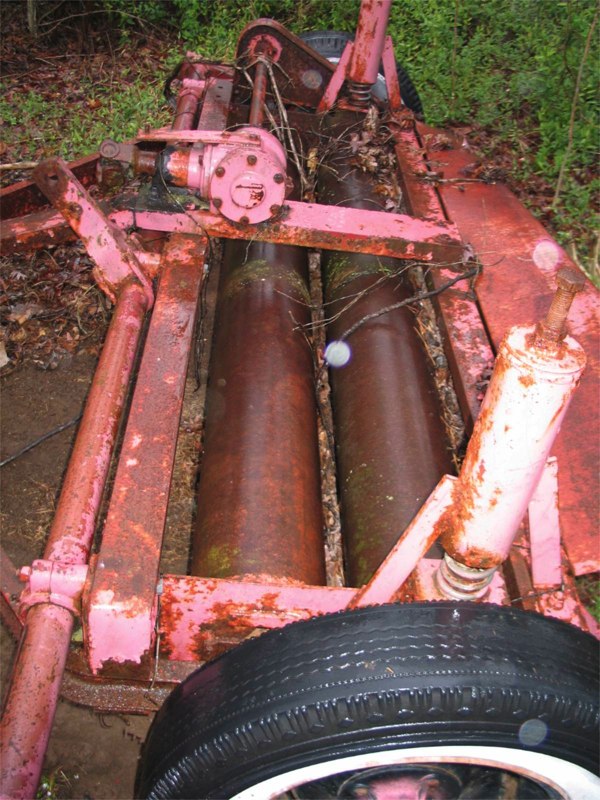

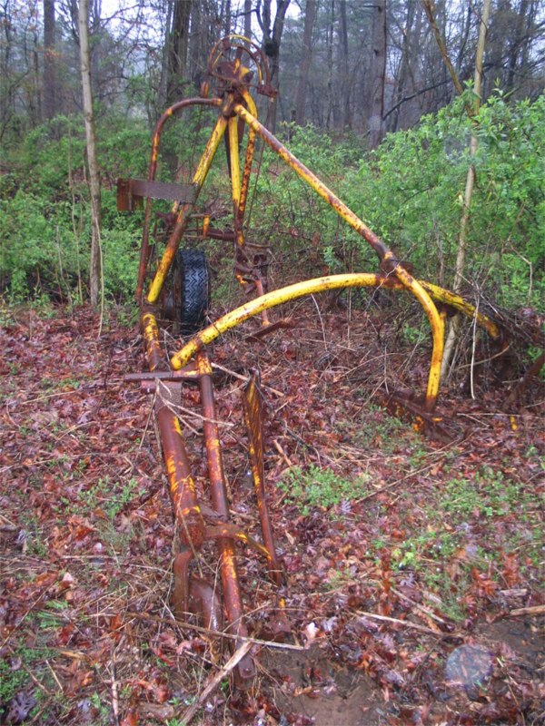

Maybe you guys can help me with some pieces I'm not sure if they are worth resurrecting.
Three photos below.
Number one and two is I think a conditioner
Number three is a bale tosser of some sort
Number four is hard to see because I was taking a picture of junk but in the middle back to the right is some sort of conveyor - I think for hay bales - I haven't worked my way back in there to get it out.
Any help on any of these pieces would be appreciated.

RVAITOR, picture #3 I believe is a Snowco square bale lifter to be used with wagons or trailers. I saw one a few years back at a used equipment jockies lot. I had to mess with it to try and figure it out. I figured out the principal of how it was supposed to work but do not know if they worked very good or not.
