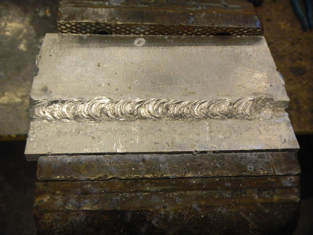

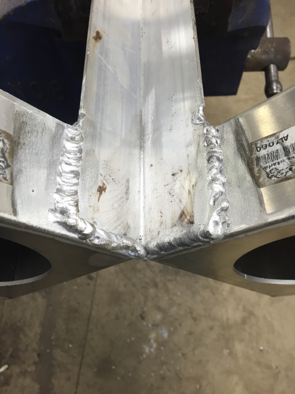

Has any one had any experience stick welding aluminum. I'm no professional by any stretch of the imagination, but I wanted to build something out of aluminum but with the price of a spool gun and gas I decided to try sticking it. It seemed to work not too bad but it was definitely very unpredictable, not at all like I'm used to welding steel.
This is my "best" work. I won't show you the other side. It seemed to be determined to jerk me around.

STICK WELDING ALUMINUM SUCKS, I DO IT TO GET CUSTOMER OUT OF A JAM UNTIL THEY CAN BRING IT TO THE SHOP TO GET TIG WELDED.

After 40 years of welding as a pipefitter and nuclear certified;aluminum stick is about the most difficult there is.I very dislike welding any form of aluminum but "Tig" is about your best bet.

I played with it just a little bit. I had the best luck with a little pre-heat. Boy you got to move fast! :shocked:

Couple things to make it easier. Must preheat to 500 degrees. Turn on acetylene and smoke the area to weld. Turn on oxygen and slowly heat the smoked area. When the smoke on the plate is gone that is approx.500 degrees. Aluminum stick rods need to be ran in a near vertical position which is difficult because the rod burns up very quickly and if the material has any oxidation you will get porosity. Practice is important. Lastly, Aluminum stick rods work better as Aluminum brazing rods. Try that too. Good Luck..
