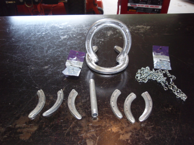

   / Anybody stick weld aluminum? #17

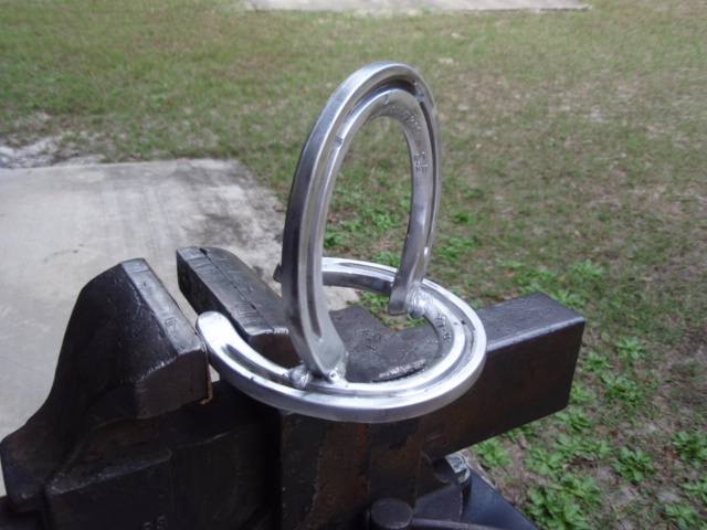

   / Anybody stick weld aluminum? #18
