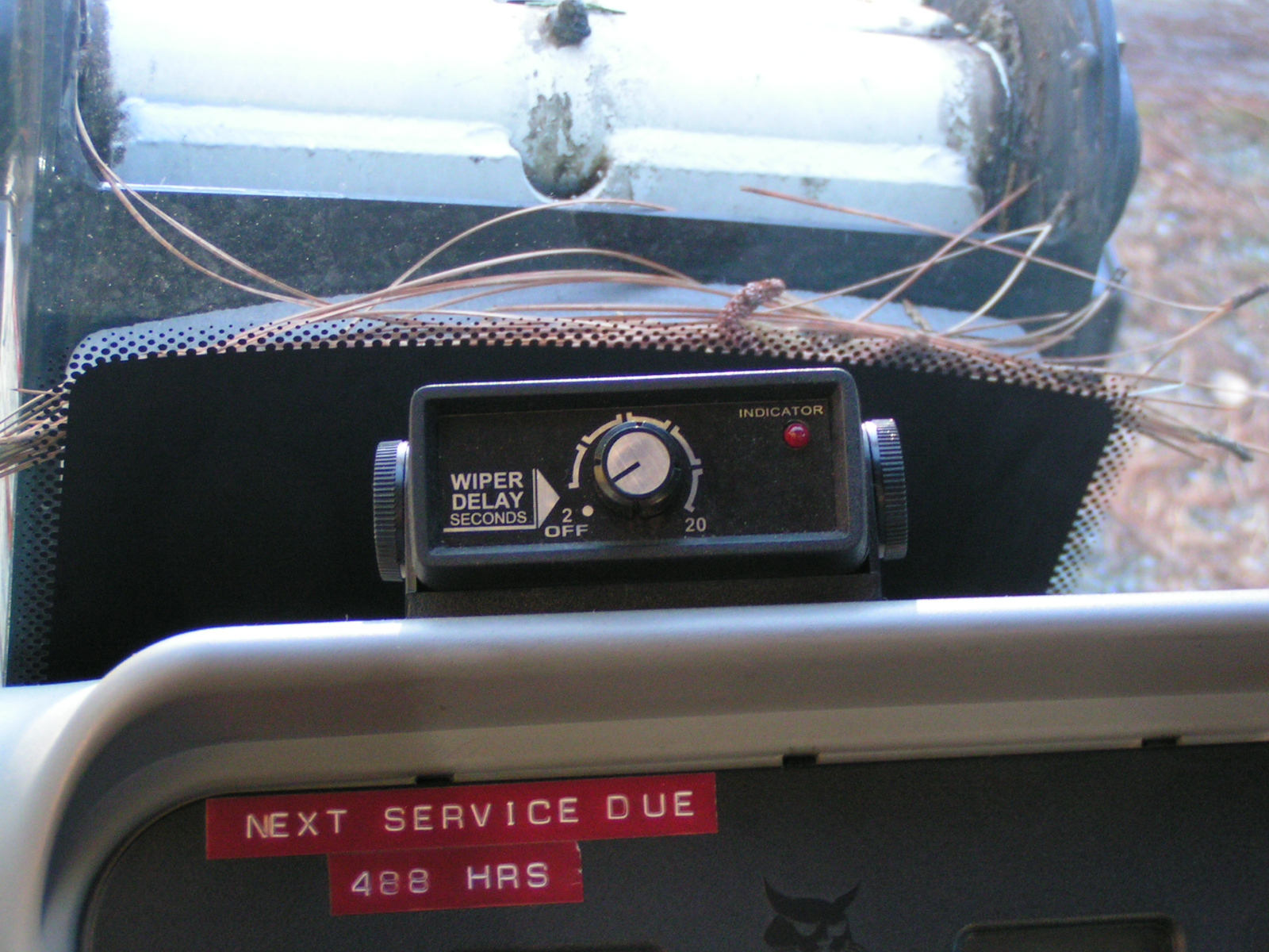

Other than a tactical potato launcher, the thing I miss most on my Toolcat is a control that would allow to me to vary how often the wipers sweep the windshield. There are various aftermarket controls available for cars & pickups and I'm seriously thinking about trying one on my TC after this snow season. Has anybody here tried installing such a control on their TC?

I have an intermitant wiper control installed on my newest TC. It is an after market unit that the dealer installed for me. I don't believe it was very expensive. If anyone is interested I can take a picture and get the manufacturers name. I think it has delay settings that run from 2 to 30 seconds.

If you could post the mfg (and pic if you get a chance), I for one would certainly appreciate it. I've found several kits that seem bent towards a generic install (cars, pickups), but that's sort of a hit and miss proposition.

Tried to get a picture tonight but it comes out way too dark. I will try tomorrow while I'm doing maintenance/prep for the next storm. I did try and find a manufacturers name (with a flashmight) but could not find one. The way it is mounted I may be able to see it thru the windshield during the day. I'll let you know what I find in the daylight.

I'm attaching a picture of the wiper delay unit. For the life of me I can't find a manufacturers name. I even removed the unit from the mount and still no name. It must have come with two "face stickers", one with the brand name, and one without. Hope this helps.
