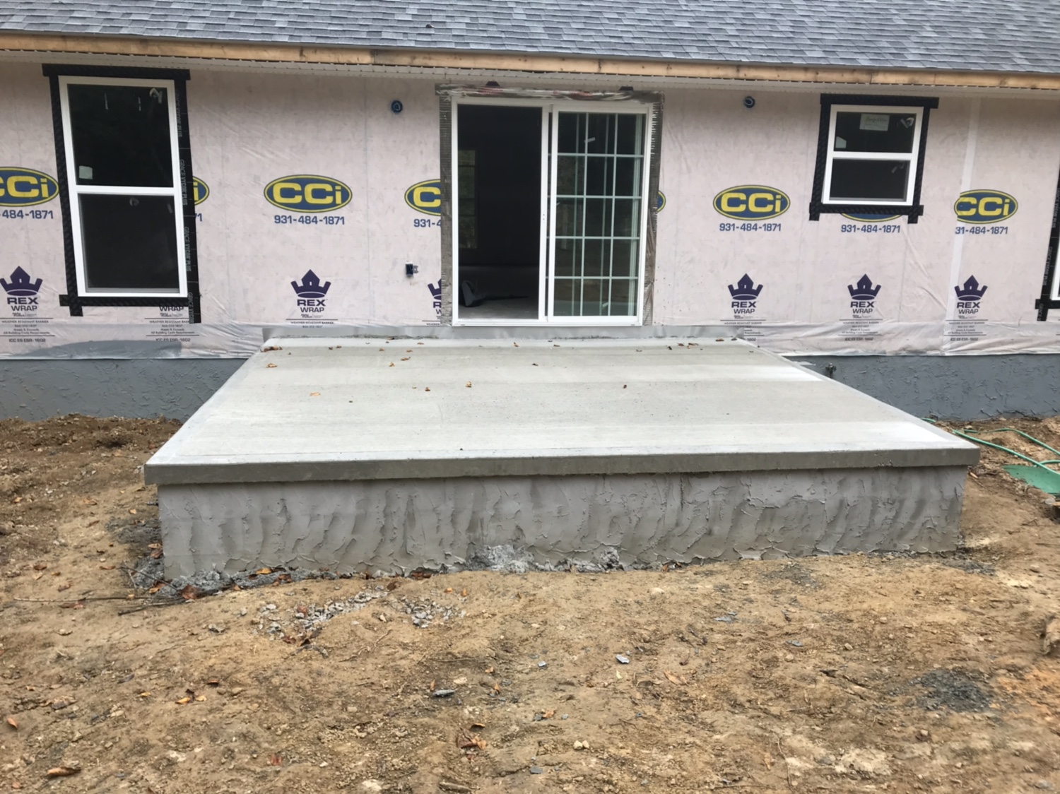

Pressure treated has gotten so expensive I abandoned the whole idea. IMG_9146.JPG
