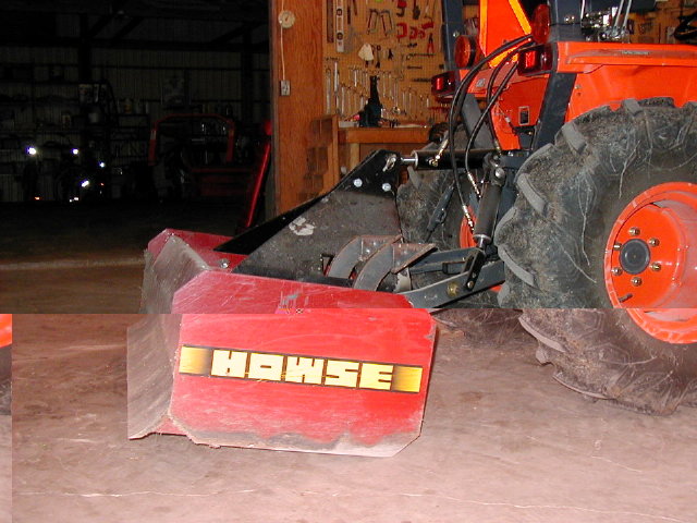

Bill, I just ran through those two old threads, and you'll notice I had a lot of help from MChalkley, LarryT, kubmech, and others. And it appears that the pictures I posted are still there, but not those of RobertN and LarryT. Incidentally, LarryT had an even better set up in my opinion than I did.
The only pictures of mine that I didn't find (probably there somewhere; maybe in a different thread) are the ones showing the box blade tilted all the way forward (the above attachment) and all the way back (next post).

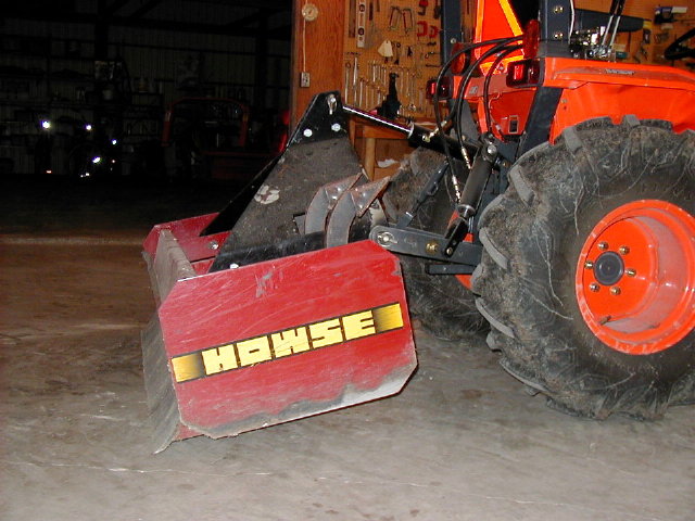

Box blade tilted back.

Bird, in that picture, the tilt cylinder looks longer then most. As was mentioned, one thing that will happen with double tilts is the extreme angle not only often can exceed the lower links and implements ability to handle it, but with an implement like a box blade, if you catch an immovable object like a rock on the lowered corner, their stresses are enough to start tearing things up since the load can be concentrated to to just one lower link. The problem is compounded when for example, in this extreme configuration the lift arms don't even need to drop to engage the implement thus eliminating the "float" that is inherent in most 3 pt set ups. When the travel is eliminated and you encounter a stubborn object, the weight of the tractor also comes into play which can be good and can be bad. Perhaps my greatest reason and as MChalkey told me years ago, having two tilts has some advantages, but getting the setup level can be a pain especially since most all tilts will sag over a relatively short time. I suppose they are more prone to it because of the leverage working against them. Good posts as usual Bird, Rat...
