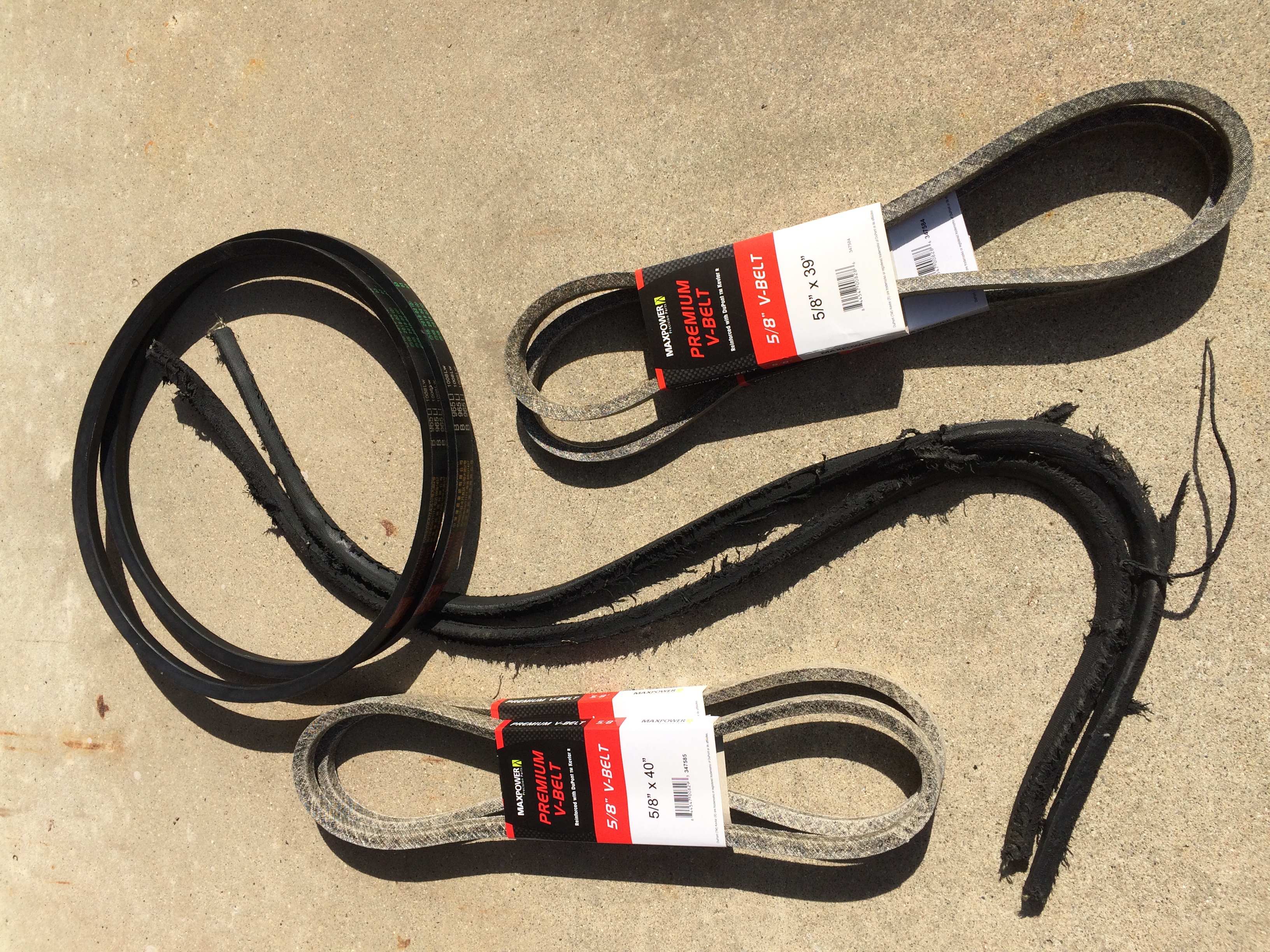

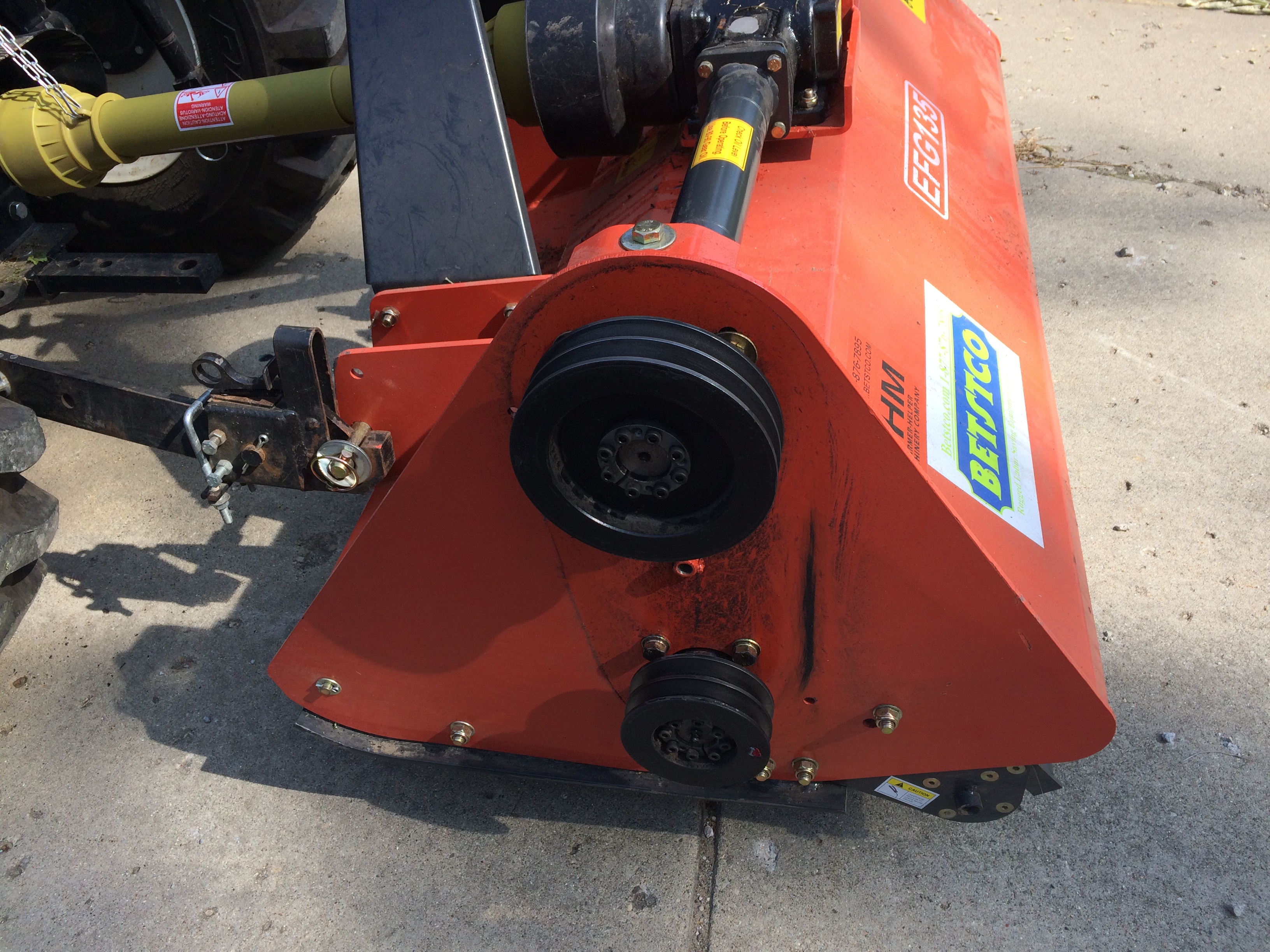

Burned the first pair of belts on my new 53" cut Betstco. :eek: Turns out that a rotted and forgotten, decades old HFT tarp was embedded in weeds next to a stack of round bales.
'Trainer' says, "we don't have tarps out there". I say there's a dozen pieces of one out there now, and forensics will reveal cutmarks from my 2" pocket knife. :laughing:
Anyway, rotor was stopped cold and quickly. If I pushed in the clutch in <5 seconds it was still a bit late. I could smell rubber already. I cleared it and turned back toward my place. Dense clover grows alongside that lane to the hayfield, lush and green. 4-5' high was a bit much for even my casual pace (I troll Storm Hottentots faster, ~2- 2 1/2 mph) and things got wrapped on my roller within seconds on a retry, so I knew there was slippage and belts sans spring- tensioner were already toast. As soon a I lowered I could tell tha right away, and returned to the shop.
Belts were shredded, so much mat'l lost that they looked like they were inverted on the pulleys, but they weren't, just kinda sideways. I cut off the two 'B' belts easily with HFT metal snips like they were scissors. (compound-cut type w/yellow poly handles)
I did buy a spare set of belts with my order. (advised for new users who, like me, wreck more stuff helping neighbors than on their own patch :rotfl:) They're not cheap crap, but before I shredded the writing off them too (future cross reference) I took a spare to FF&H to match-up for replacement. Guess what. No 'exact match' in stock or listed. OEM belt is 39 1/2", store had 39" & 40" in Kevlar-wrapped, $16.99 ea. I'm sure HD or TSC would have similar, & I'll try 'em all i dont' get luckier.
As for performance, I'll have to add pics of the fantastic job this does with ease, and 28 rated PTO hp. Olive, honeysuckle, sassafras, buckthorn, blackberries, locuts .. I'm cutting across/thru them at a 'medium' walking pace with leg-wetting ease and results. Anything up to 1" or so at the base & <11' tall might as well be knee-high grass. Dried and forgotten twig piles alongside my road were ground up with the live 'fishingpole' sprouts that disguised them.
I'm not taking any chances with greasing. My work sessions will be a few hrs per, and only a few times/year, backed up by neighbors' JD 5420 4WD shuttle and Land Pride HD 7' BH since most will be on their 60. My cutter doesn't leave hay-rows where they're clearing for a food plot. Trainer's 2 girls want riding paths on the fallow fields surrounding their hay patch. They're Morgan breeders and all three fine Ladies give riding lessons. I'm anxious to do more for them with the mower.

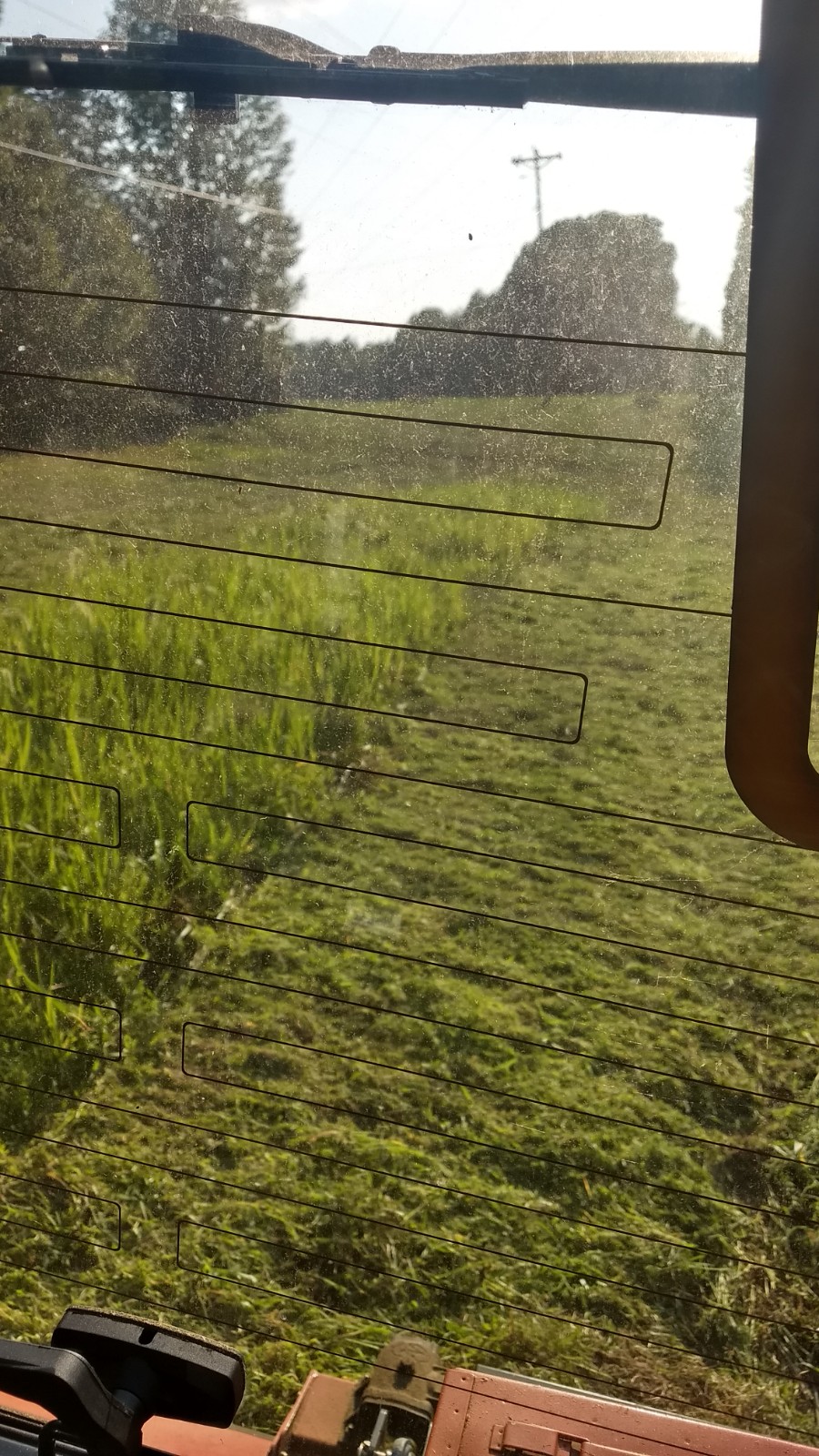

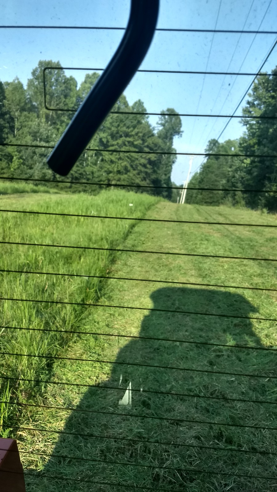

Thought I'd update after adjusting my rear roller height and top link again, I was able to get a great cut first time through AND was able to pick up ground speed with my farmer's helper. Here's a few pics field mowing tall grass mixed with foxtail and lespedeza. Some of the areas were just over the tractor hood. Will try to post a video showing that shortly.
Again, I currently have the scoop knives installed- not the Y blades.
