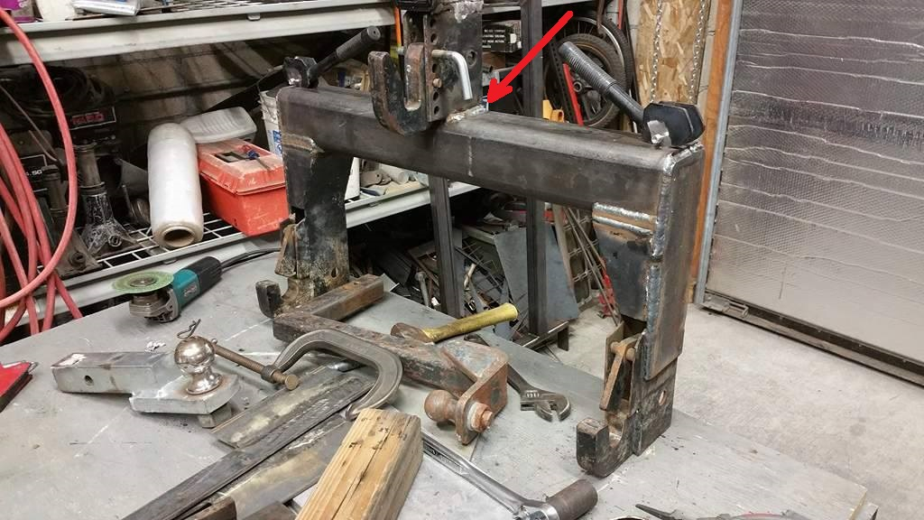

Broke the mounts for the top hook off of the cross member. Replaced with 1/2" thick tube steel, going strong after several years
Was pulling Land's Pride Rock Rake, 43HP Kubota.

My old QH hadn't failed, but I got tired of playing chicken with it. There were cracks from the lift pins through thee frame horizontal to the ground. Lift pin holes were a fair bit worn & bigger than they use to be as well. Ran it for a season after finding the cracks & wondering if I'd break before it did. It won.
No regrets working it hard or replacing it. I may get motivated to weld up the cracks & keep it as a spare. Or just keep it around un-repaired for who knows what. With my low welding skill & the worn holes it wasn't worth it for me to repair.
