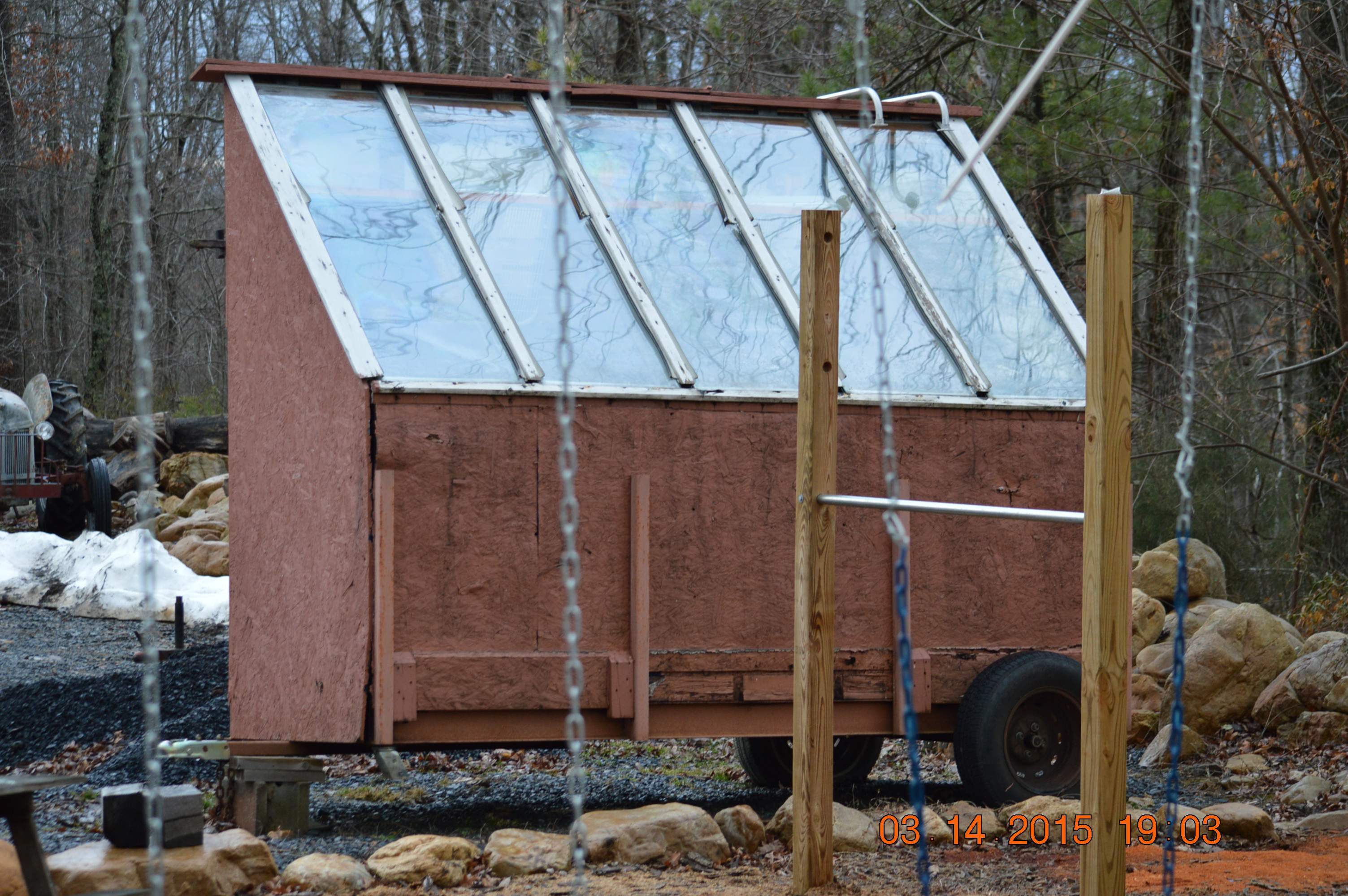

I made a small solar kiln with wheels for drying lumber... I also built my own sawmill is the reason I built the kiln...
I saw very little lumber so at least once or twice a year I fill it with split firewood... simply because it is setting there empty..
Can put a stack in it about 2' wide, 3' high, 9' long... about 54 cu ft.. slightly less than 1/2 cord...
Takes about 2-3 weeks in the summer and it is plenty dry...
Built it similar to the VaTech solar kiln plans, but much smaller...
Reason it is on wheels is to turn it out of the sun to keep it from overheating and park it out of the way when not actually drying anything..

Pappy60, that's exactly the kind of thing I'm looking for. What are the overall dimensions? 1/2 cord would work for me as well. Are you using electric fans? Using glass glazing or something else? I was planning on just using a solar powered fan and splice in a thermostat.
