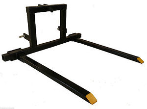

Titan 3 point hitch Pallet Fork Attachment Category 1 tractor carryall 3PT-PF
$295.00Buy It NowFree Shipping
3 Point Forks | eBay

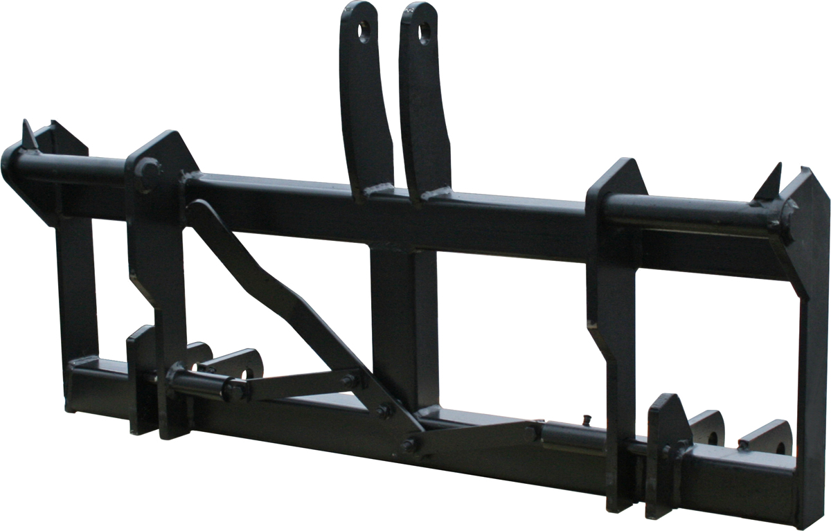

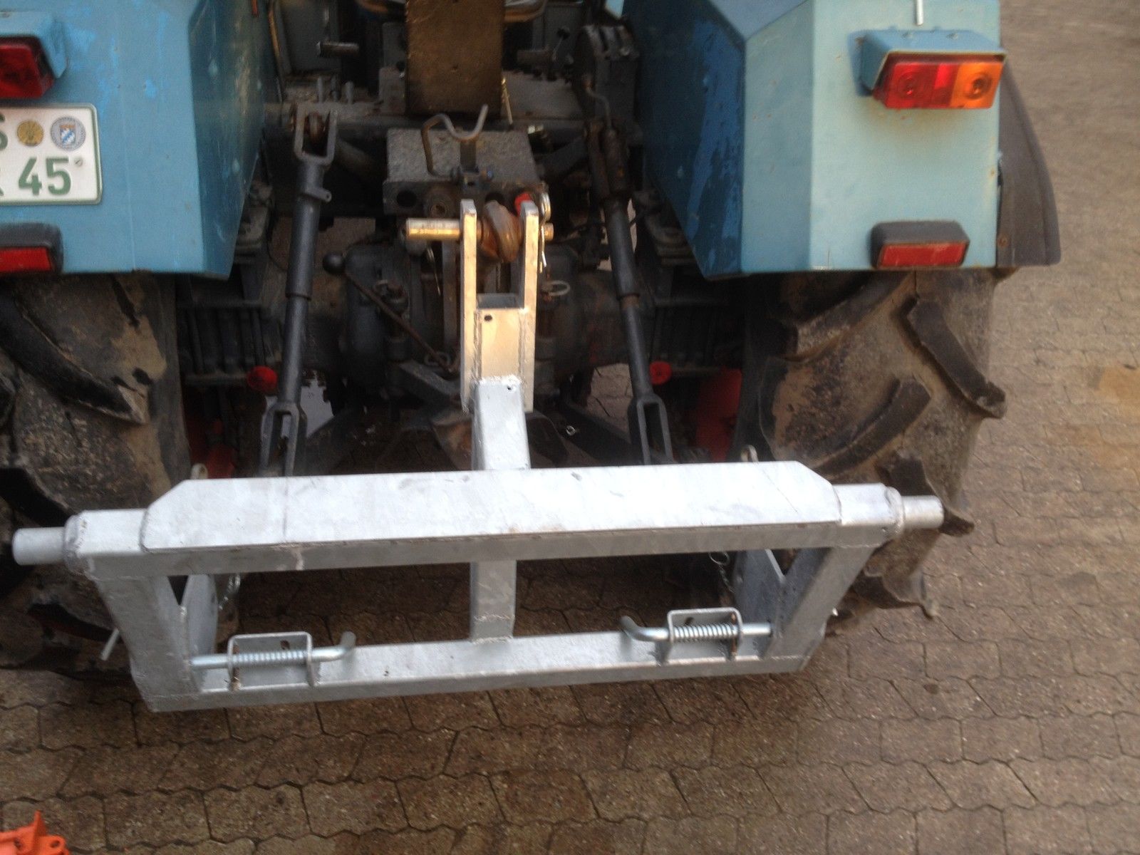

Sorry I may of explained that poorly. I have a tine fork which goes on my loader via euro hitch. I want to build a 3 pl one side euro hitch on the other to hook my loaders fork or bucket or silage bale grab to the 3 pl wi th out any welding on the front end loader attachments.
Mainly for fun buy so that I could carry a hay bale on the rear and dig a hole with the bucket on the front.

Adapter_Norje_Smidesfabrik_Trepunkt_Euro_013967.jpgIn my corner of the world you can buy them so cheap that it does not pay to make them yourself

Buying an adapter to put a SSQA interface on the 3pt costs more than 3pt or SSQA pallet forks. Pushing a grand or so, crazy expensive to buy or build. I was looking at making one, but never got to it. Ended up finding a 3pt forklift mast with forks in need a little TLC for $200. That ended my quest for a rear adapter.
I welded a used quick hitch to a SSQA plate for the loader. Cost me $100 or so ($300-400 if you get parts new). Love being able to pick up 3pt implements on the loader. Makes moving, loading, maintenance & general handling a breeze. Its also the mount & float hinge for my converted truck snow plow.
